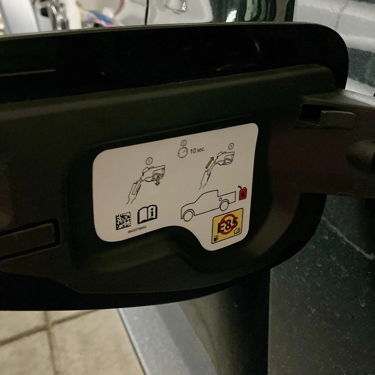

I’m sure the tune compensated for the fuel mix, but just to confirm what others are saying here is a photo.
Can't compensate for chemical composition. Rubber and aluminum degrade and corrode quickly with ethanol so most flex fuel systems use different materials. E85 in these trucks will lead to issues down the road like clogged injectors and damaged fuel pumps.

it would be interesting to find out the specs of the components, but lately most manufacturers have been making things Ethanol safe since most fuels hav an ethanol content already in the 10% range.
I suspect the no E85 sign has more to do with the fact that the computer cant adjust for it and without tuning for it, you’d be running way too lean.
That might be possible... I guess we'd need a Jeep engineer to say for sure but typically if you're going to make the investment to ensure all your parts are enthanol-friendly, you might as well go the full nine and do an E85 tune so you can get the emissions credit (assuming it's still a thing).
