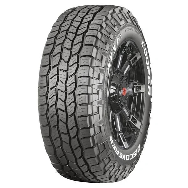

My coworker listened to me about weight so he traded his rubicon 17s for overland 18s and went with the cooper AT3 XLT in LT285/75/18 (34.5 on the Jeep) at 59lbs and he’s getting 19.9 hand calculated in mixed driving.
Incredibly quiet tire with a 60k warranty, looks great and fantastic aired down off-road (for an AT)
Incredibly quiet tire with a 60k warranty and fantastic aired down off-road (for an AT)
Have the Coopers on my Ram and will be putting them on my JL. Great tires.
