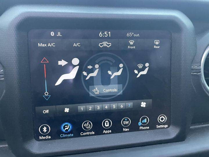

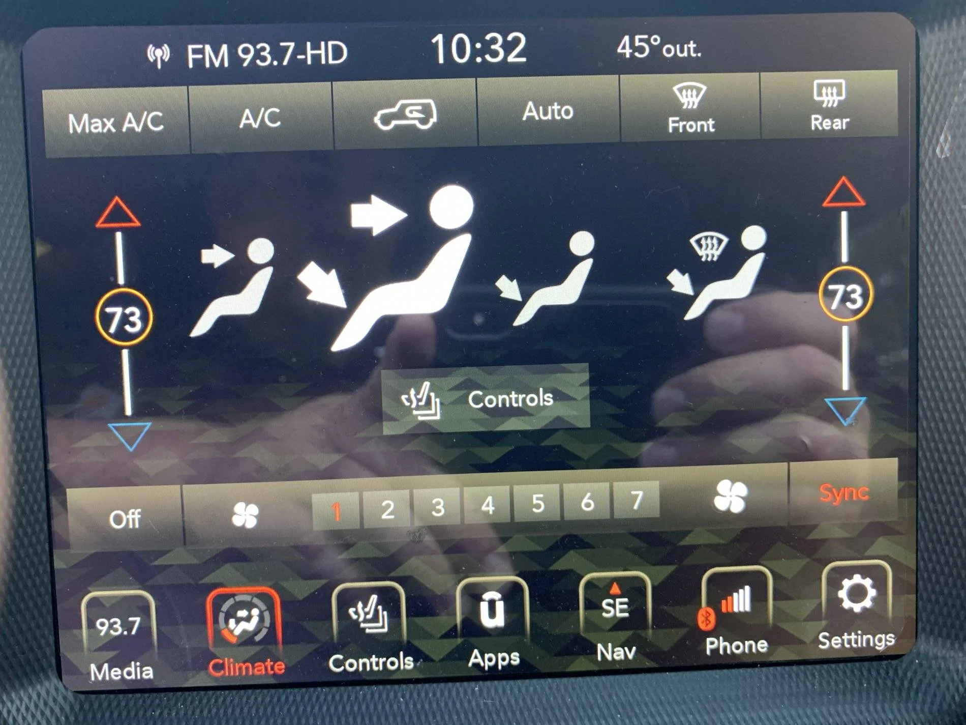

I disabled the TPMS and Tire Size with my JSCAN and lost all of my HVAC controls. I tried to program it with the doors off and didn't realize opening and closing the driver's door was part of the process, I'm guessing this is what caused the issue. I put the doors back on and tried to revert the changes, reset the ECU, etc. but nothing worked. I finally gave up and did a restore to factory settings, now I have everything working except for the ability to change the temp. It is stuck on full hot. Also, I noticed the climate controls look different now. It almost seems like it installed the software for non dual climate controls. The top pic is what it looks like now and the bottom is what it used to look like. Any ideas?

This may be irrelevant, but the 'recirculate' button on the two screens are different. One shows JK the other JL... no idea if that is critical or if it indicates an incorrect 'load' of the software...
