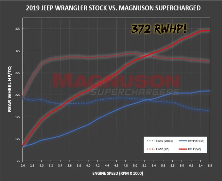

Jeep Gladiator Magnuson TVS1900 Kit Available Now Jeep JL JT TVS1900 Kit 1

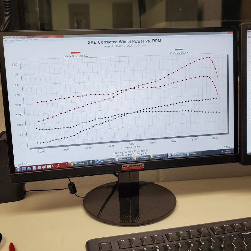

You can clearly see the difference here. Look at the starting RPM for both dyno graphs. Start at 4250 rpm on the Magnuson dyno and compare that with Hamburgs. Magnusons dyno starts at 2600 rpm and Hamburgs starts at 4250 rpm. The hybrid roots design creates more power everywhere. The numbers dont lie.
Actally number can and do lie. You can dyno at 5 different places and get 5 different numbers which is why we do engine hp like the factory does. You have load bearing dynos, Different temperatures can lie, Tire size, 1 ton axles or not, gears, etc. 50lb wheels vs 150lb wheels can all lie.
