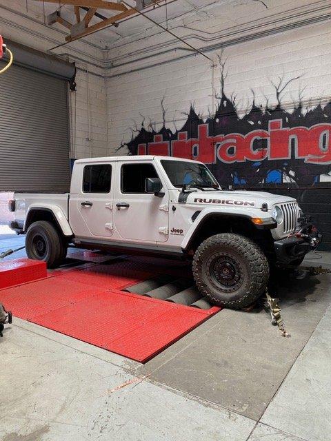

Vivid Racing in Phoenix. Baseline dyno done: 210rwhp.
I saw Vivid's video of your install and the performance improvements which really amped my enthusiasm. Exciting stuff and I'm very tempted to drive up from Tucson and have them upgrade my JT.
Since it has been a few months can you give us a followup? Do you have any suggestions for those of us considering it and are you happy with the supercharger/service?
