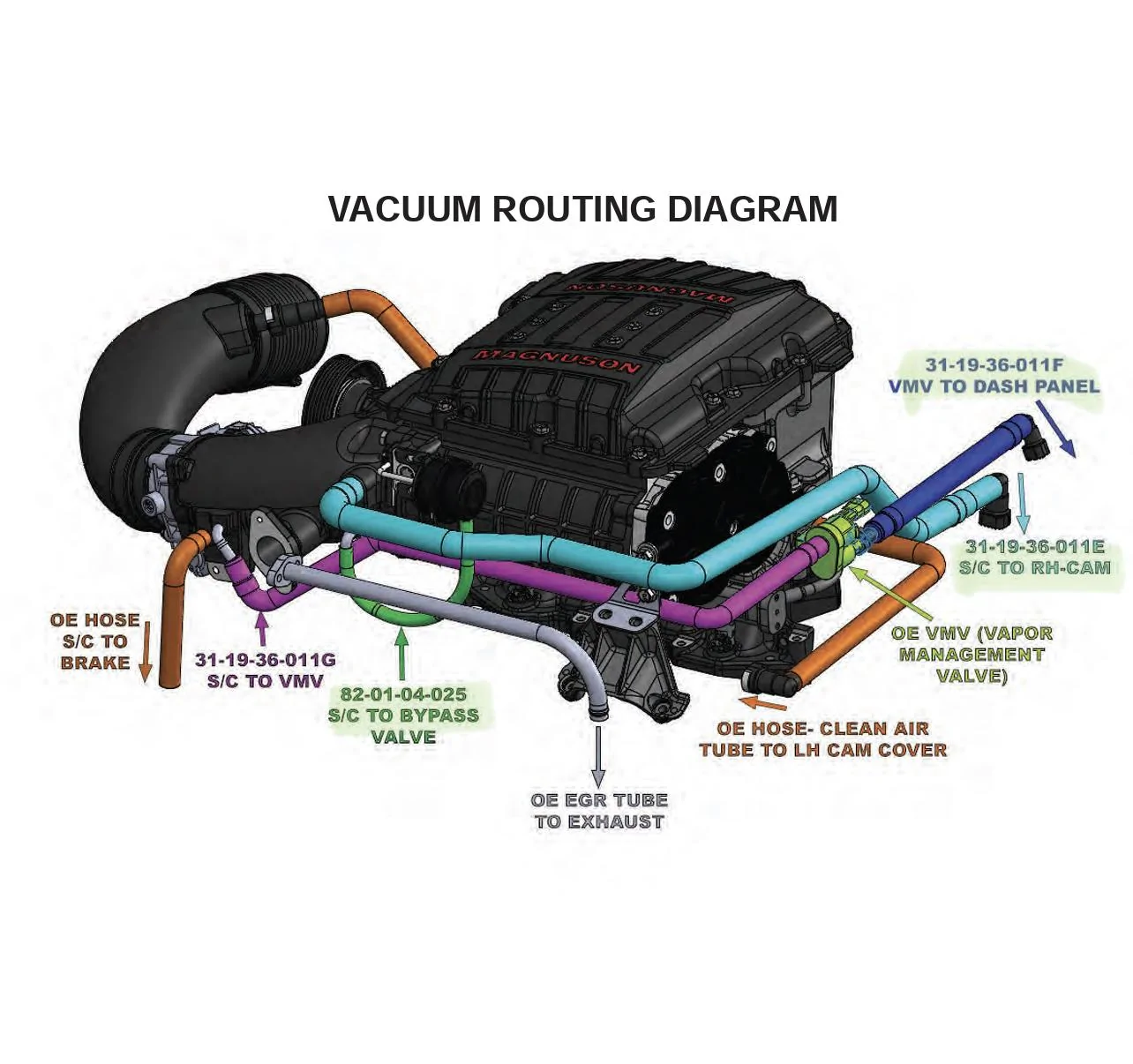

The used kit I bought came in. I set it all out and found the hoses missing below highlighted green. Do you think I could rebuild these with some hose and 90 degree connectors?
I found the S/C to Bypass Valve (it was actually already in place)
After looking at the parts closer the "VMV to Dash Panel" would be easy to recreate as it is just a straight shot.
The "S/C to RH-Cam" above However has several bends. I believe this is likely a 1/2" hose based on the outlet of the SC. Can someone confirm? Does anyone know the purpose of the line? Are there 45 degree adn 90 degree connectors that can be purchased that would work best for this or is there a better way to try this?

One line is the fresh air intake for your crank case vent system. The other is the fresh air vent for the charcoal canister. You might be able to canibilize your stock stuff and make something that srals well.
