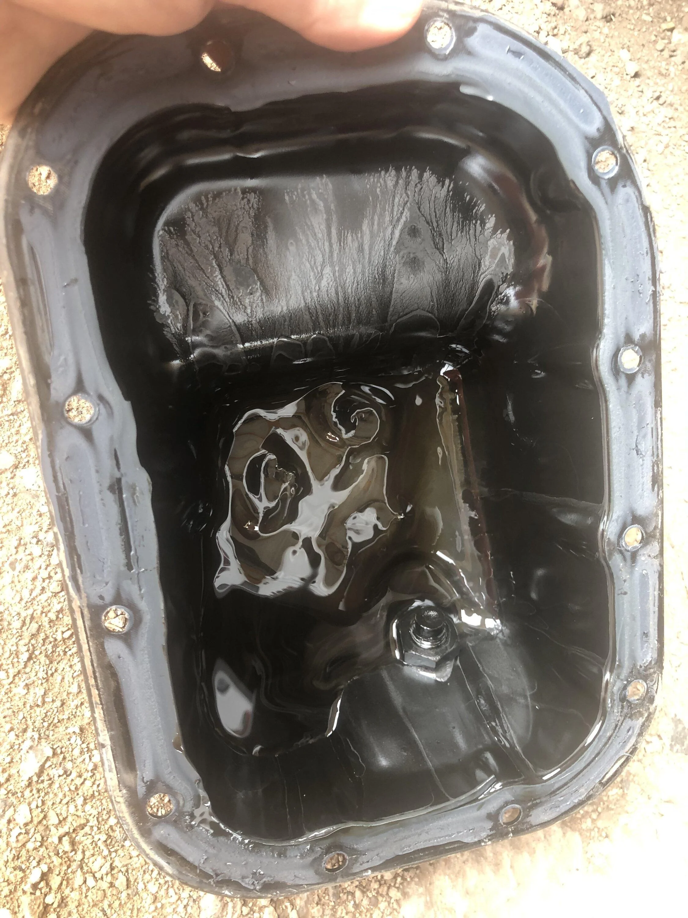

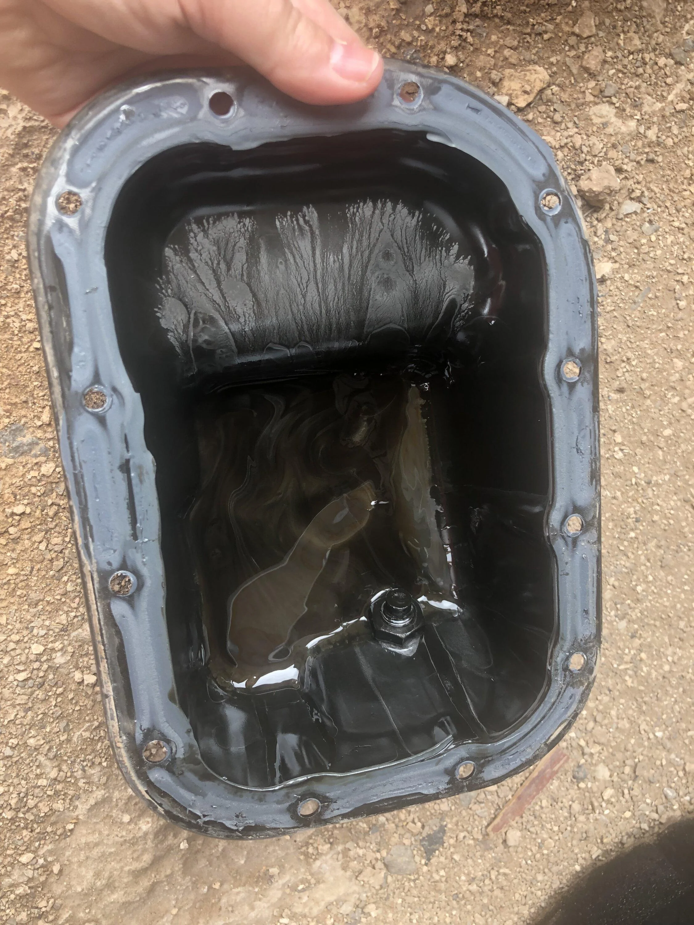

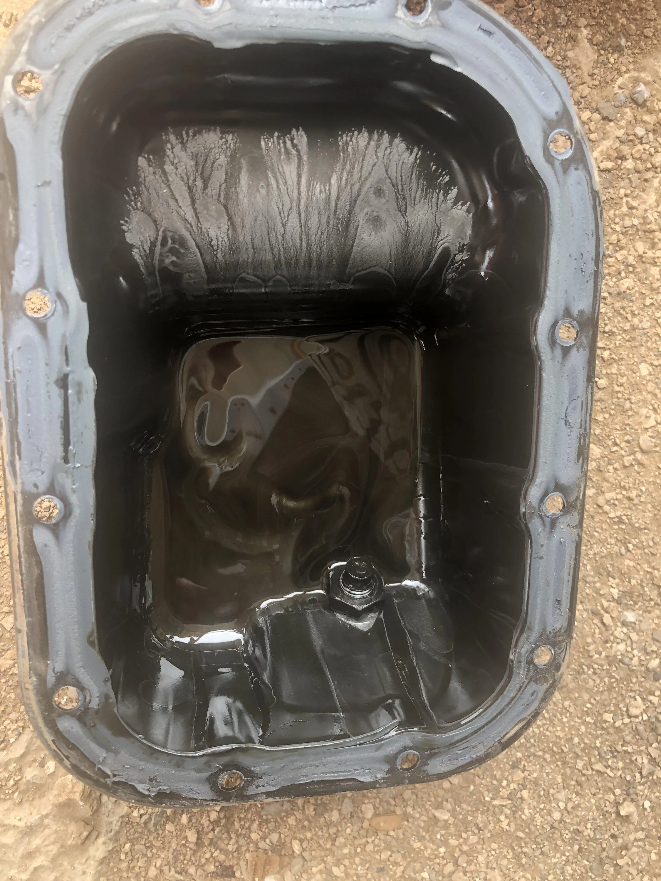

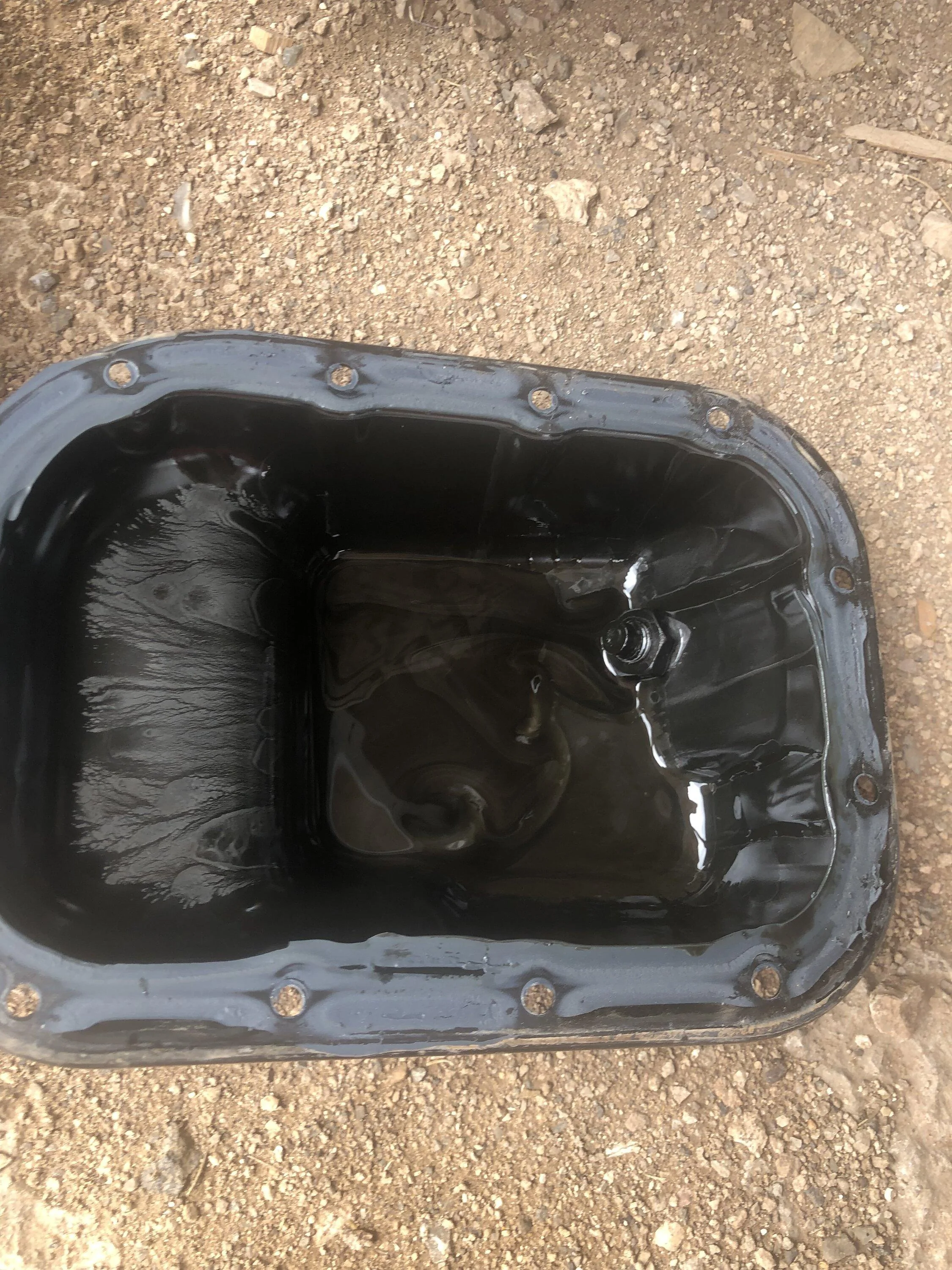

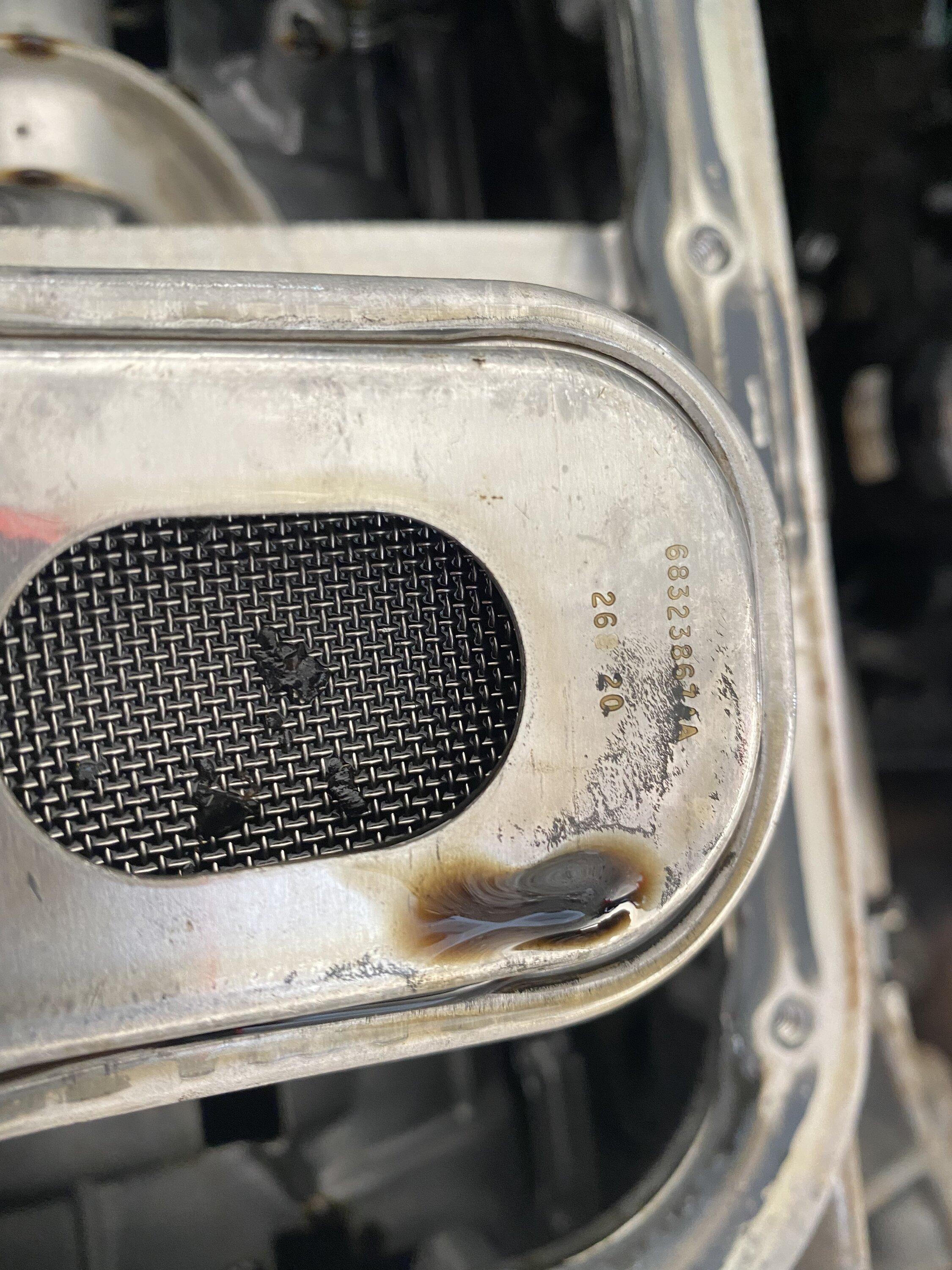

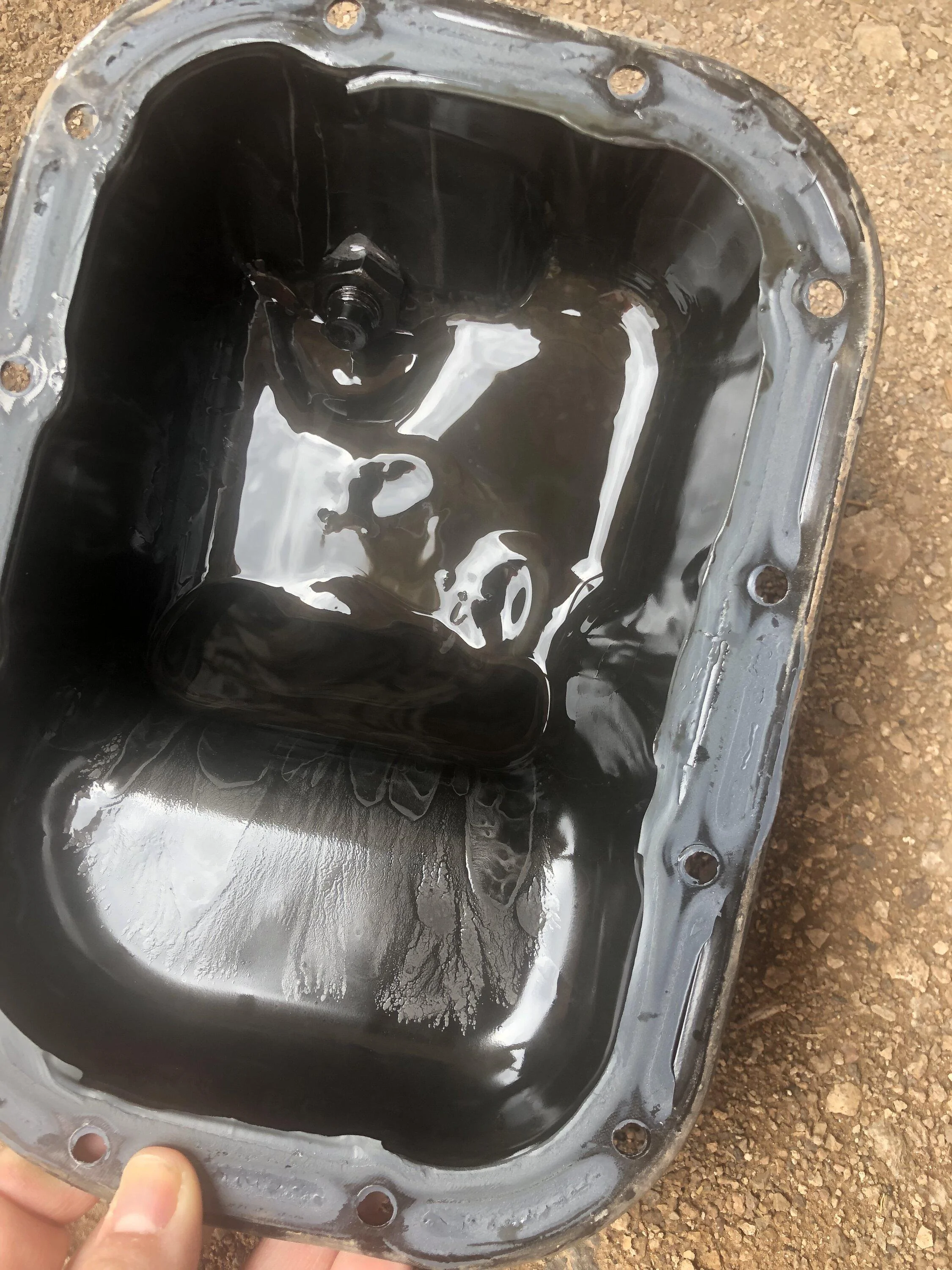

Mine did…. Wiped rod bearings. All 4 cams, all lash adjuster, all cam followers, all phasers, all VVL solenoids replaced. My issue is a combination of a ridiculous amount of blowby (thanks CAFE for the low tension rings) and shitty assembly in Mexico (Saltillo Plant). My engine has been full of Three Bond from the upper and lower oil pan since Day 1. The Magnuson DID NOT cause my engine to knock….horrible QC did. No warranty of course. “Heavily Modified” is what the flag on my VIN says.

If I am.picking up what you are laying down, I don't think forged internals would of saved this failure.
I am just hypothesizing, but my guess, is you had adhesive in a couple places, it could of even been what prompted the cam failures by clogging the VVL solenoids. When the cams started to go, they launched a bunch of metal through the engine. At that point if you had adhesive and cam filings, it would not be a far stretch to imagine rod bearing oil feed getting clogged. I have been concerned mine will end up like this. I have been changing the oil every 2k.
