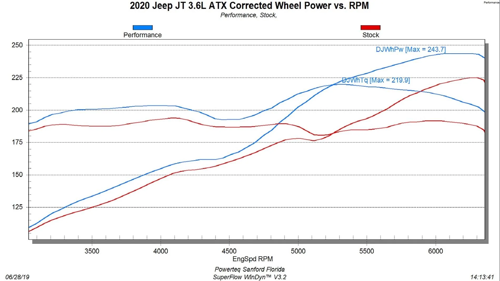

Last Dyno run at Powerteq....(Automatic transmission)....
Jeep Gladiator Manual transmission ratings Fred_Rewey
bmount
May 30, 2019
TX
2024 Mojave
Last Dyno run at Powerteq....(Manual transmission)....
What is the Performance vs. Stock? Is that from a chip/recalibration?
