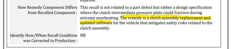

The updated recall documentation states that part of the remedy is a new clutch
RCLRPT-23V116-8530.PDF (nhtsa.gov)
Jeep Gladiator Manual Transmission Recall 19A 1689859484424
I wouldn't expect the feel to change much. I've only seen one report on the post-recall JLs that makes me believe that the clutch probably feels the same.
