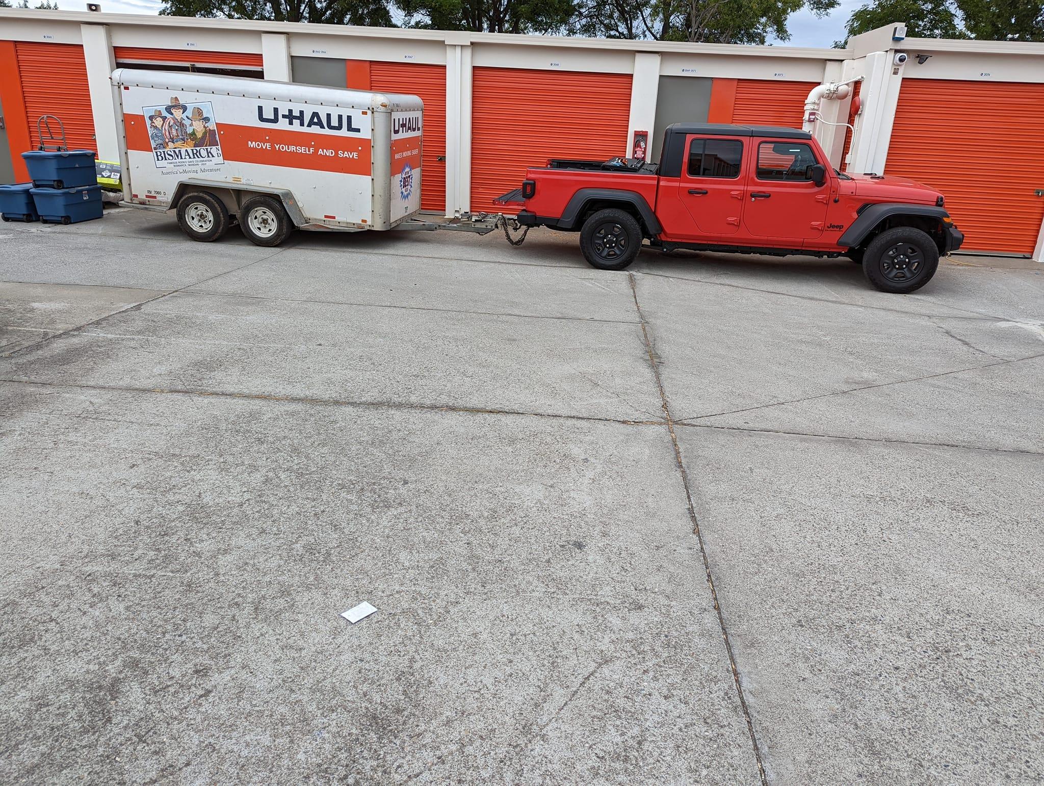

Max tow tows. Towed this trailer at about 4000 lbs gross weight (lots of heavy books at the front of the trailer) with my Sport Max Tow without a problem other than the fact that it accelerated rather slowly pulling that amount of weight behind it. For occasional towing the Gladiator Max Tow is fine. If I was pulling a trailer heavier than 4,000 lbs on a regular basis I'd probably get a truck with a more powerful engine because the Pentastar ain't it.
Odd, my Overland tows 5,000 pounds without issue..........
Not for springs - they have the wider axles, lower gear ratio, heavier weight rating. You can swap springs around all day, and it won't make one tow any better - might reduce sag from the tongue weight, but won't impact towing otherwise.
Mighty flat land you're driving across there. Now take it over Donner Summit on I-80 between Sacramento and Reno. You'll have trouble maintaining 45mph with the pedal flat against the floorboard.
That said, I'd have no problem pulling that rig with my Max Tow *occasionally*. If I was pulling 5000+ lbs on a regular basis, like several times a week, I'd get something with more engine -- the Pentastar just isn't all that when it comes to torque. Though it did darn good on fuel economy -- I got 15mpg towing that 4K lb trailer at a steady 60mph on mostly flat terrain. The transmission was mostly flickering between 6th and 7th when there were slight hills, and sticking on 7th on the flat. But I didn't try to take it over Donner Summit. That would have been... not so much fun.
Exactly. When I describe my 3300lb trailer, it works well on steep mountain grades at between 8000 and 12000 feet of elevation. In the Midwest less than 1000 feet above sea level, driving through corn fields, I wouldn’t hesitate to tow larger things. I think a trailer should be appropriately sized for the worse end of the driving conditions. 5000 lbs of trailer behind a gladiator in high winds, steep grades, or both, just isn’t realistic.
Have you ever been here?
Obviously not. Not if you call it flat. In my neighborhood, there's roads I take that are 3, 4, even 5% grades. OTR drivers have trouble maintaining speed on parts of I80 east of Newton.
Granted, we don't have mountains, but I have driven mountains and towed with my F250 in mountains - and frankly, this truck would out-pull that 351 any day.
In fact, this does a better job than my LS equipped full-size Silverado did.
So what if you have the engine wound up - that's what these are made for. Too many freak out if they have to drive 1/4 mile at 4,000 rpm. No big deal.
Since these have been tested, and rated, for 6,000 pounds towing - using nasty courses and inclines. I have no hesitation with this. I'm towing 1,000 under the rated towing capacity, and the rating was achieved by passing testing like this -
I would say that it is realistic, but not fun. Your engine is wound all the way out, your gas mileage is crap, and you're going 45mph up those grades. We used to tow like that back in the late 1970's when the available engines were so choked by smog equipment that a 400 cu. in. engine had less horsepower than today's Pentastar, but that was then, and this is now. We have more powerful engines available to us now if we want to tow like that.
