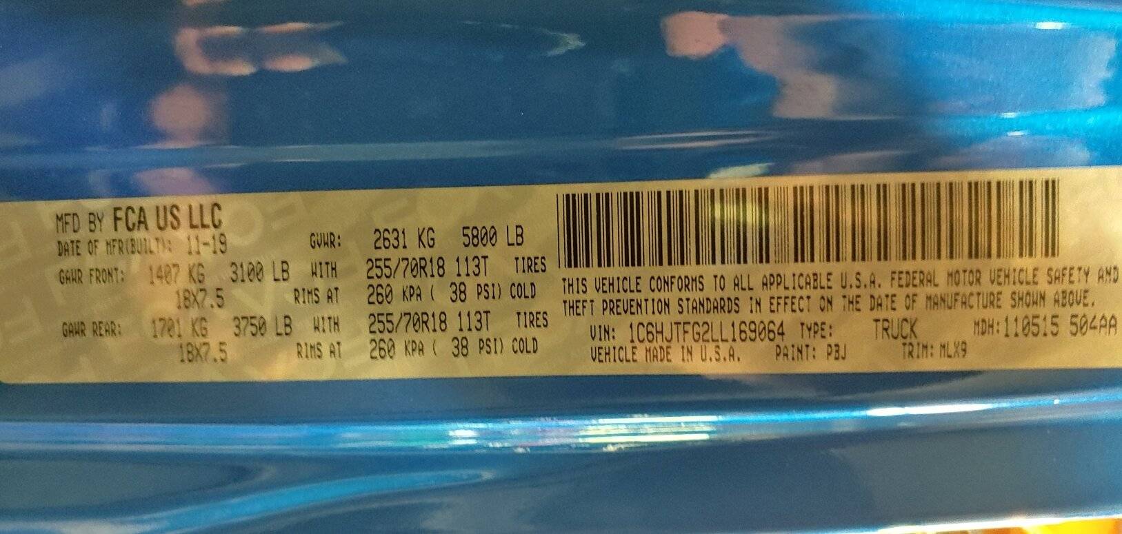

I did look at that but it only gives GWVR and axel ratings, I was hoping for GCWR, but that’s too much to ask
249
40,587
54,248
Cargo rating? Sorry, no. The best you can get is on the tire information decal which shows load information. But that's "best case, UNMODIFIED vehicle".
That's because if you weigh 300 pounds, and put power steps on and a winch, you have to take that as payload. You subtract the current weight of the vehicle from the GVWR (Gross Vehicle Weight Rating) and that's how much you have left to haul.

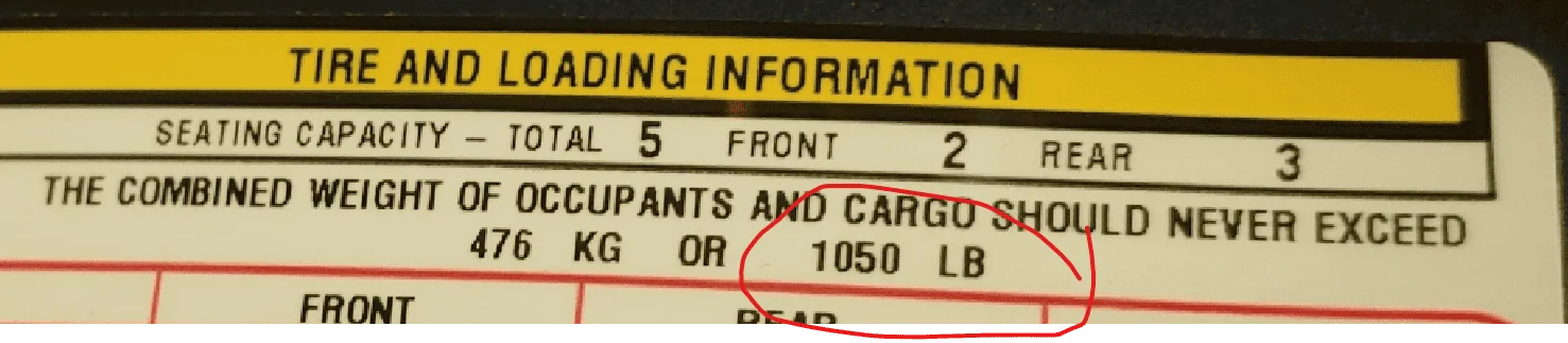

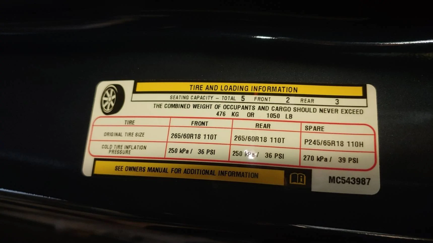

There is actually a sticker that DOES tell you FACTORY payload rating, for YOUR truck.
Payload is you, a friend, a dog, air compressor and/or tools, winch, trailer tongue weight, cooler and beer and so on -
Look at your TIRE AND LOADING INFORMATION sticker. It says very very plainly, can't get any more clear than this -
Jeep Gladiator Max Tow Package 20220714_180449
But remember, that GVWR is GOD.
If you add to the weight of the truck with rails, bumpers, winches, air compressor, tow straps, or the tongue of a trailer - that number goes DOWN because anything you put in or on that truck after it's built takes AWAY from payload.
If you tow and the tongue weight of your trailer is 600 pounds, THAT is payload and comes right off the top of the payload number
Again - no one looks at the stickers?
So the most useful bit is the GVWR which is the GROSS VEHICLE WEIGHT RATING.
(and you and your dog are cargo)

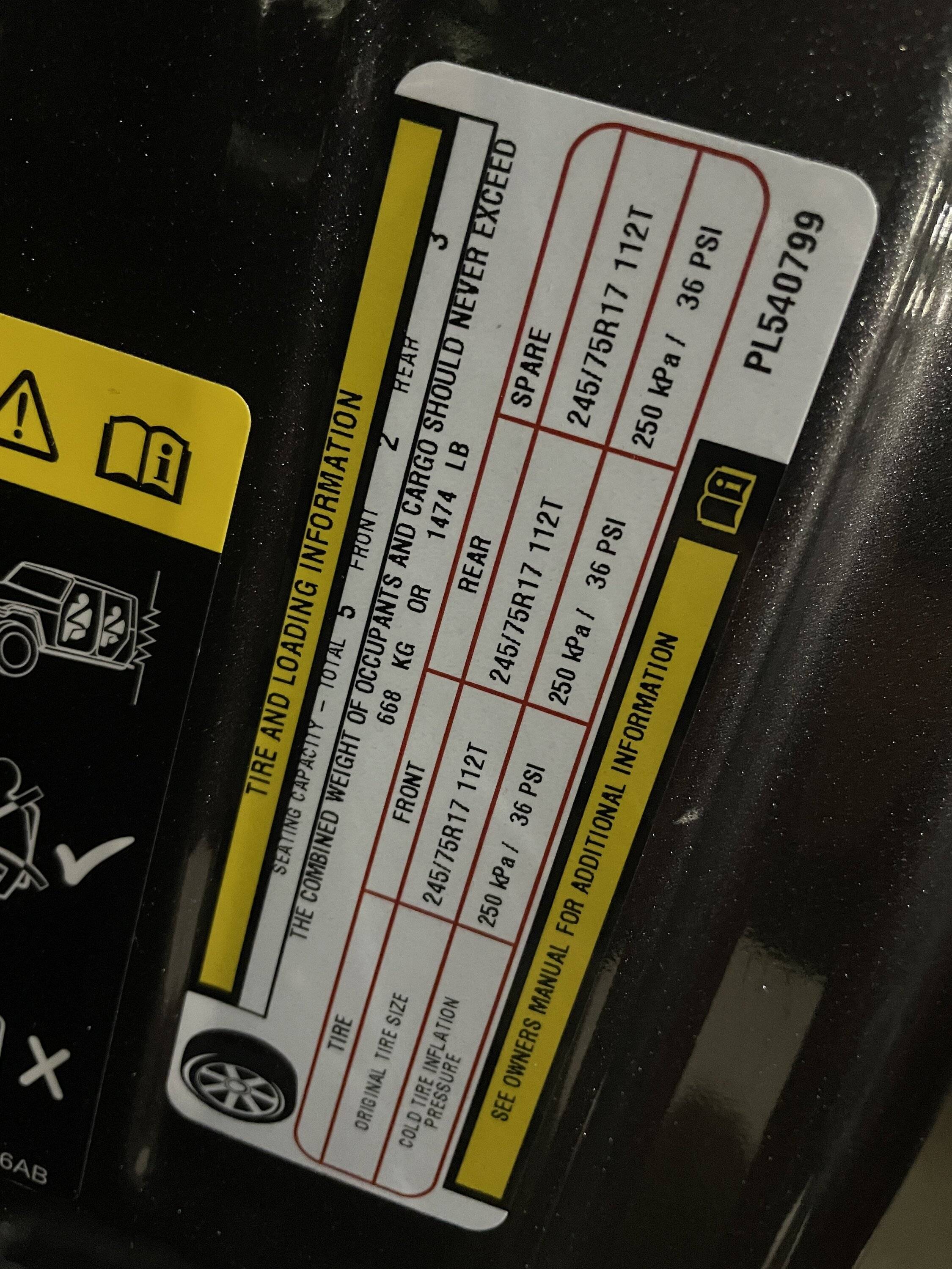

In my earlier post for door stickers, I could have been a bit more clear; if your weight allowance jamb sticker lists a combined allowed weight in the 1500-1600 lbs range, that would indicate you have the higher capacity suspension of the max tow package. If you look at ShadowsPapa's sticker above, you see his is at 1050 lbs which is considerably less (indicating non-max tow).
joybulb
Ryan
Apr 13, 2023
IL
right, all good points, thanks for the insight. I did notice his cargo capacity being about 424 lbs below mine.
