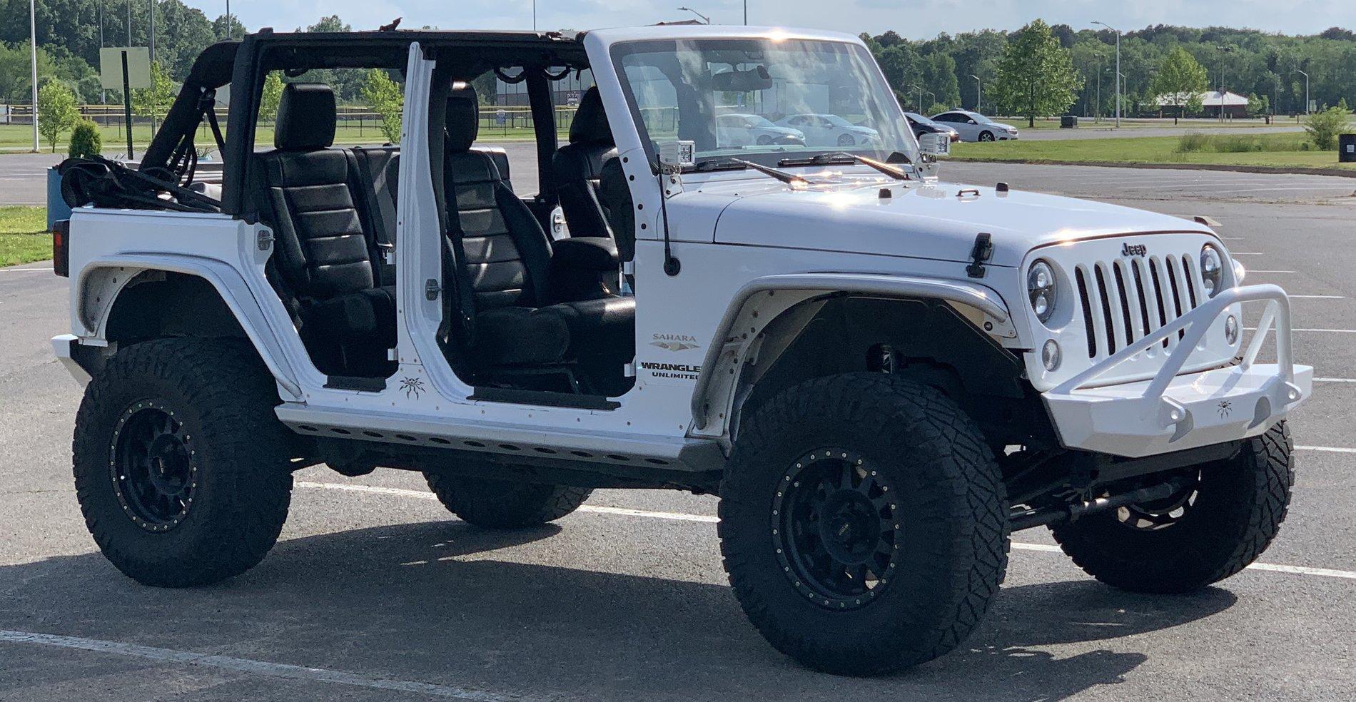

Starting to think companies like AEV are saying their kit won’t work is just them stepping up to the plate. having to modify a loft to work goes against all of the testing and design that goes into a lit, safety being one of them. I am not against modifying a Jeep and have been down that road before. I just don’t think there is a proper loft released yet since these haven’t been around too long.
As you can see my precious Jeep was heavily modified. I am not against modifying a Jeep.

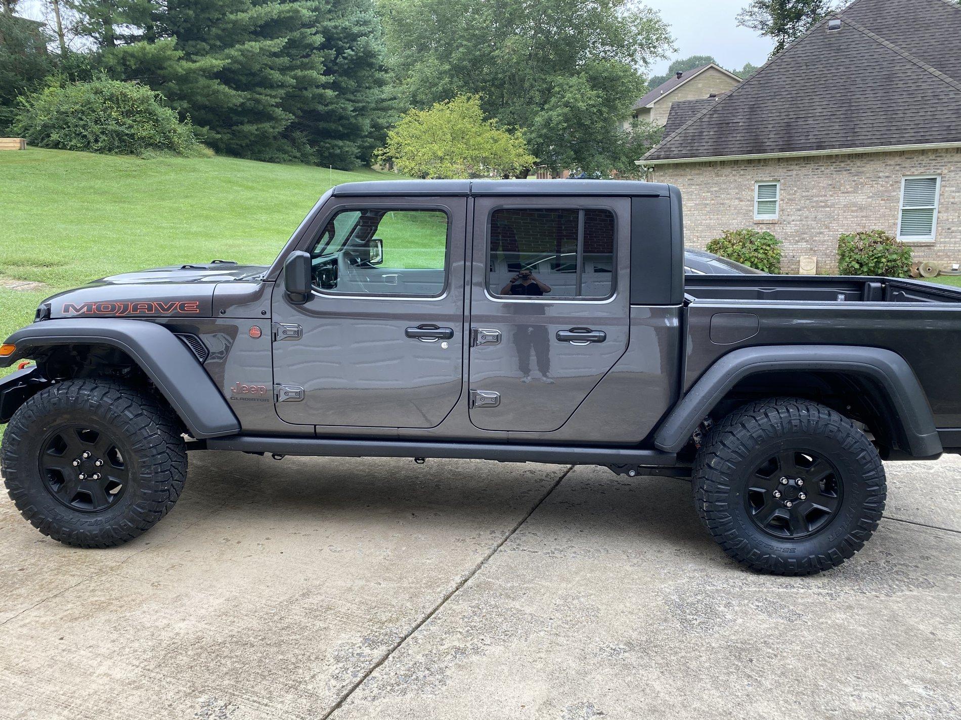

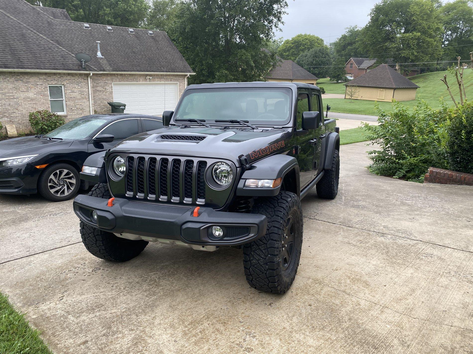

Could you have someone turn/hold the steering wheel full-lock and snap some pics of how close the tire gets to the inner fender / suspension, on the leading edge and rear edge of the tire?
I wouldn't mind keeping the factory Mojave +37 offset if there is plenty of room remaining.
Thanks
Here’s 35” no lift.
Jeep Gladiator Mojave Lift Options B9BAA57A-793F-4259-86B6-D7F4790FFE16
CMac
Sep 2, 2019
633
1,198
Ashburn, VA
Jeep JT, Toyota Highlander, HD FLHRC and FLSTSCI
Professional Aviator
Here’s 35” no lift.
That's nice-looking, right there....wouldnt change a damn thing.
And if ya need more clearance, throw some tube fenders on it....still retain stock ride, suspension parts.
