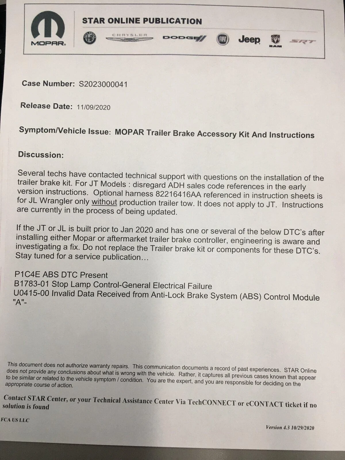

Anyone with issues had the opportunity to try a different unit to see if it's the truck or the controller? Or had the chance to install their broken controller on another truck to see if still broken?
Did you not read the STAR communication that was posted and I reposted?
Also please read other messages going back a ways.
We've covered all of that ground - and we found a PATTERN - TRUCK BUILD DATES.
It's not the controller itself, it's the truck build so something about the TRUCK changed.
Won't do a lick of good swapping trailer brake controllers as the trouble follows the truck.
I have two or three other members' info to add to this but you can see the very clear pattern, and the Jeep/Star communication confirms what I've found here - it's the build dates of the truck.

40,500
54,020
read most of it but there wasn't a lot of clarity with the back and forth and multiple threads so thanks for this summary post. Should prob pin it to top of thread. build date is annoying since mines a 2019 build date....I have some ECU updates due so will have dealer flash first before doing the install to be up-to-date on that at least
I agree, I wish there was a central place to put documents like TSBs, communications like the one from Star and so on.
I went in for my wave oil change and tire rotation and they did the PCM flash they said I was due for - it sure as heck changed how my truck shifts and winds up between shifts and such - but no difference other than engine and transmission changes.
They say the difference is "January 2020" and newer builds work, while older than January 2020 have the issue. I wish it was narrowed down as January is quite a few days - so is the change January 1, January 30, January 15th at 1 pm?
Apparently they don't have enough data to know - OR, simply haven't seen a need to be specific. Gotta be frustrating to those dealers working with a January 2020 built truck.

Update from my case: The dealer installed the brake controller in my 2020 JTR and told me that the infamous part (sales code ADH) was needed for it to work. While everyone else installing it themselves bypassed that step. As expected when I hooked it to my trailer, everything worked perfectly. So the ADH sales code part is only for some of the older wrangler models like many have pointed out. Wanted to throw this out there if someone was wondering. Looks and working great btw.
40,500
54,020
I REALLY WISH anyone with this controller or considering this controller would take this document to their dealership and not mess around with them trying to figure out what they should KNOW selling these trucks - there is NO ADH sales code for JT!
If you are going to buy a controller through a dealer or have a dealer INSTALL it, please grab a copy of this image, print it and show it to your shop people. Obviously they aren't aware of it.
