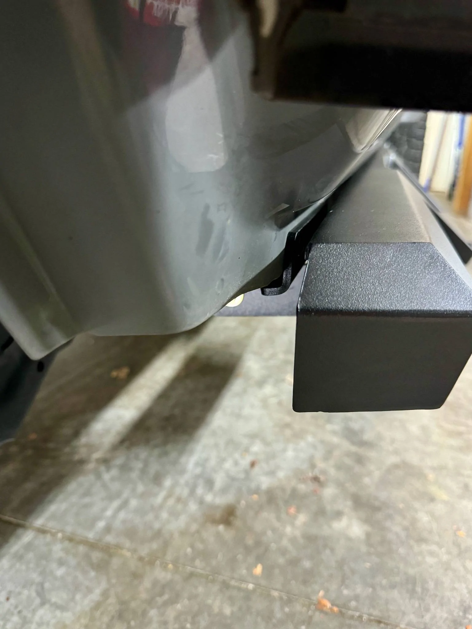

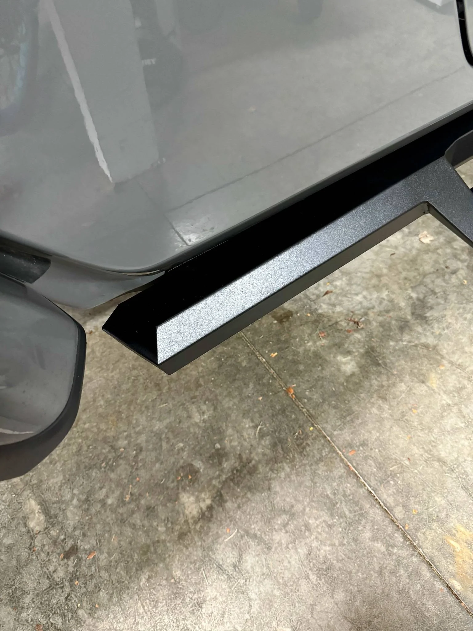

They are straight bars, but there is no gap in the front and a very small gap in the rear. I was able to push it in pretty tight in the rear so you really don’t notice the slight gap. I’ll shoot a close up photo today and post it.

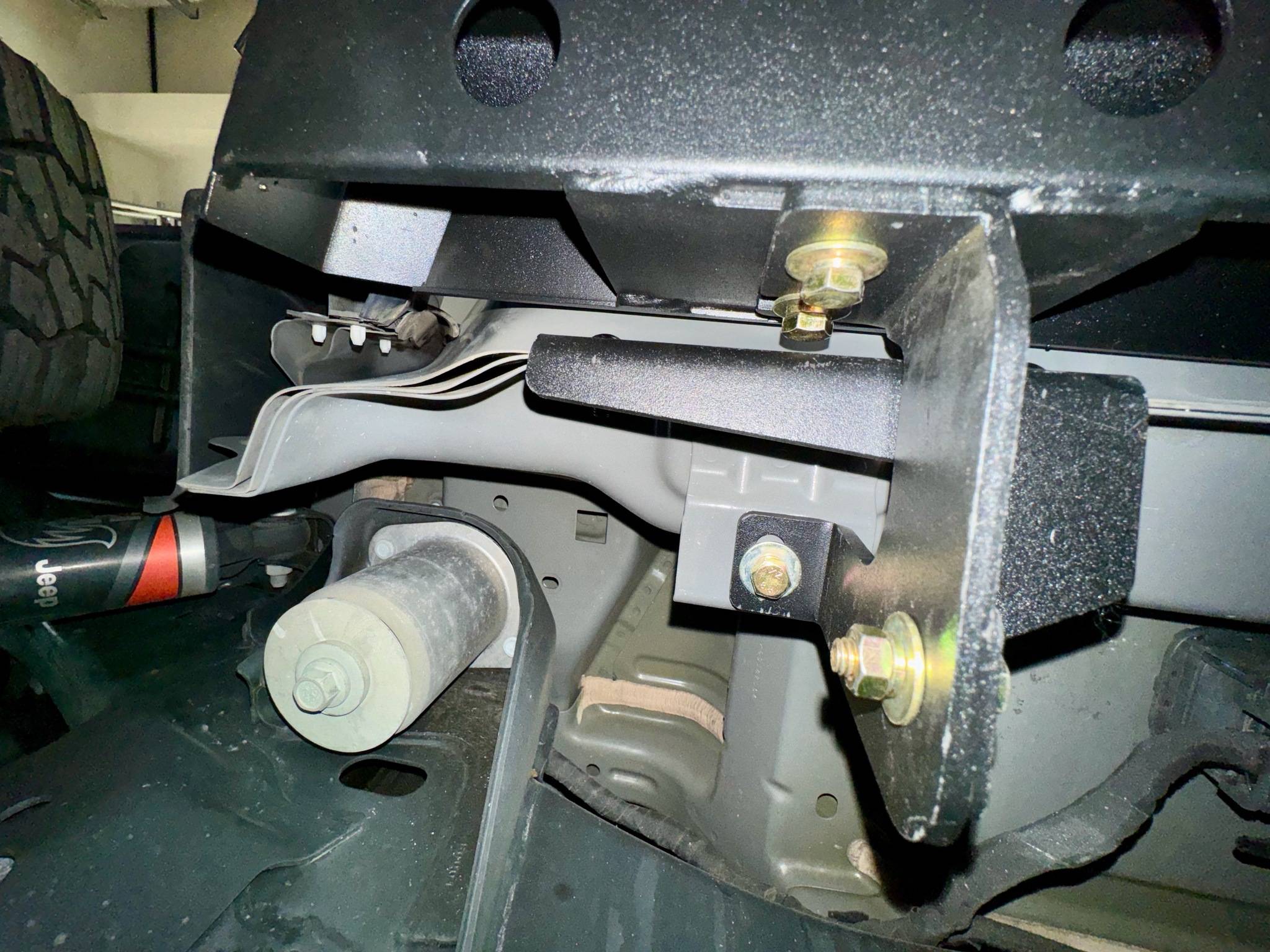

Here's the photos. From the underside you can see there's an oblong notch where the rear bolt attaches to the frame. I was able to push the bar in about 1/4" and tighten the bolt to reduce the amount of gap. I think it looks fine.

Those look fine to me too, very nicely done!

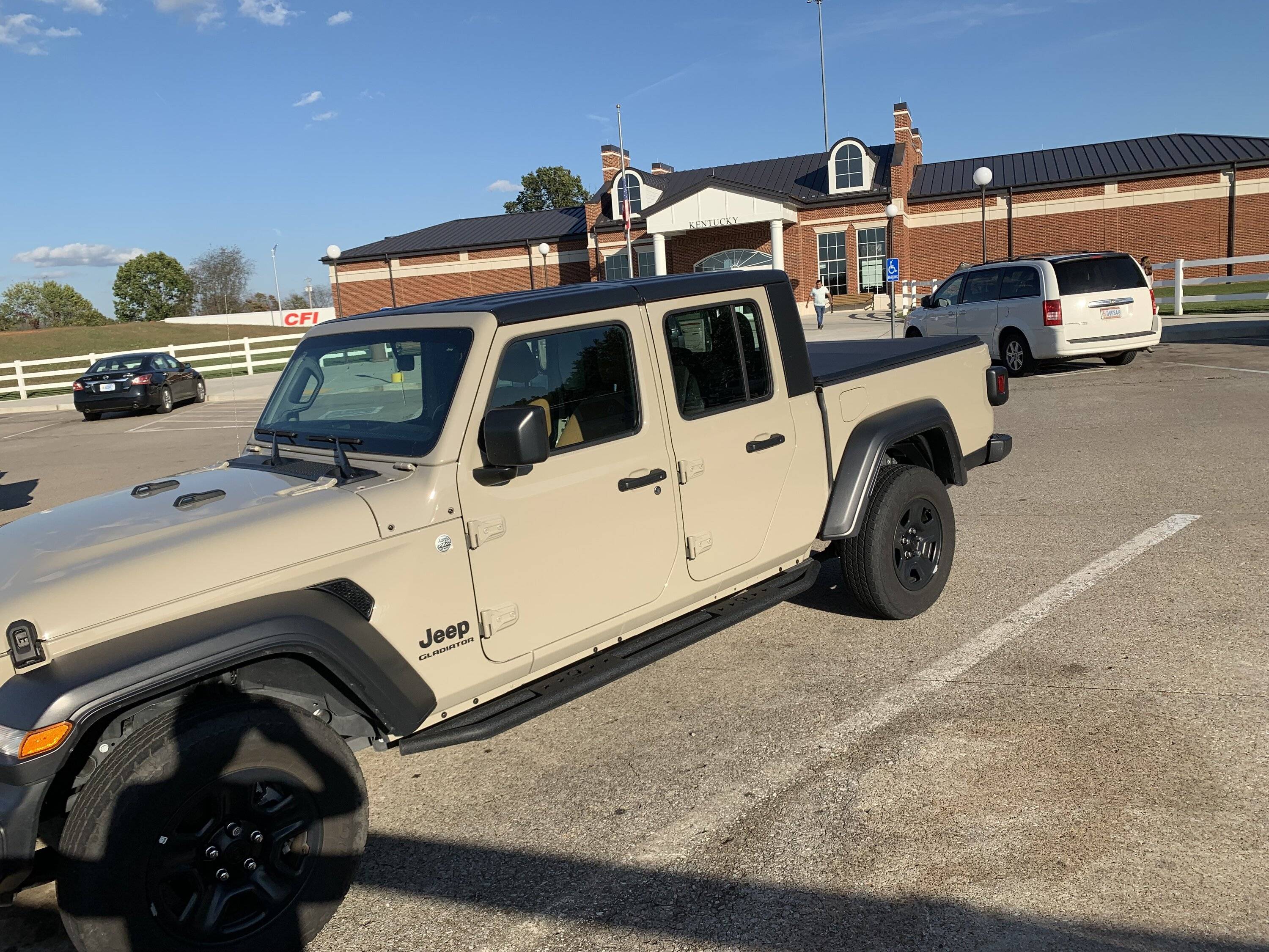

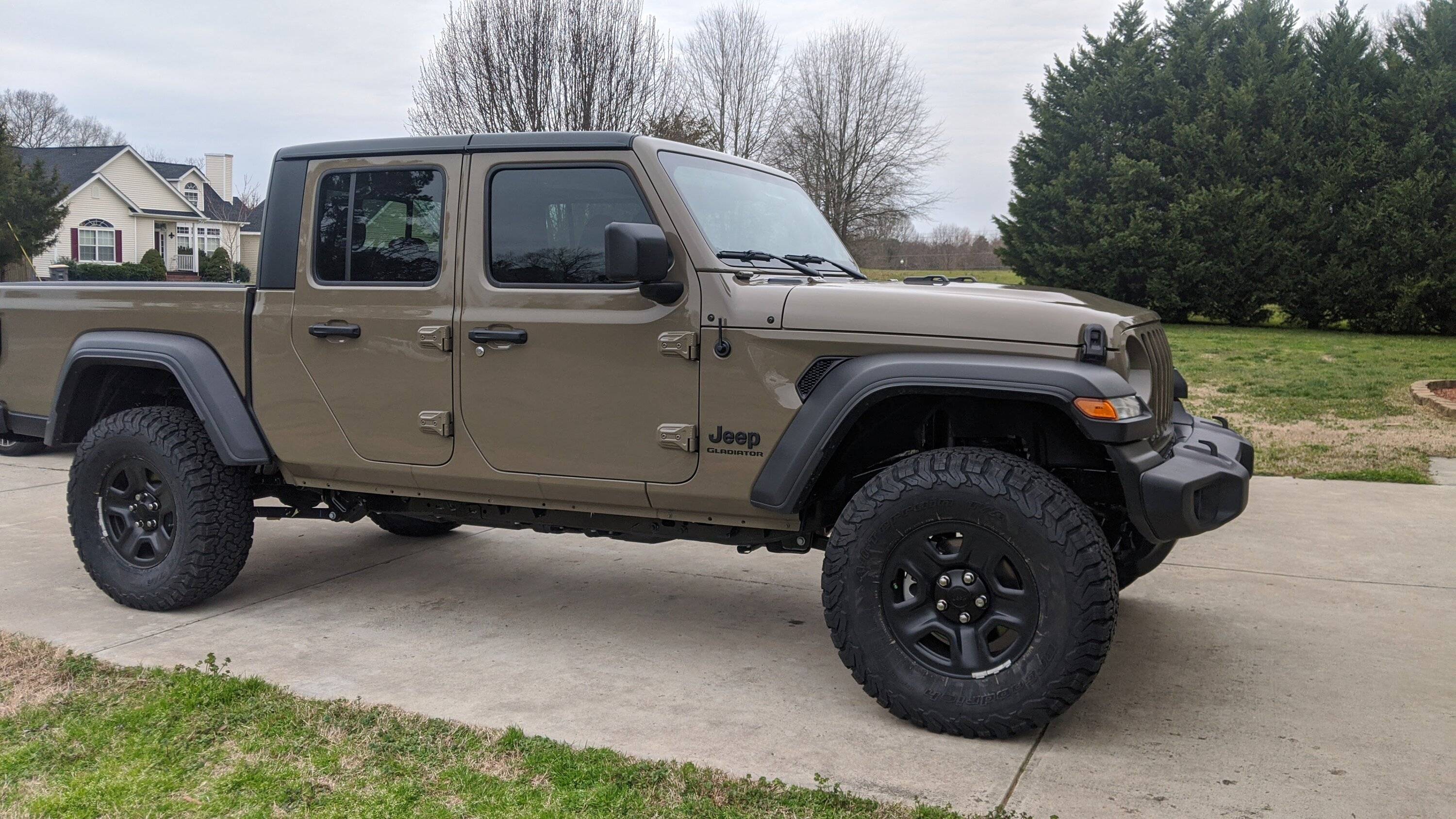

Nope, basic sport has no steps or rails. Mine 2 days after I got it

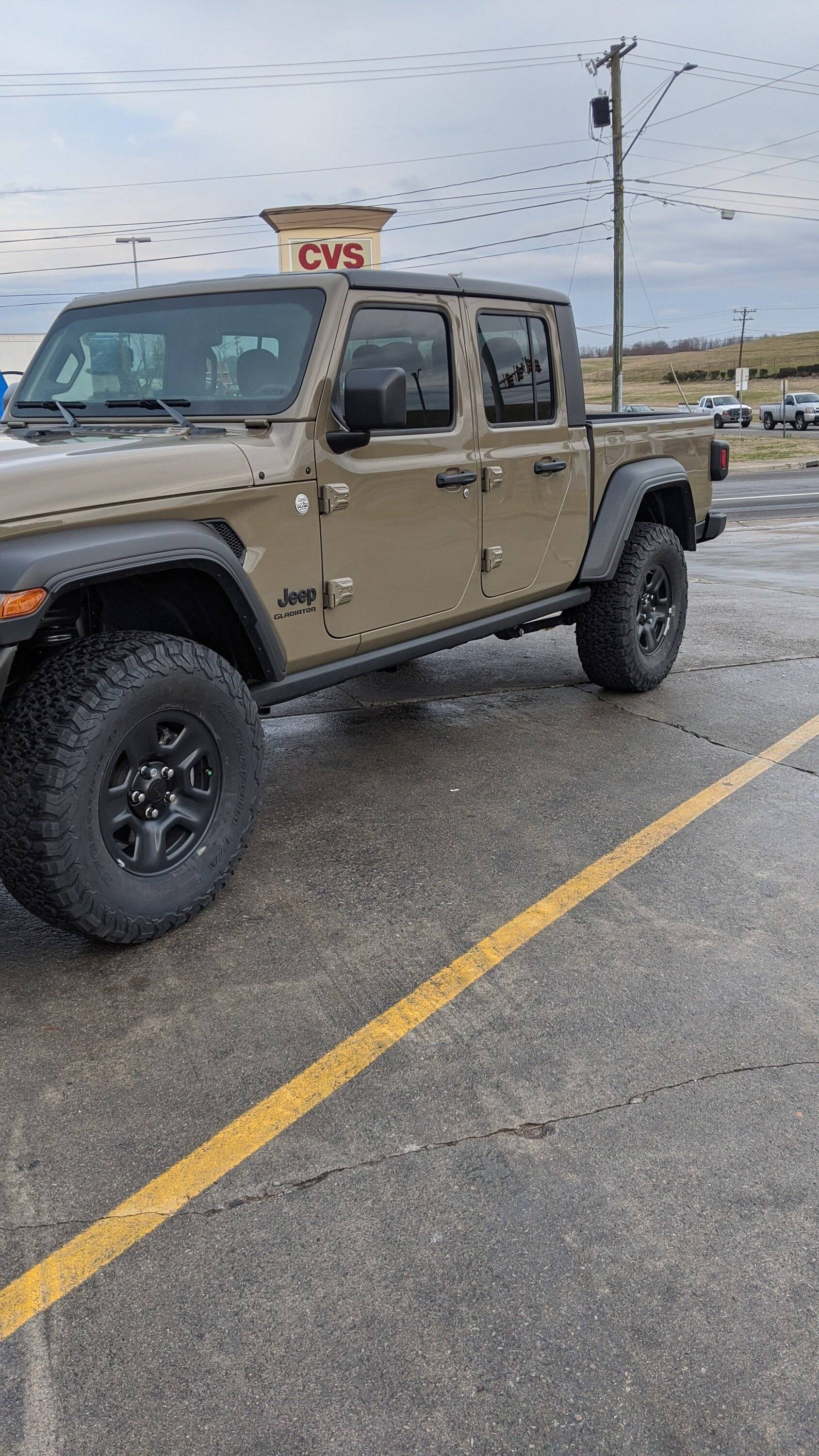

Mine 5 days after I got it. Got these Rubi rails for $125 off marketplace

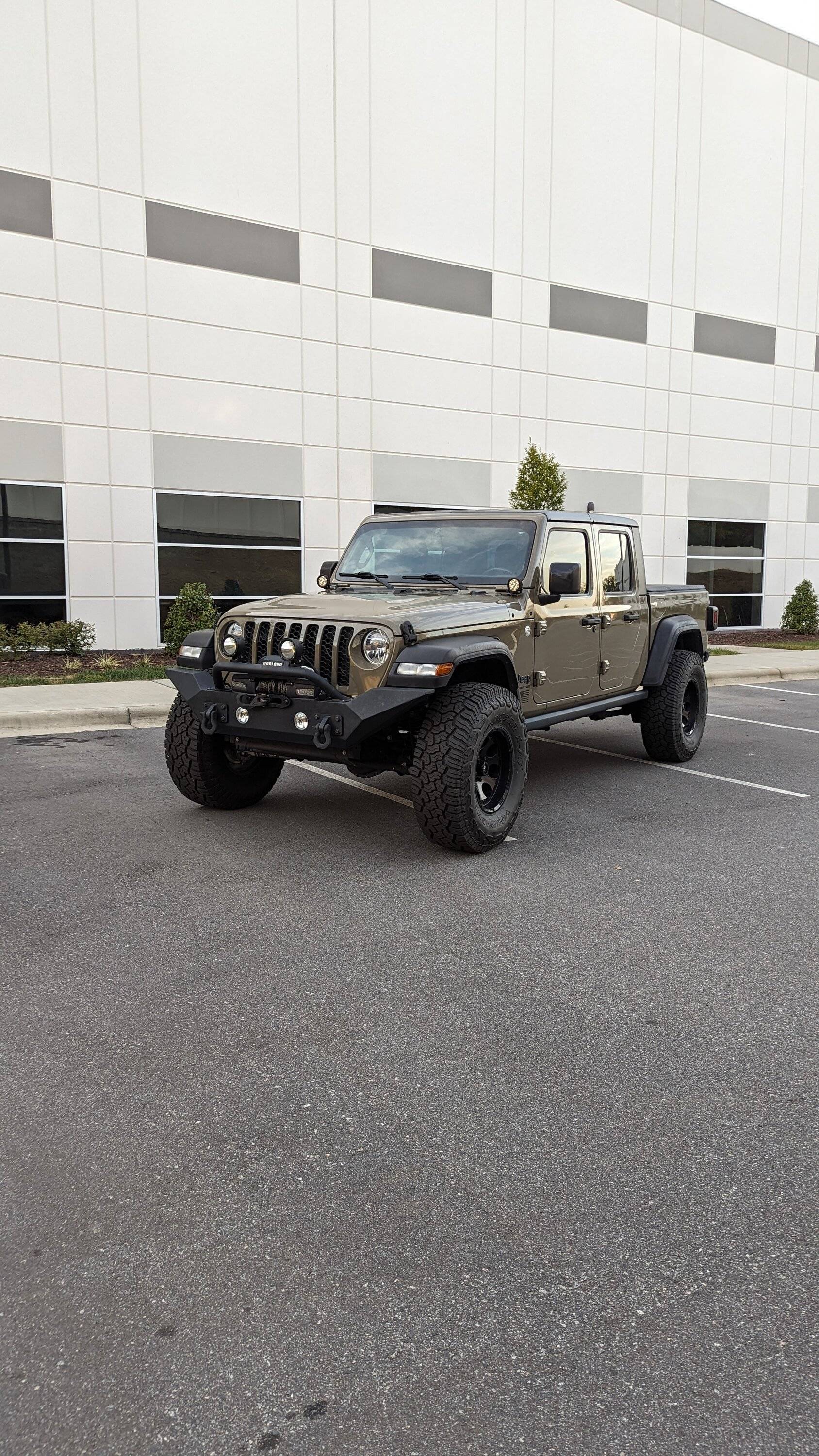

Mine now 3-1/2 years later just because I want to post a picture of it
I actually like the steelies on that color. Do t see those wheels ever on gladiators
That's why I held on to them after I bought the fuel wheels. They may end up back on the jeep one day. I got to good a deal on the fuel wheels to pass them up though.

So, nothing in your photos shows an attachment to the frame of the truck. The bracket in the last photo (the one I left) shows the bracket is attached to the torque box of the body and to the pinch weld.

That's where they attach.

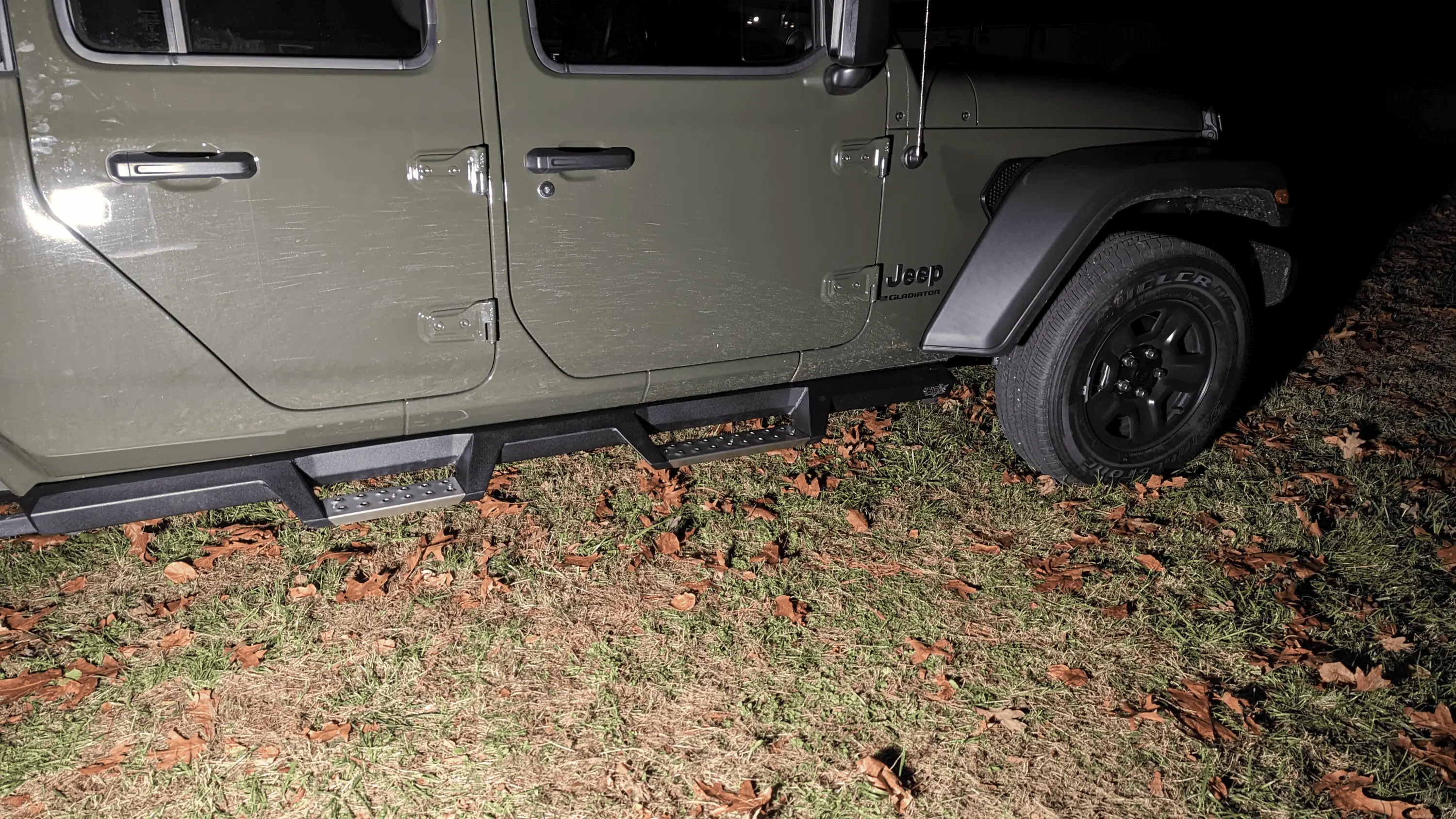

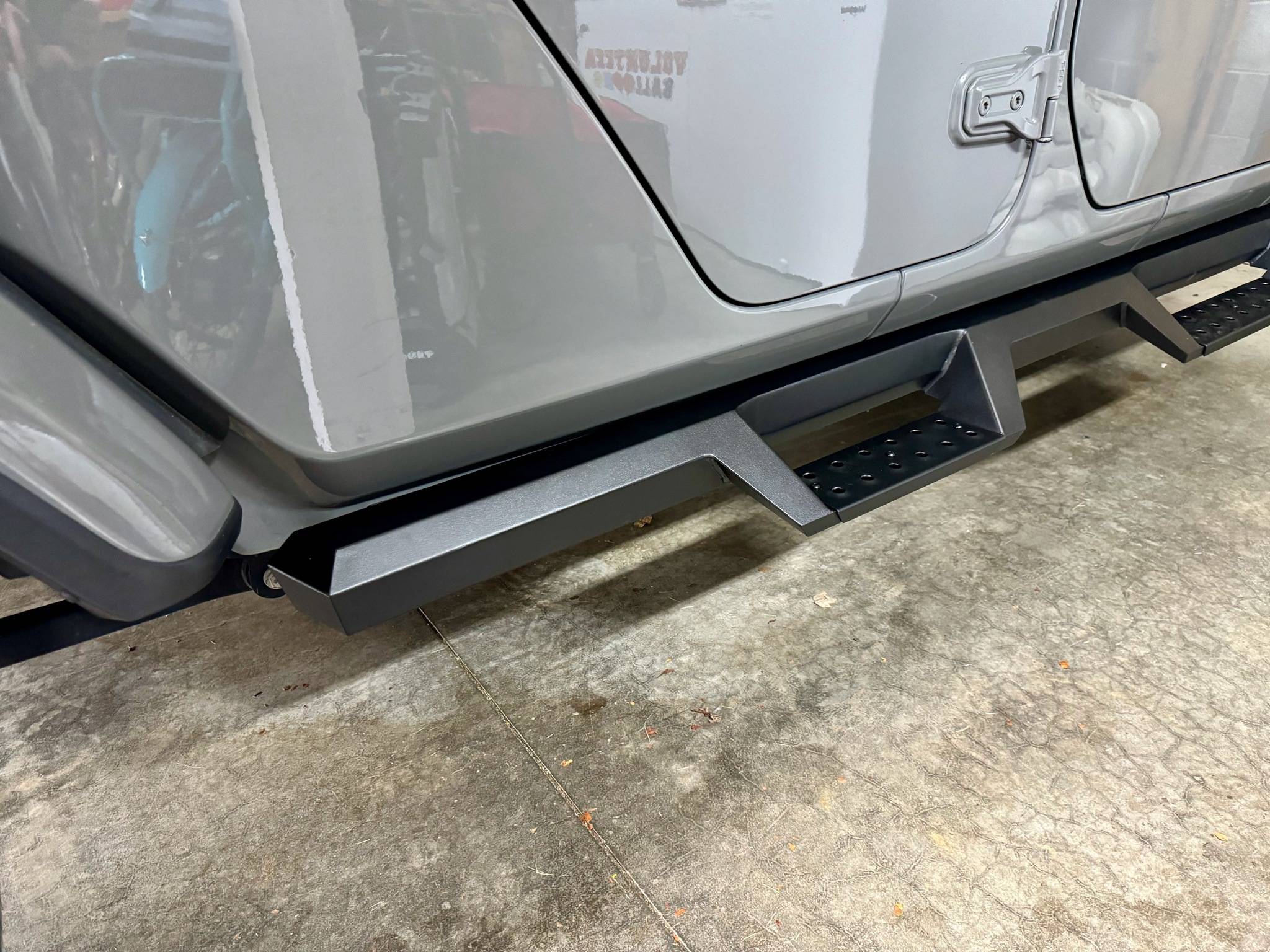

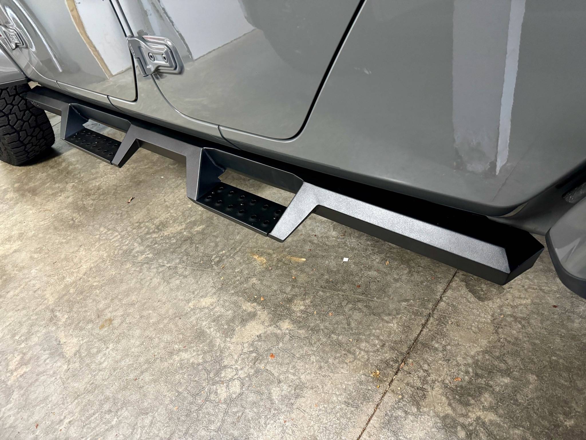

Westin HDX stainless drop nerf bars:
Got home from the cabin this afternoon to find a long heavy box on my porch, so naturally I had to put them on. Took about 3 hours working solo, some of that was figuring out the installation instructions which had several glaring errors and omissions, so after installing the support brackets per the drawing, I had to remove them and install them correctly. They're somewhat lighter duty than I expected, but I understand that they're steps, not rock rails. They're not tubes as I expected but open on the back side; crud will accumulate but being stainless they shouldn't rust out. The carriage bolts holding the support brackets to the pinch rail could have been larger, and getting the wrench on the upper bolts holding the rails to the brackets is a bit tricky.
It was dark by the time I finished the first one; I debated leaving the second one for tomorrow, but once I had it figured out the second one only took about 45 minutes or so. But they're on, and my vertically challenged wife is happy. :)
