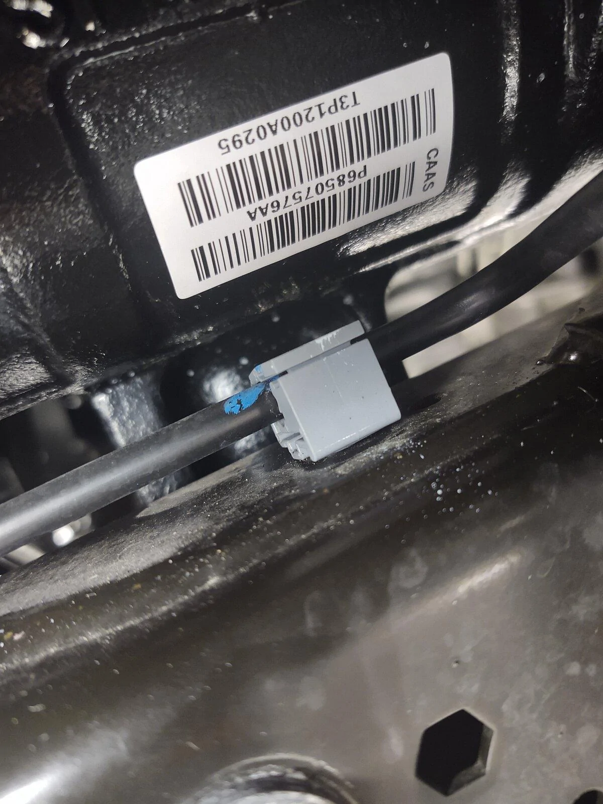

Finally got mine back yesterday after waiting three weeks and having to end up taking it to another dealership to get the parts. Steering is vastly improved and as it should have been from the start. If I hadn't called around to other dealerships to find the part, I would still be waiting.

Jeep Gladiator New JT Gladiator Steering Issue TSB 08-074-20 (for "Improved Steering Feel") IMG_20201110_124444309
Got mine installed yesterday. Went from about 20mm of play in the steering wheel down to 1 or 2mm. Plus I think the software update changed the amount of power steering assist. Seems a little stiffer. Has better feed back.
40,501
54,021
Interesting - I noticed no difference in the PS assist or "feedback", only less wander, not drastic change but yes, better.
Had no real play in mine so obviously I wasn't going to see a night and day difference.
But the feel - the assist, that sort of thing - no change. It does feel like it wants to return to center better. I might be trying to compare to my wife's Grand Cherokee with rack and pinion - that's FAST, quick, tight steering. You don't dare move that wheel or you are turning.
