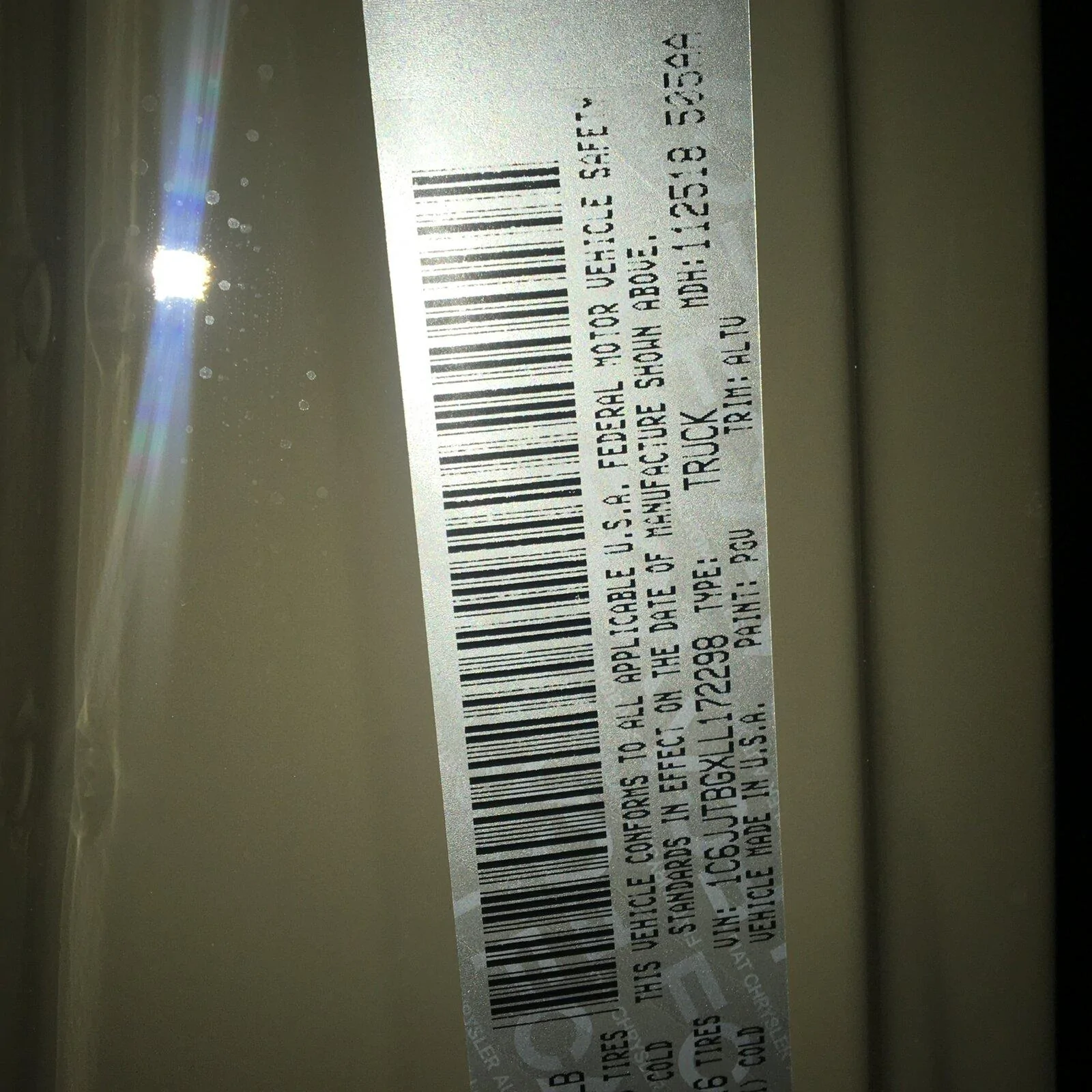

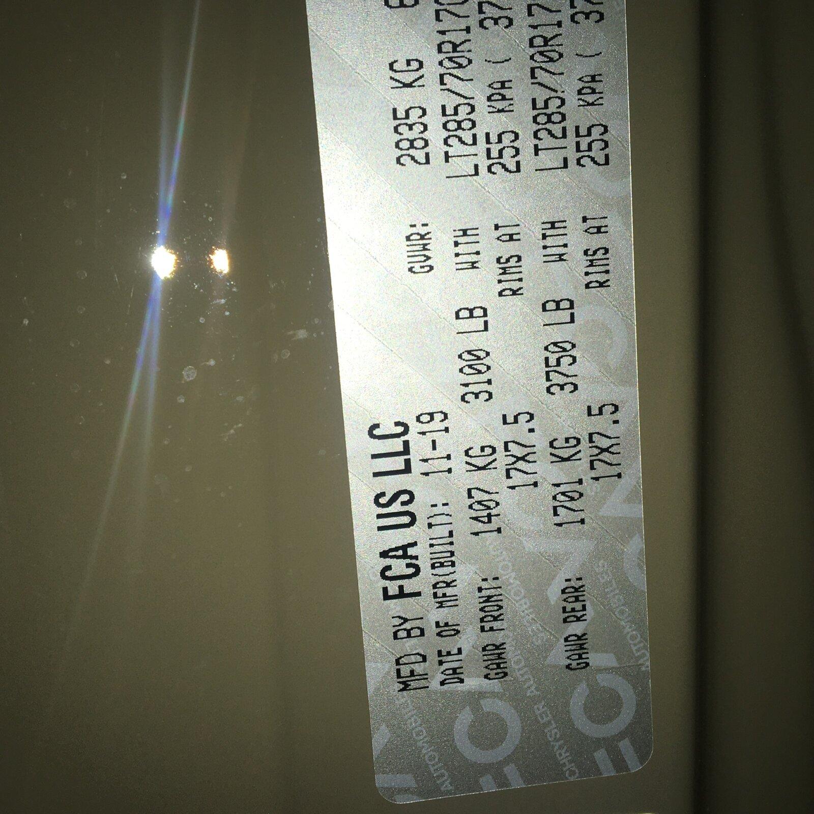

There is a build date on your door jamb sticker: Date of Mfr (built): MM-YY,
as well as the build day and hour: MDH: MMDDHH
I don't see how it's relevant. I have a 2021 that was built with the updated black steering box. Unless they came out with a newer version of the updated black steering box.
40,504
54,031
Right - because as of sometime on the day of August 14th, 2020, all new Gladiators built got the steering gear mentioned in the TSB.
Now if there's a NEWER version, it will have a revised number, not the exact same part number as in the TSB listed in this forum. It would have an AB instead of AA, for example........
And if that's the case, it could be seen easily by looking at the part number on the steering gear of the latest JT off the line, the latest one owned by a forum member.....
They could look at the part number and that would tell us pronto.
