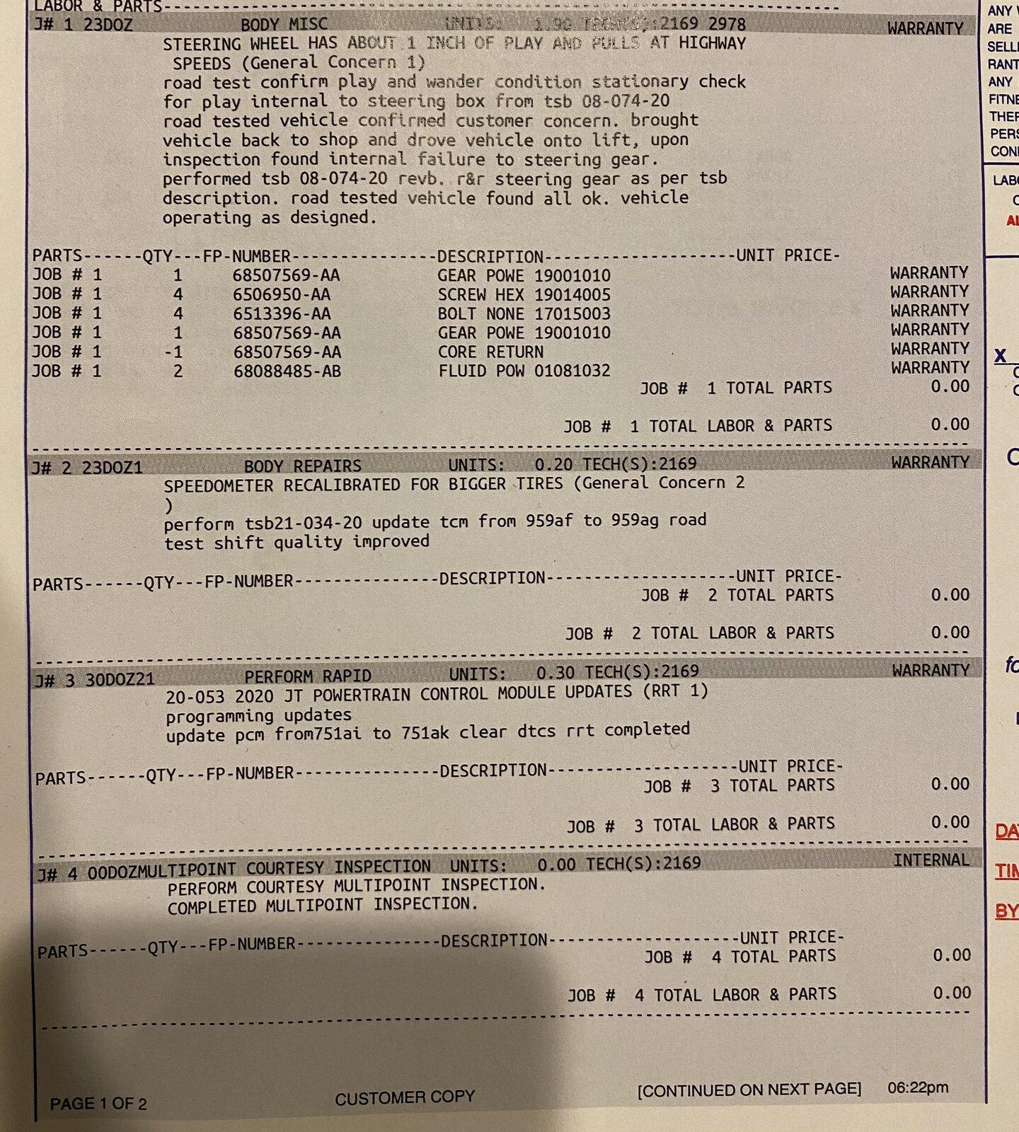

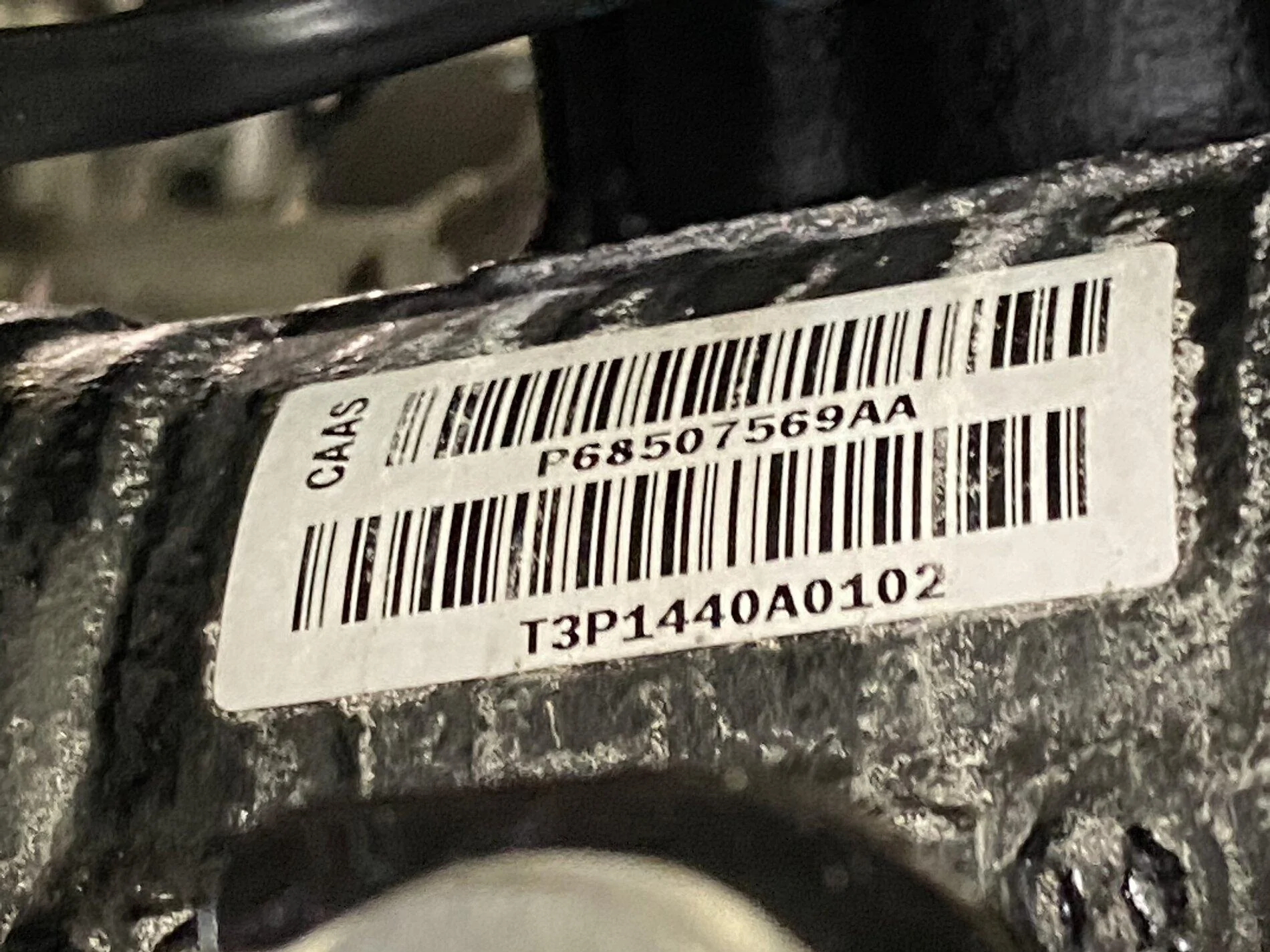

Originally took my 2020 gladiator in for the TSB in early October. Finally got the steering box replaced and picked it up yesterday. Looks like the part they put in is part number is 68507569-AA
It seems the JT part number should be 68507576-AA
Did my dealership install the wrong part? And if so what are the consequences of this wrong part being installed
Wrong part - that is for the JL 4 door.
