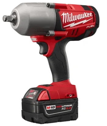

I wonder how my Milwaukee cordless impact would do? My friend says when it disassembles front suspension and steering parts for his restoration work, he doesn't even bother taking cotter pins out so I bought one just like what he had.

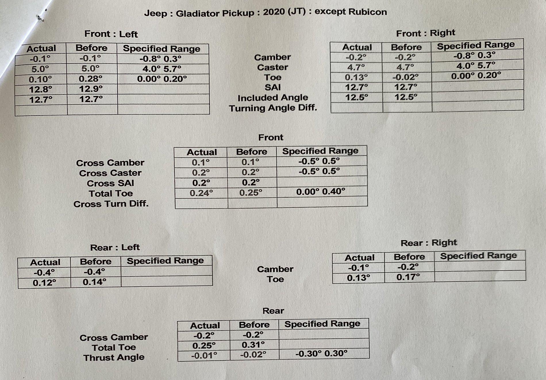

Went in to my dealer this morning for this with the TSB printed out and they didn’t give me a hard time or anything. They did say they checked the alignment first and it was all out of alignment from the factory (see attached) and to see how it feels after the realignment before they replace anything.
It does feel markedly better but I only drove it about 10 miles. Let’s see if it lasts or just post-dealer placebo... I’ll have my wife drive it for a few days — she is the wander whisperer!

The ONLY thing that can be "aligned" on a Jeep without IFS is the toe and total caster - and caster requires parts changes. There's no factory adjustment for caster. If they said they changed caster, then they had to replace the lower control arms.
If they said they changed the side-to-side caster DIFFERENCE, they are full of BS - can't be done, period.
Camber also cannot be changed on these Jeeps.
In summary -
the ONLY thing they can align without parts is TOE. (AND recenter the steering wheel which can actually have an impact on wander)
With adjustable lower control arms, or longer arms, etc. - they can change caster, but only by the exact same amount on both sides (you can't twist the axle tube)
If one side is .5 degrees higher than the other as far as caster, it will always and forever be .5 degrees higher than the other side.
If they did change it +1 degree on the left then they also changed it +1 degree on the right.
Can't twist one side and not the other.
Sort of funny saying these things get aligned in a way........
