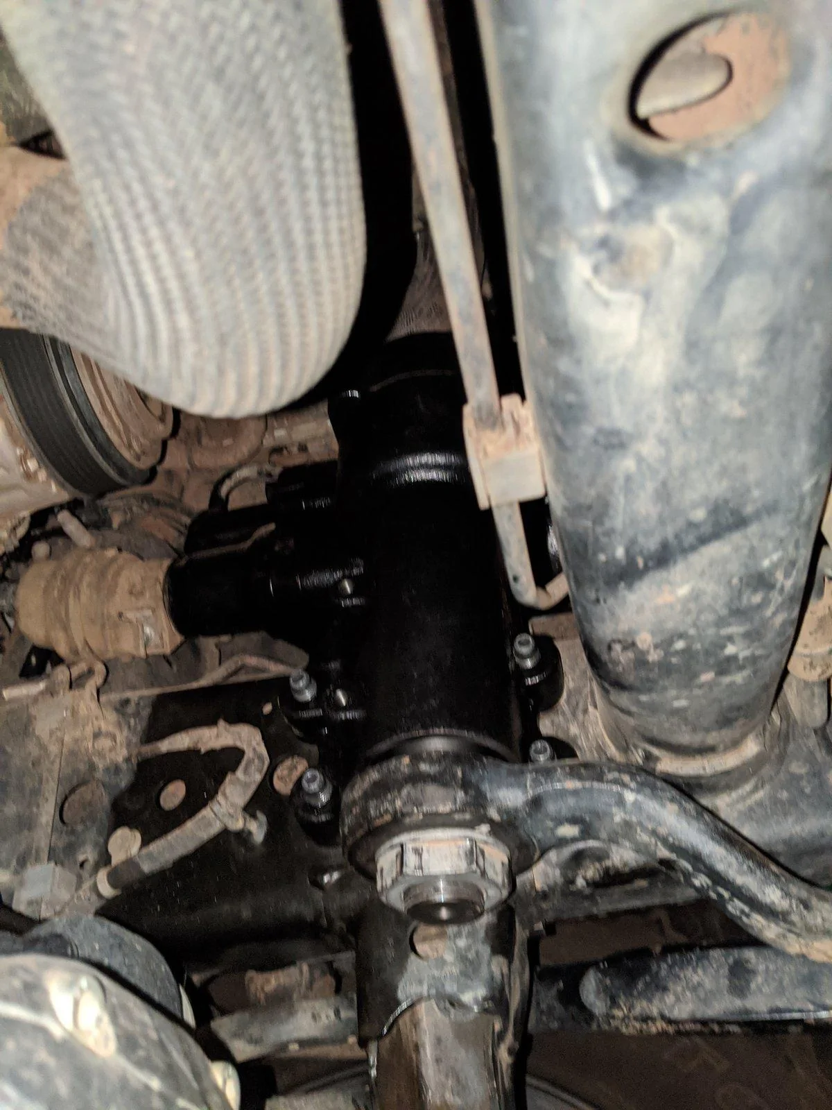

Posted yesterday I was taking mine in this morning to have the steering box replaced. Arrived at the dealership at 8:35, at 5 minutes to 10 they brought the jeep back to the front with paperwork completed. Advised if there is any other issues please call them.
Took off for home with a detour to Corpus Christi to pick up some parts, total mileage to home was probably 70 miles. Totally surprised how the vehicle drove. The wandering issue was completely gone and you could drive the vehicle with one hand
(for the 1st time) and was actually relaxing to drive.
Take away: My Jeep is a stock Gladiator model. Cured the wandering issue, steering is a little tighter now, meaning to turn steering wheel. You can definitely tell the difference, but by the time I got home had totally gotten used to it. The Gladiator has a pretty soft suspension and the body roll is definitely noticed, especially if you had a bump on one side or the other in a curve, it has a tendency to mess with the steering a bit. Cure would probably be a stronger sway bar and links and upgrade shocks like Bilstein. Glad I never spent the money on the after market fixes, you will like the new steering box.

I just came back from Palmer in Roswell with the new steering box. Definitely noticeable difference in a very positive way. Like others have mentioned, you can definitely feel the steering being more responsive and it's much tighter. Can't say nothing but good about the dealership. I called told them my issue and not even a single question they ordered the parts for me. They also got me an Uber both ways which I was really surprised.
