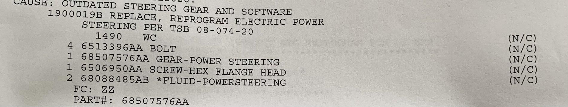

Jeep Gladiator New JT Gladiator Steering Issue TSB 08-074-20 (for "Improved Steering Feel") 451FC98A-696B-413B-9306-9B07D2BC0413
shout out to Leith Jeep in Wendell, N.C. for fixing up my gladiator. It now drives normal! Part numbers above for anyone that needs it. They also updated the powertrain module.

Got her back this afternoon and I didn't realize that I was having problems until after it's fixed. If you can shake your steering wheel back and forth at highway speeds without any vehicle feedback, this TSB eliminated that slop.
Gonna have to say thanks to Lander's Jeep in Norman,OK, they hadn't heard of this TSB, I was the first one to go, it came out great and I couldn't be happier!

Had the TSB done on Aug 26. It was a good and bad experience.
The good:
After the replacement, It was everything I had hoped for. No more pull to the right and no more "sloppy steering" and wandering down the road.

Swapping the steering gear won't change the steering wheel centering. If it was off after the steering gear was replaced, it was off before it was replaced.

I was the same way in the fact I really didn't notice the steering at first. My last Jeep was a 1983 CJ-5 with 33x12.50r15s, so the steering didn't seem much different and thought "its just the way a solid front axle vehicle drives" or "its a Jeep thing". My girl friend and a good buddy of mine both made comments about how much I was moving the steering wheel at highway speeds in my Gladiator. A quick look at this forum and I realized that the JL/JT actually steer worse than the JKs, so this wasn't "just a solid axle/Jeep thing".
Long story short, the fix works and driving my Jeep is much more enjoyable...
