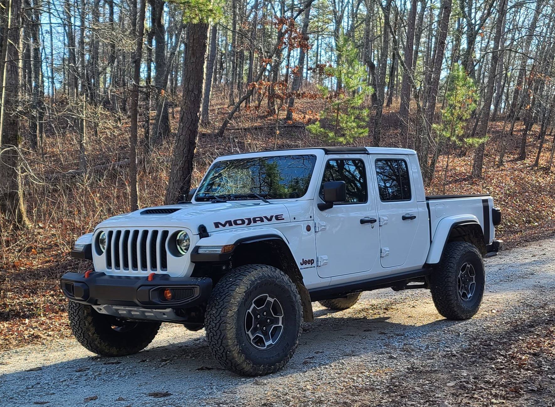

I have ko2s on both my Gladiator and the wife's FJ. Last set on her FJ lasted 109,000 miles. So that's my vote!

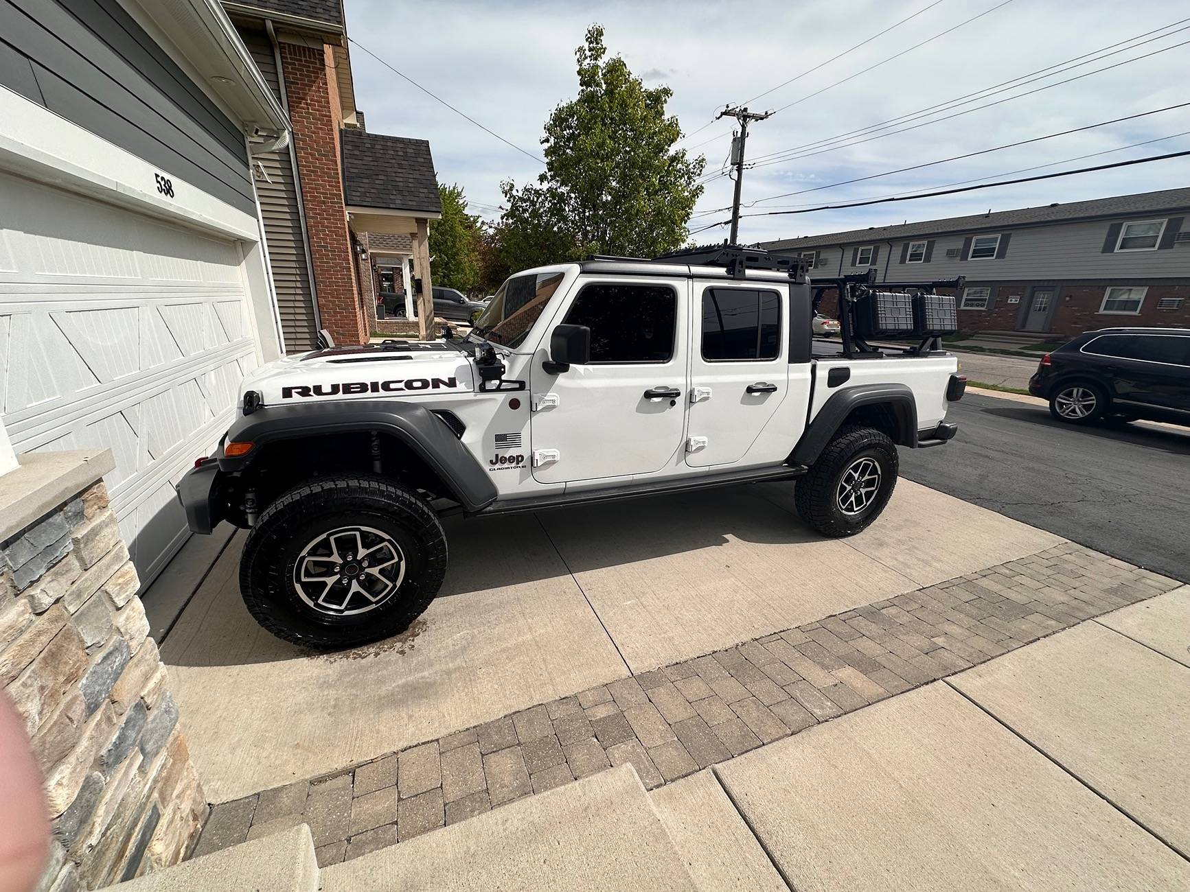

Had a 2020 gladiator rubicon on 37’s Traded for jlur Xtreme recon. Recently bought a leftover 24’ Mojave. Wasn’t going to do much to .put onboard air, and got a matching wheel for the spare. Well… I lied to myself and want 35’s. Want to use factory wheels and no spacers. I’m interested in ko2 315/70/17 c , or Falken at4 35/11.50/17. I really like ko2 had them in three jeeps. Light weight is a plus. I worried about balancing issues, but had good luck in the past. I like the Falken s had them in both gladiators with good results. They are heavier than the ko2. Any advice on those tires on a Mojave with stock wheels would be appreciated. . Pictures would be be great too.

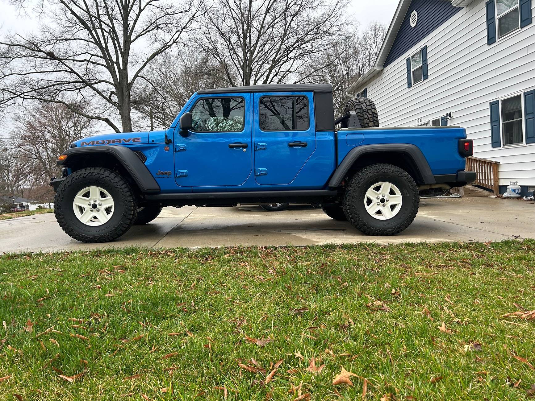

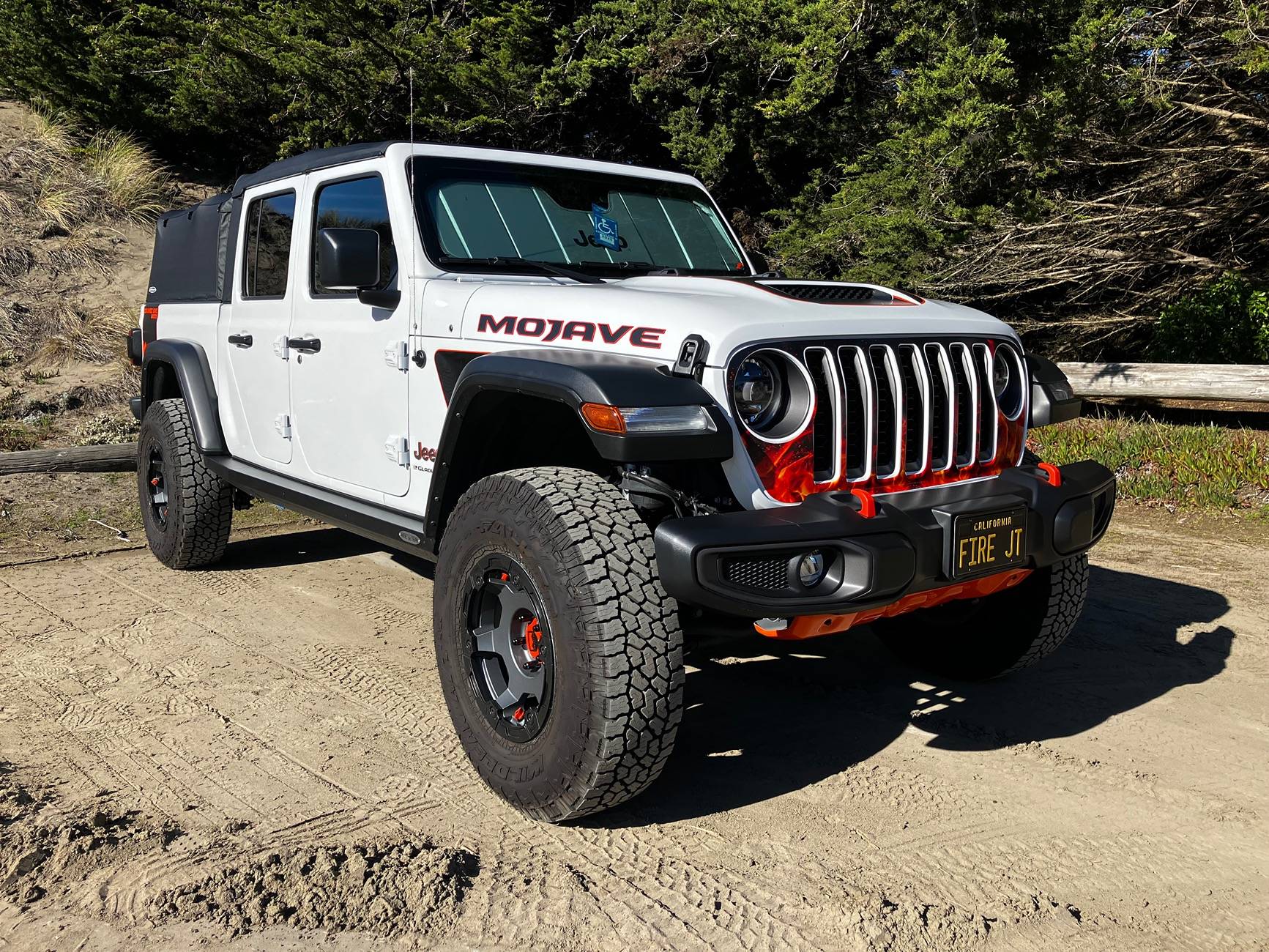

I put K02 on mine, you can see it in the avatar pic. But on the stock rims, they looked a little goofy like they were going to pop, so I put on some new wider rims, looks much better
Also no lift.

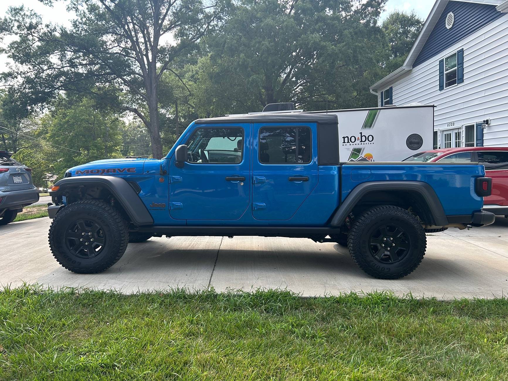

I installed Maxxis Rzr ATs (35s) on the factory black Mojave rims without any issues. Good affordable tire with great ratings.

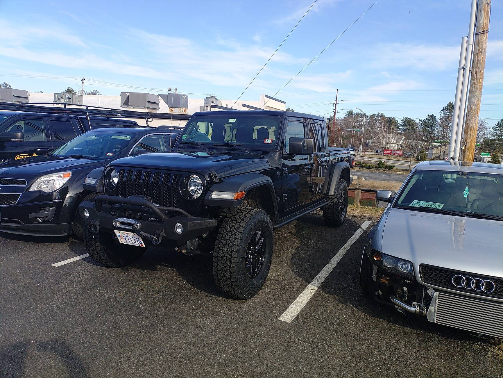

Just throwing out another option, 35x11.5r17's Toyo open county A/T love them
Jeep Gladiator New Mojave 35” tire upgrade on stock wheels 1751451474885-vf

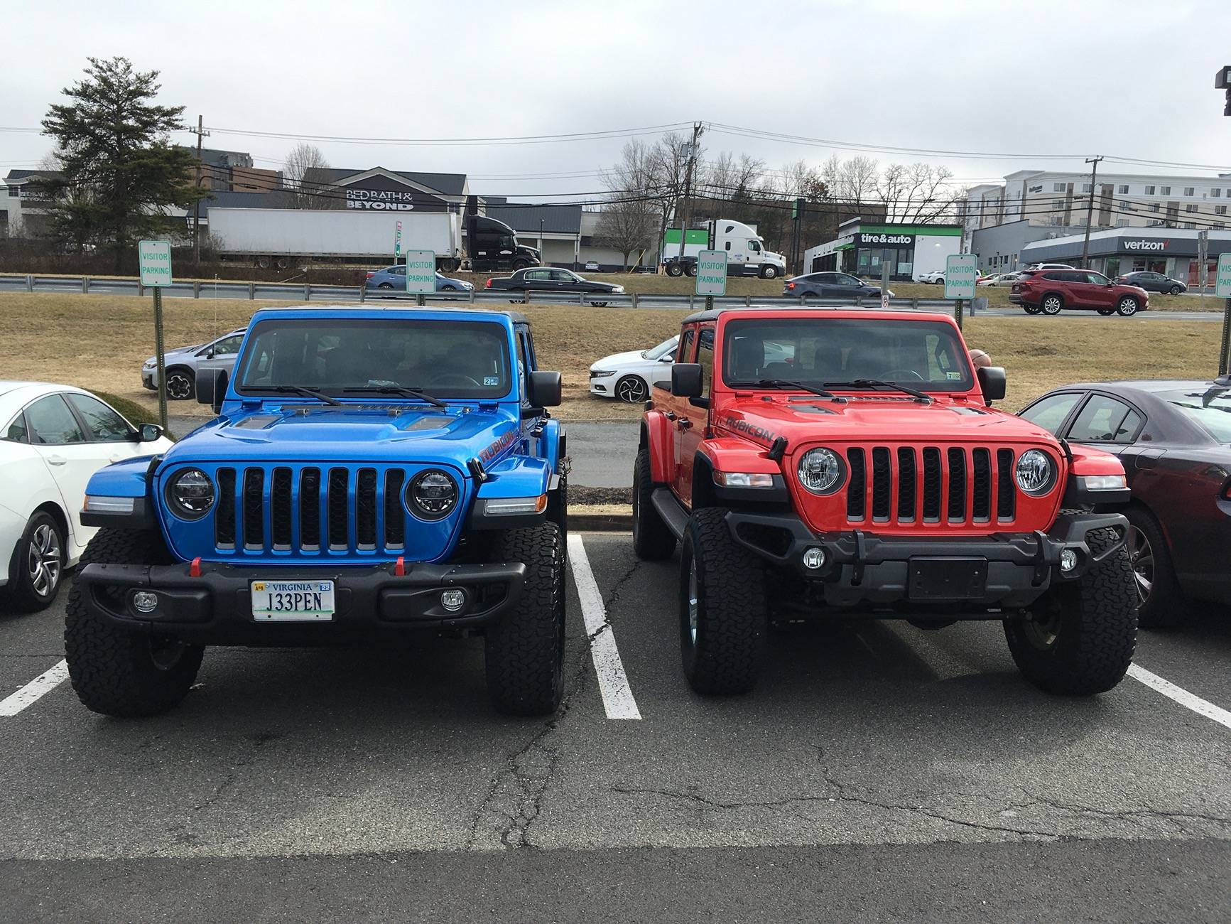

Jeep Gladiator New Mojave 35” tire upgrade on stock wheels IMG_2344
315/70/17 no lift mojave, stock wheels
Jeep Gladiator New Mojave 35” tire upgrade on stock wheels IMG_2012
37x12.5r17, JT sport wheels w/1” spacers, no lift

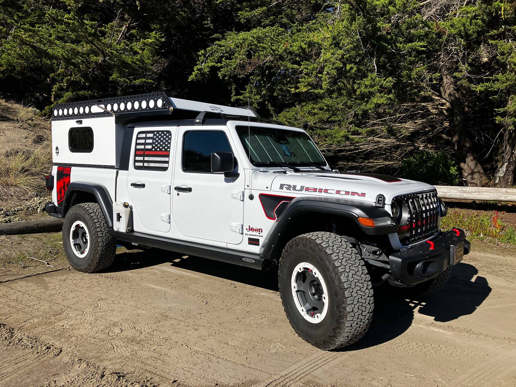

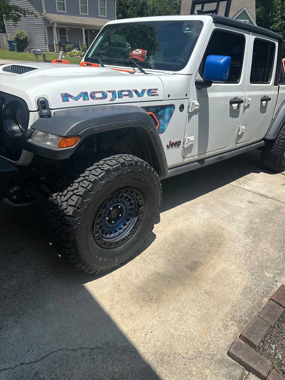

Falken Wildpeak At4’s 35x11.5r17 on stock rubicon wheels. These tires are BEEFY, much beefier than the bfg KO2’s.
Did your gas mileage change much? Do you still see 8th gear?
