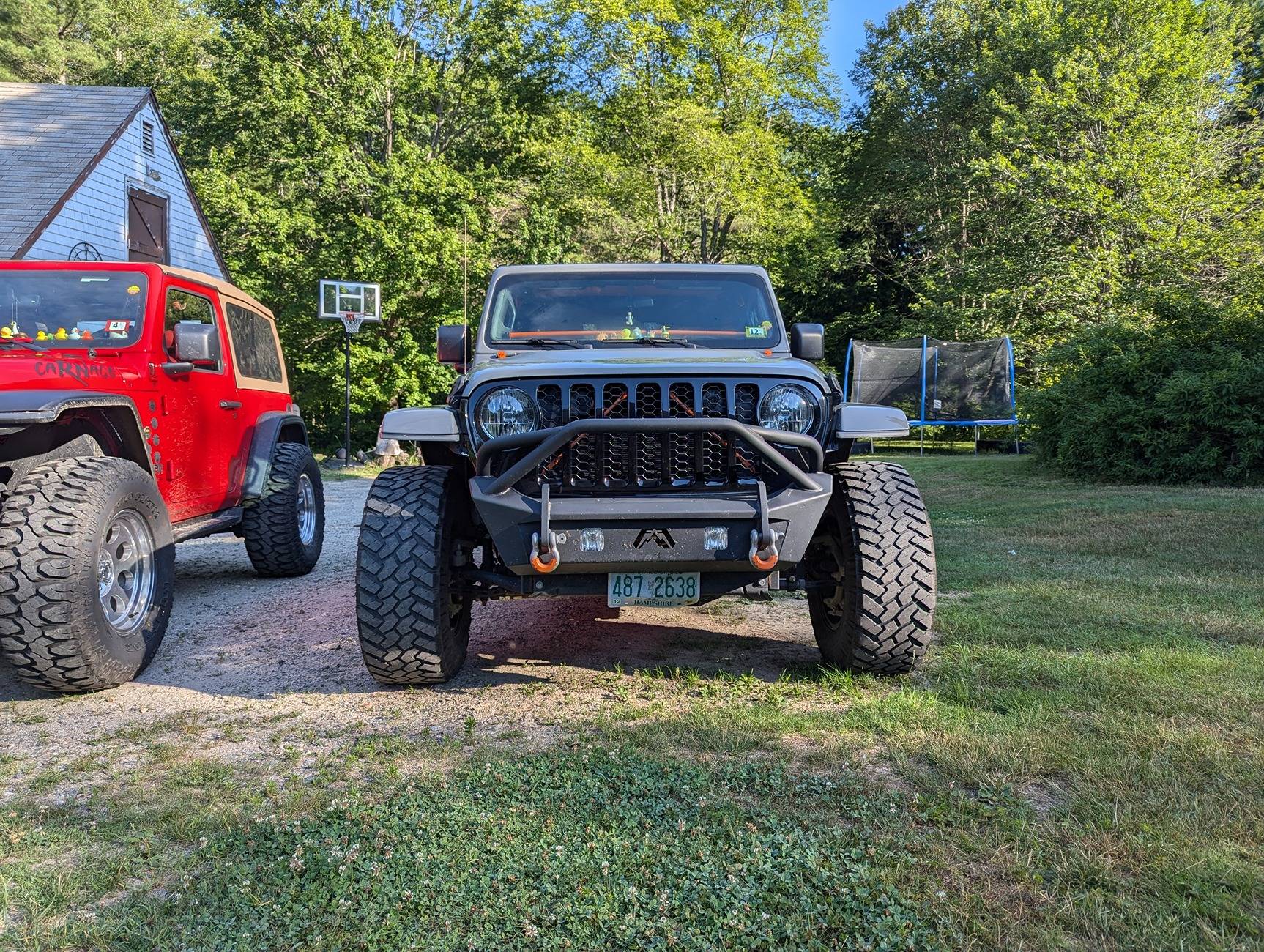

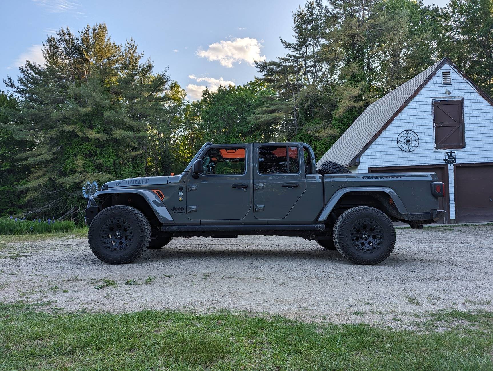

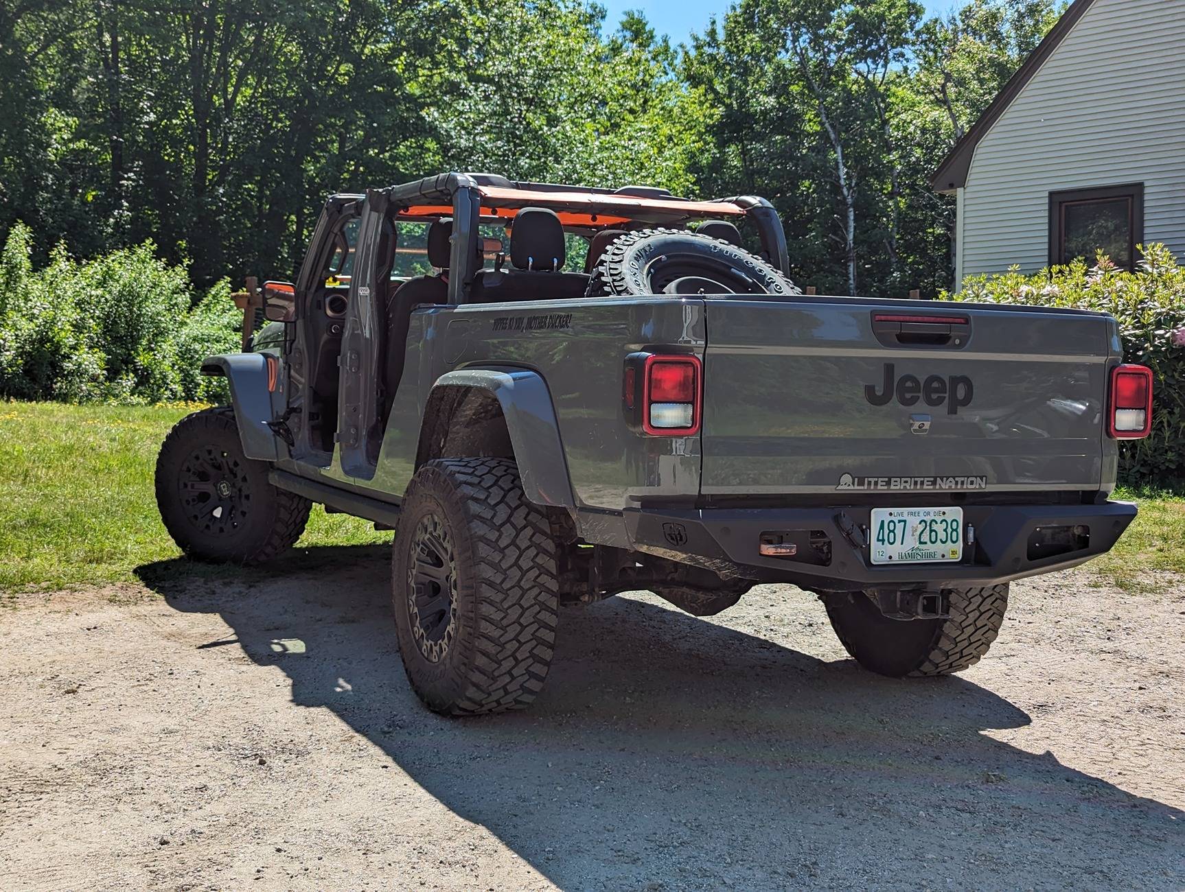

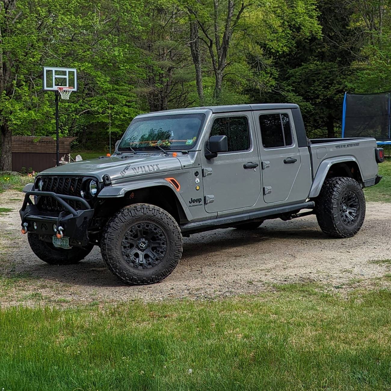

Hi,
My Willys sport is rolling on 295/75/17 so my tires are wider by about 3/4 of an inch. I have the Teraflex leveling kit. This pic is with my new tires. Instead of running spacers I decided on some clearance black rhinos that are -18mm offset. I did new inner fender liners and a fender chop this year. Didn't need to but I wanted more space in the tire well.

Hi,
Love your set up!... How's the tranny and engine handling the bigger tires? Did you update tire sizes (tazer mini)? Handling?
Thank you! Handling improved with the levelling kit, way less nose dipping in the corners. The tranny struggles a little with shift points. I plan on getting a tazer mini to correct that just ran out of funds because....life. I wouldn't say it's required with these 34's but it would help correct a few things for highway driving that I do rarely. I'm planning to get 4:88 gears soon to get the pep back before going to 35's or 37's. Tire weight definitely matter, my Nittos are super heavy but bullet proof on the trail. Meanwhile my wife's Milestar 35's aren't noticeable on her Wrangler. I'm leaning towards some Mickey Thompson tires next.

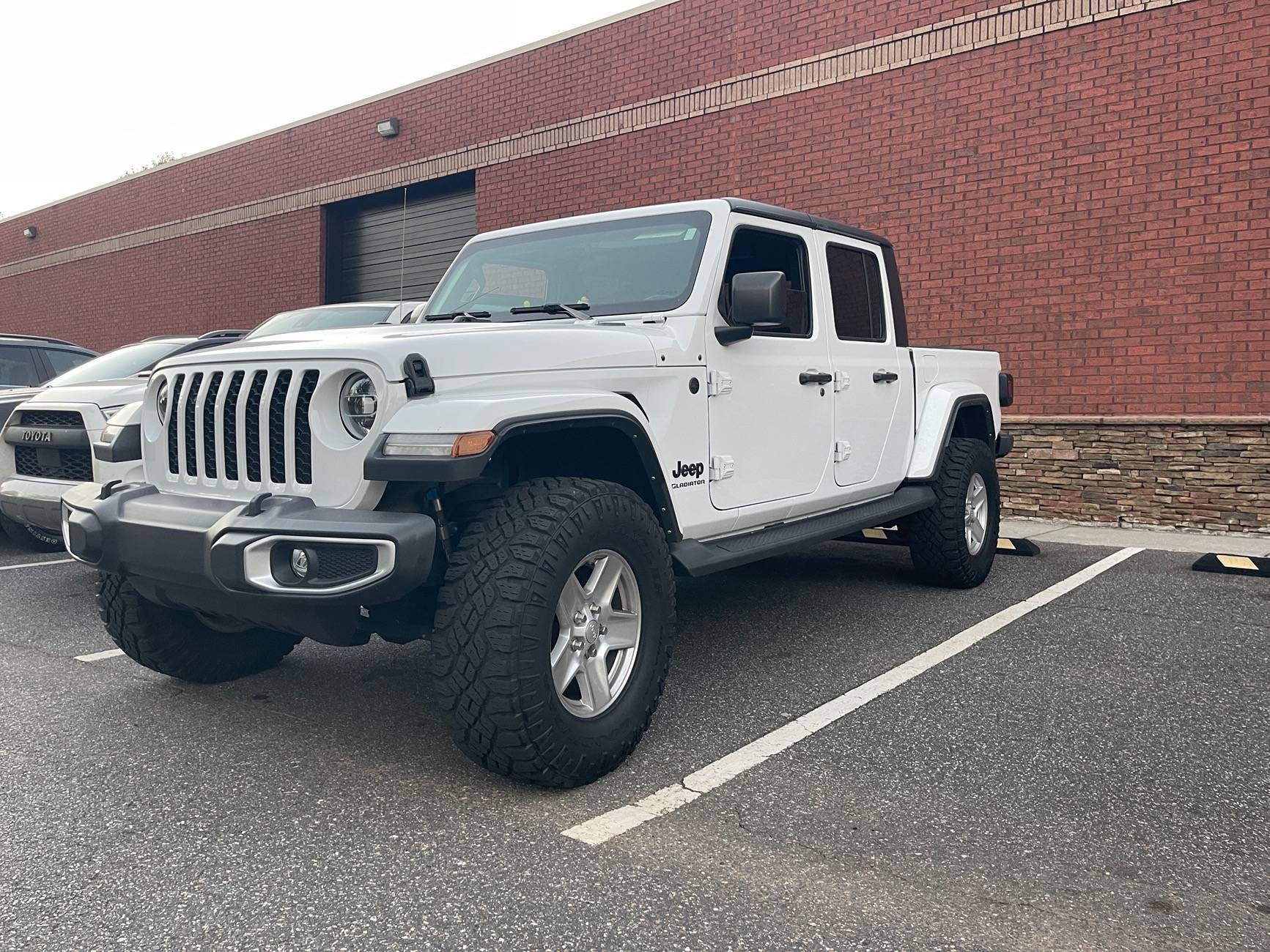

Well, Im not changing the stock oem rims, so not sure how big a tire can you go after they can have issues. Also not sure about bigger size then needing to re-gear or stuff like that. I do Understand the look will be similar to a Rubicon and I'm all good with that. The Spacers should do the stance some benefit too.
As I said, My use will be weekend driving, countryside, light off road. Nothing too drastic.
I'd love the look, of a beefier wheel and tire, of course... But at what cost in the long run?
But any input regarding this "worry" I have, is gladly welcome!
Don’t have to, 35s and even 37s will go on the factory wheels.
