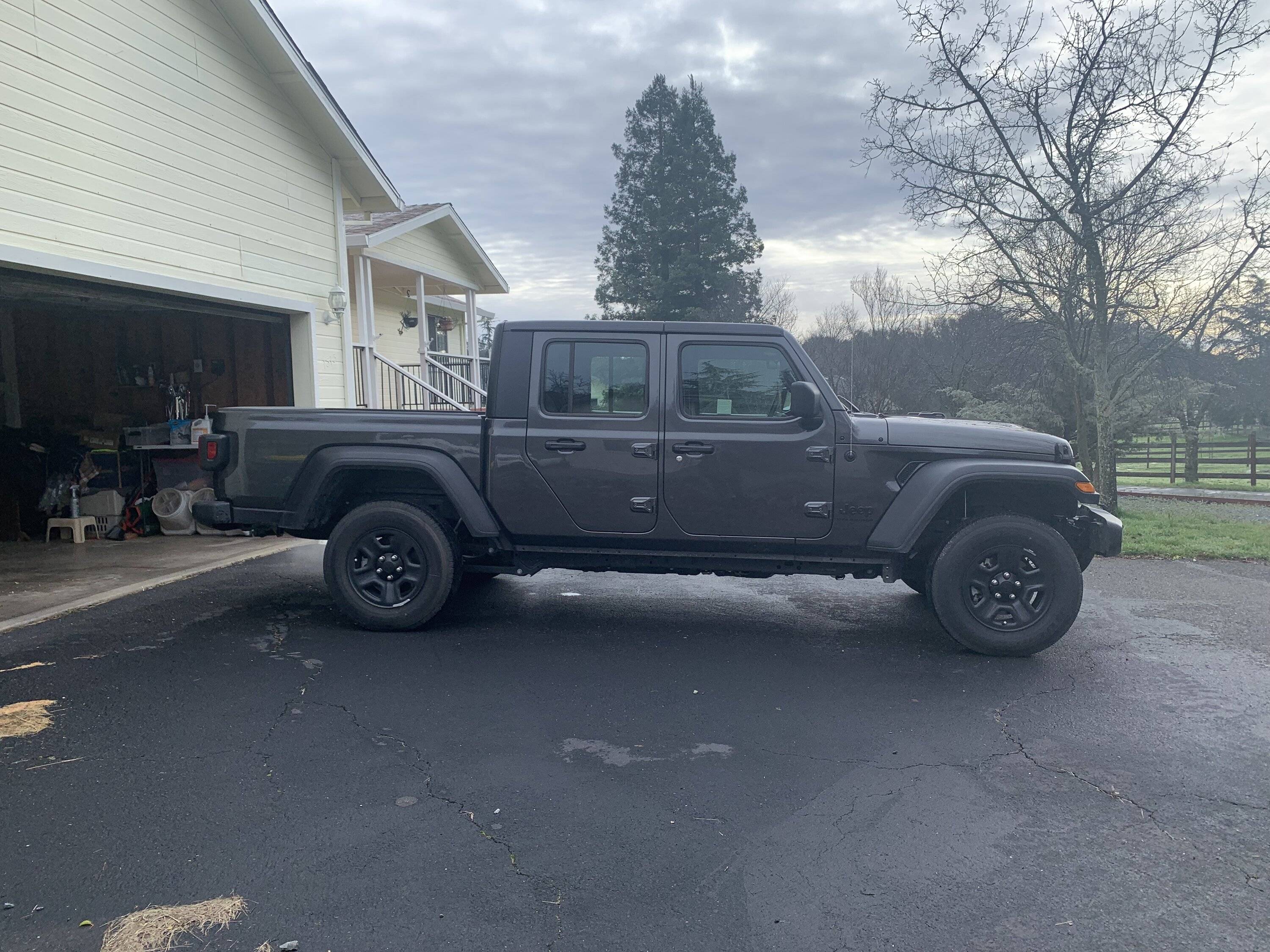

It's so stock, but the lift made it better - and it drives better.
Keep in mind - lifts and larger tires reduce tow numbers. (or what it can safely tow)
So if you got a max tow and put on a 3" lift - it's not going to safely tow the factory numbers. It's always "appropriately equipped" or words to that effect and that means - if things are just right, from the factory.
The sales person said they could do it. He knew I would be hauling horses.
Sales people just plain don't know - there are rare ones, like the guy I use, who has out of his own pocket gone to Jeep training courses and knows all of this stuff..... but most? Naw. They don't really know much, especially about what makes a tow vehicle.
My tip for 90% of all car/truck buyers - don't go by what the sales person says when they say "sure, it can tow that" unless they show you your exact version in the book with factory equipment.
Added equipment also drops your payload. If you have a payload of 1500 pounds and put on power steps that weight 150 pounds, your new payload is now 1350 pounds.
The trailer's tongue weight - say that's 400 pounds, comes off that so now you have a payload remaining of 950 pounds for you and other stuff in the truck or ON the truck. Steel bumper - subtract that extra weight from your payload.
Anything you add to the truck or carry in or on it takes from the payload.
Trailer tongue weight counts against payload.
Lifts and larger tires reduce towing capabilities.
So if you plan on modifications, get the most tow rating and highest payload you can muster!
