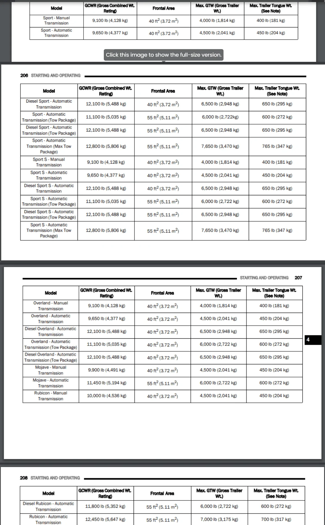

If you go back to page 2 of this thread, it seems like there are several models that will meet your towing capacity requirements, but are not “Max Tow.”
Might make it easier to find a replacement.
Just a thought.
I didn't see any on page 2.

They've got themselves covered in the language.
The HITCH has a 7650 towing capacity when "properly equipped" = Max Tow.
Then it says, do not exceed what's in the owners manual.
Go off this:
Here’s what ecidiego posted… breaks it all down ?

That Rubicon listing, with a gas engine, automatic transmission, and factory Tow Package, will get you the highest Tow Rating possible without going to a Max Tow model.
