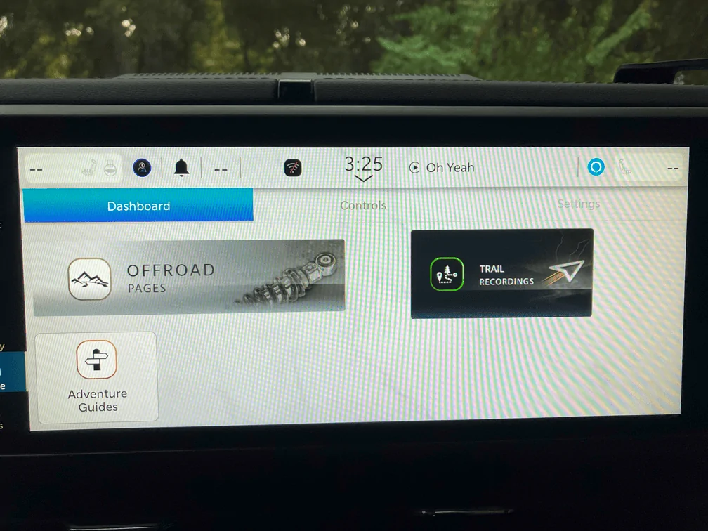

So, do you now have the full off-road pages with all three apps on the screen like the one in the picture? I’m trying to find a fix for this. Who did you contact? The dealer has been no help.

I always had all three. The problem is the Offroad Pages icon was grayed out and would not work before the update. After the update all three started working as designed and have since. I contacted UConnect Support/Jeep Connect and they opened a ticket for the repair. The contact info I have follows:
Technical Specialist, Jeep Connect Customer Care, 800-777-3600
