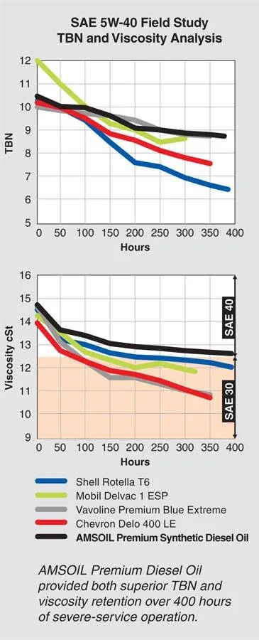

Here's a 400-hour study comparing Rotella, Mobil, Valvoline, Chevron, and Amsoil. TBN isn't that important anymore for modern oils, so I would ignore that part of the test. But if you look at the bottom chart, you can see that Amsoil and Rotella holds viscosity better than Mobil, but Mobil is still very suitable. Very few people run their trucks for 400 hours. If you look at my last two oil changes, you'll see that my engine logged 148 hours in a 5,586-mile interval.

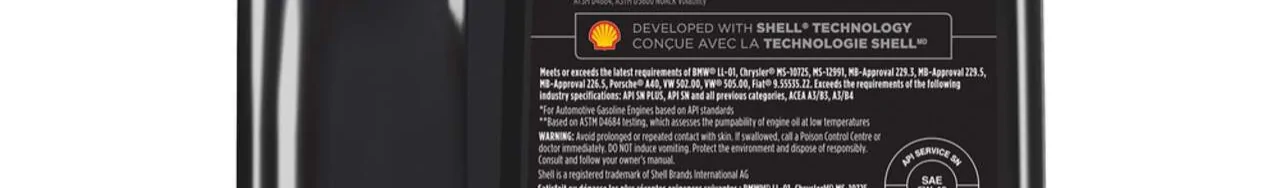

For my Canadians, canadian tire sell motomaster 5w40 and it meets both requirements. Also it goes on sale for $32 for a 5L jug. Says it's engineered by shell so I can only assume it's good quality for about half the price of penzoil.
