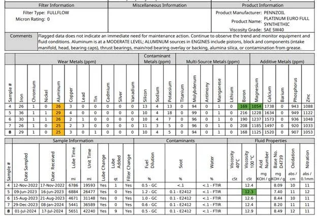

Here's the most recent oil analysis (2020 Ram 1500). This sample had a lot of towing miles on it. I've used Hot Shot's Secret FR3 additive on the last two intervals. Since I can't see any clear benefit from running FR3, I will discontinue using it.
Thanks for testing and the data. Agreed it looks like a waste of money. Do you know if anyone has ran their black diamond oil through uoa?
You're welcome. 👍
After two oil change intervals, I see no benefit. But yes, that's one less thing (and cost) that I need to worry about.
There's been a few who are running the Black Diamond oil in the 2nd gen engine. I'll see if I can find anyone running it in the 3rd gen engine.
