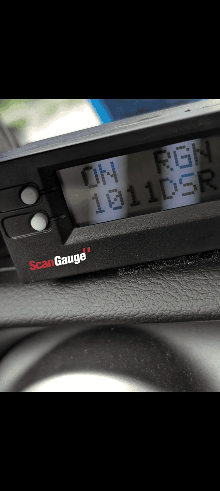

Mine does about the same, every 800 miles or so. Must be happening due to a different trigger than SL because with my driving routine SL usually hovers between 25 and 40%. Passive regen alone doesn’t seem to take it below 20% even with extended interstate trips so my guess is the programming requires an active regen to flush below 10% after a max of so many miles and/or drive time.
After the regen. It drops to 9%. Then slowly raises to 40% and stays there until i get just over 700 miles. Then it will quickly raise to around 70~80%. Then do an active regen. Think the regens are based on mileage and minutes. My minutes are around 1,100.
What I experienced is that, it would active regen while idling down to 50% if it started above 50%. And, would also regen in idle down to 25% if started above 25%. It usually take about 4-5 mins idling.

1008 miles between regens, gde.

This last time. I got a lot more highway miles. Still hasn't regenned yet at over 1,000 miles. SL is holding in the 50's.
