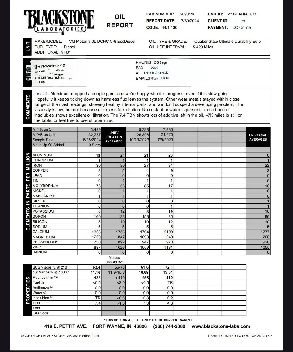

Here's my uoa from (Blackstone) . This is the first report on the new gde flash for dilution. I switched to stp euro after this and will probably go to m1 tdt after. The stp was on sale with their filter package.

GDE now has a new flash for Dilution modifying Y 81 and the 3rd pilot in the fuel table so as not to have excessive aluminum piston skirt wear?? if it’s true that’s awesome because he is superior to MR in tuning.
Wow, that oil did thin out pretty good. Unfortunately, this is a Blackstone non ISO lap so we don’t know for sure what the real readings are on this report.

@22EcoDs
Was the listed Quaker State oil used on both of the last two oil service intervals? What was the oil used on the first one (7880 mile)?
First was Penzoil platinum , second and third are QS euro. 3rd is the new tune. 2nd was the OG gde. 1 is oem.
Couldn't tell you what tables were modified, only that it was created to address the fuel dilution issue. And based on the report it appears to have worked.

The second and third are statistically within the margin of error so they are identical essentially? What do you see on the number two in terms of fuel dilution as compared to number three?
