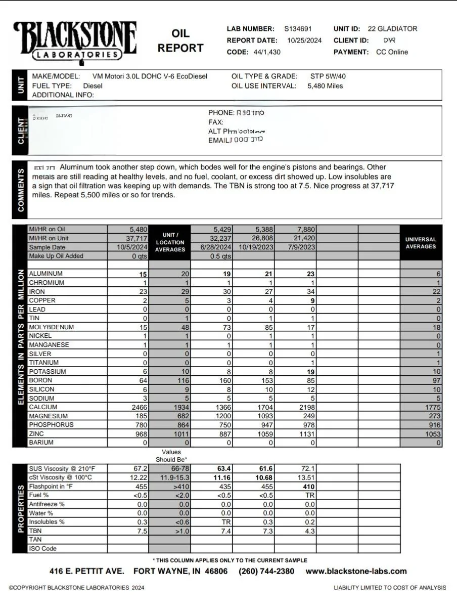

Results on stp 5w-40 diesel.
Since his Blackstone underwear numbers will be 20% higher.
Were you using STP with the other samples? It shear downs pretty badly. You would need to see how bad the fuel dillusion is with another oil analysis company.
Were you using STP with the other samples? It shows down pretty badly. You would need to see how bad the fuel dillusion is with another oil analysis company.
Don't talk about my underwear. This was my first and only with stp prior to that was QS and pp. Fuel dilution is on the report. This doesn't look like a bad report to me.
Meant to say some of the oil in tte other samples are shearing down pretty bad.
Blackstone doesn’t do fuel dilustion. You need to send it to oil analyzers or another that does proper reporting.
Viscosity and Flashpoint are still in spec which excessive fuel dilution would bring down.
Are you saying Blackstone under reports those parameters also in addition to fuel dilution?
