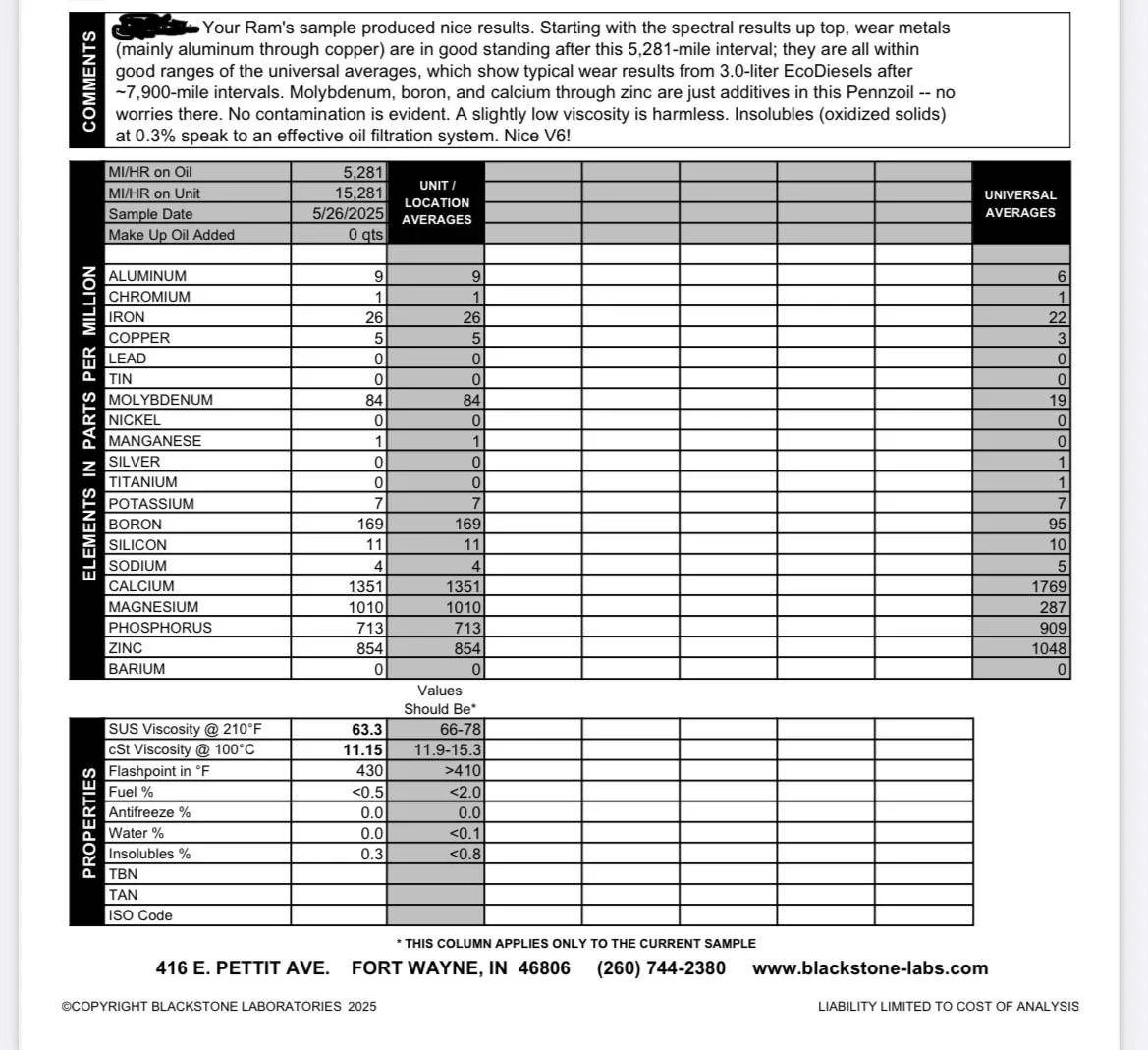

Just found this thread and thought I would put my Black Stone report here
This is Pennzoil Platinum Euro 5w40 in a 2023 Ram. Truck was GDE tuned almost exactly at the 1/2 point on this oil.
Lot of towing, around 1/3 of the miles are pulling a 6,500 lbs travel trailer through AZ and CO.
Was thinking of switching to the Quaker State 5w40 but after reading think stick with the Pennzoil.

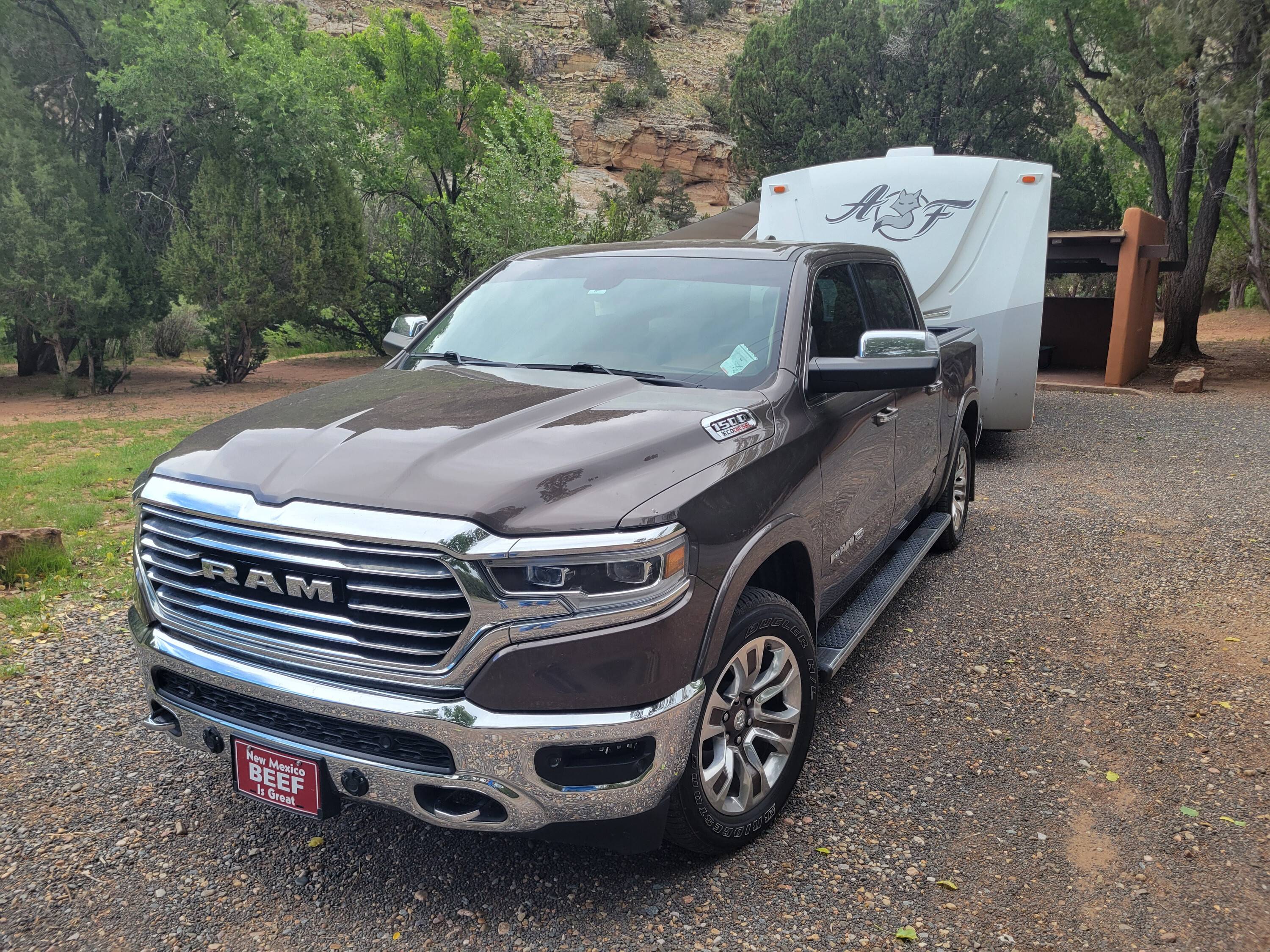

Yeah I have seen the oil temp get over 250 towing up hills, don’t think I have seen it break above 260 though.
Reading this thread it’s interesting that GDE runs T6 in his Eco Diesel. I may reach out to them and ask about it.
Here’s the truck and camper, our last trip to Durango.

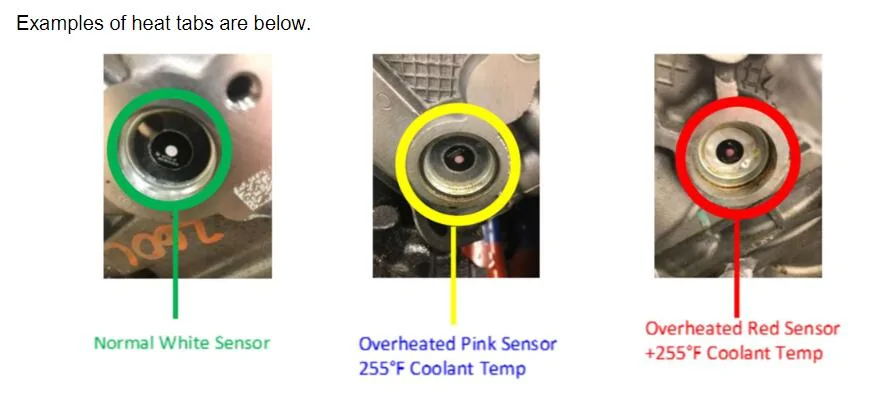

Not sure if the ecodiesel has heat tabs, but the 3.6 does..... they tell you if you got the motor too hot
Where are those located on the 3.6?

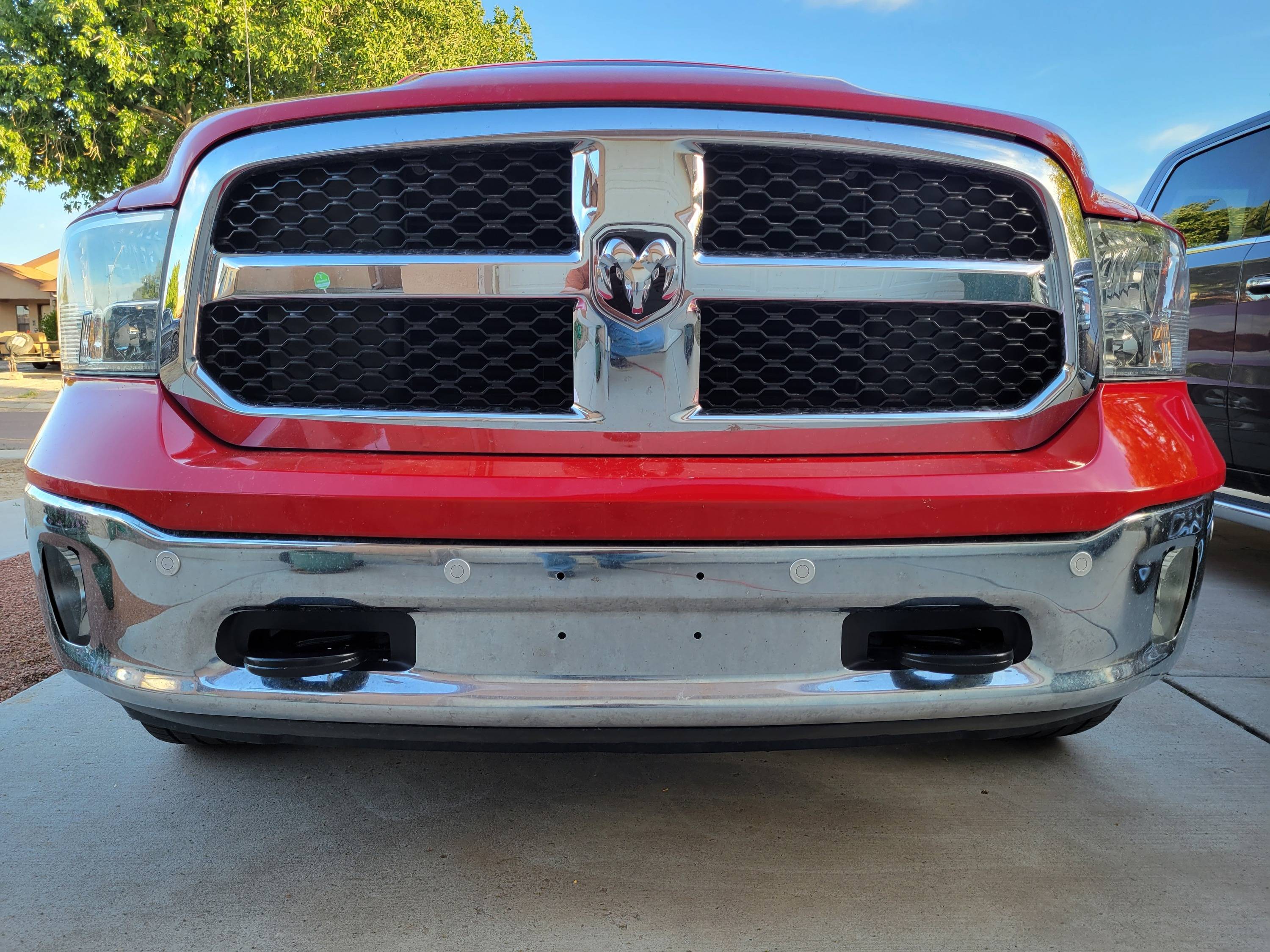

I thought the bigger grille of the Ram made it run cooler, but if you think about it, the engine oil heat exchanger can't keep up, not the radiator.
The EcoDiesel in the Ram runs much cooler due to the large grille opening and the intercooler is separated from the radiator. The Jeep is a stack design, so that limits cooling capability. Jeep engineers touched on this topic back when the EcoDiesel was first released in the Wrangler/Gladiator. Consumers were confused why the EcoDiesel had a lower tow rating than the Pentastar. The answer from Jeep was a lack of air flow.
The 2014 - 2019 Ram EcoDiesel has a stacked design as well, so I've had to learn to take it slower. My goal is to find a small travel trailer for the Gladiator that is under 5,000 lbs loaded. We love finding campsites along mountain streams. A smaller camper will get us into more spots. Our current trailer is 23' 10" from bumper to hitch. For a secondary trailer, I'd like to keep it around 16' feet for total length.

You are talking about engine cooling, aka water, how does the Ram design reduce both oil temps and water temps? The bigger grill gives more opportunity to remove coolant heat but doesn't seem to do much for Oil unless they have a oil cooler built into the radiator like they do for transmissions some times. If you read the Ram forums there seems to also be a concern about oil temp spikes.
Actually, more air flow does reduce oil temps. The 2014 - 2019 EcoDiesel runs hot due to the intercooler/radiator stack design. Ram remedied this issue in the 2020 - 2023 EcoDiesel by lowering the intercooler to ensure the radiator and intercooler are getting proper cooling. Plus, the 2020 - 2023 trucks have a larger grille opening for more air flow.
In addition to the stacked design, Ram had different grilles from the factory. The Big Horn was the most restrictive grille. It reduced air flow by something like 30% compared to the Tradesman grille. For that reason, I switched from the Big Horn grille to the Tradesman grille. That helped reduce my oil temps.
