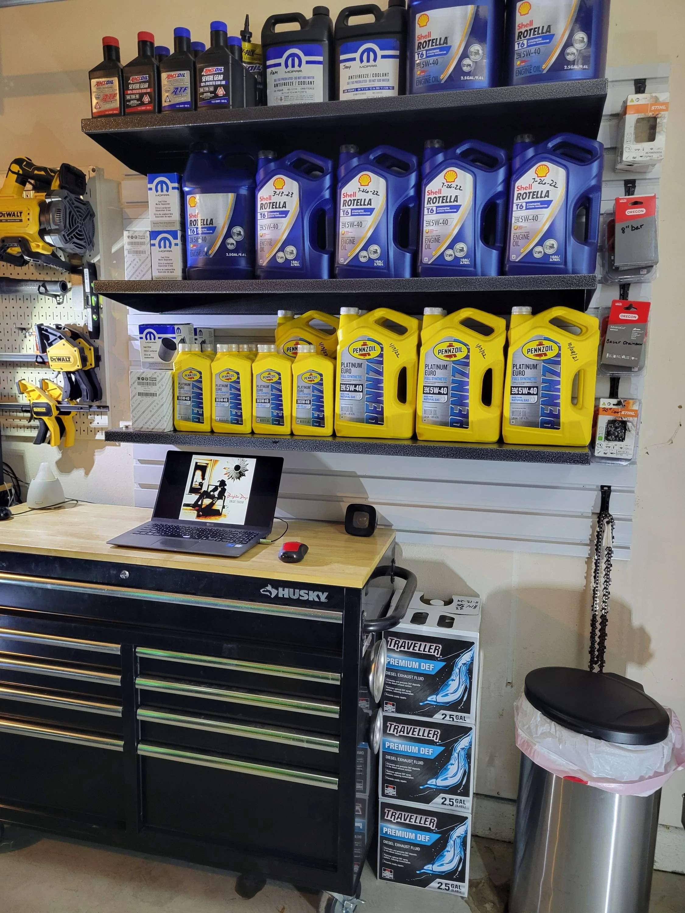

You must be my brother from a different mother…NICE!
I like to keep my workspace clean and organized. I live a busy life, so I'd be in trouble if I wasn't clean and organized.

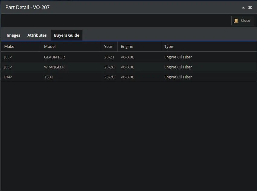

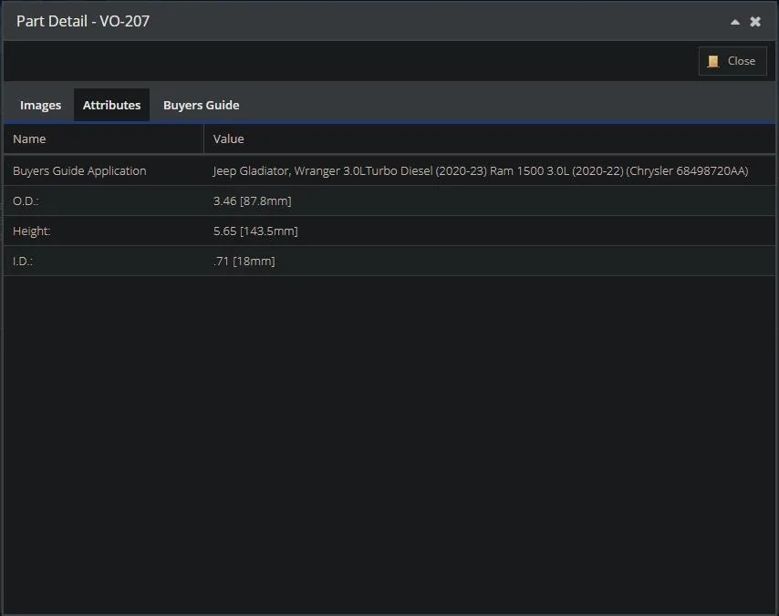

Updates from Valvoline. I copied and pasted two separate emails below.
Thank you for contacting Valvoline Product Support,
For our European Full Synthetic 5W-40
Noack is 9.7%
SAPS 1.0 %
Unfortunately, we do not have a product information sheet to provide for Valvoline oil filter VO-207.
However, Valvoline filters are designed and guaranteed to meet OEM specs for form, fit and function when used in accordance with the vehicle manufacturer’s recommendations
Valvoline partnered with the leading industry engineers of US OEM filters to design and build the Valvoline Filtration line to the same exacting quality standards.
You may search Valvoline filter recommendations via year, make, model, and engine size or via VIN here:
https://valvolinecatalog.com
You may search filters via part number and view images, filter attributes, and the guide listing vehicle fitment for each filter based on OEM specifications.
We do stand behind our filters when used in recommended applications. Please see the attached attributes and filter warranty letter.
If you have any further questions, please feel free to contact us via phone at 800 TEAM VAL or by email at [email protected] for assistance.
Thank you and have a great day.
Valvoline Product Support.
Jeep Gladiator Official EcoDiesel Oil and Filter Recommendations VO-207
Jeep Gladiator Official EcoDiesel Oil and Filter Recommendations VO-207 applications
