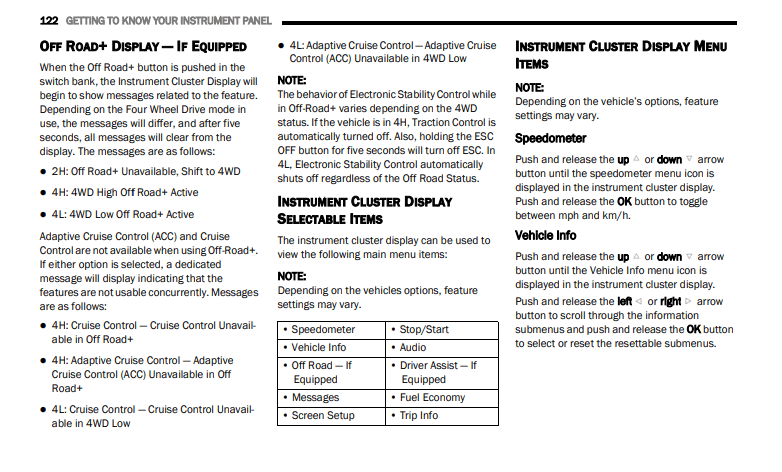

From another thread
(https://www.jeepgladiatorforum.com/...ifferential-in-4high.16964/page-4#post-584895),
here is the procedure to get a 2021 Mojave to activate the rear locker in 4H
I tried this at the dealer today. I was able to activate the rear locker in 4-Hi, in a 2021 Mojave, manufactured Sep 2020.
The procedure is shift transfer case to 4-Hi, press Off Road+ button, hold ESC Off button for 5 sec (it seems pressing it once disables traction control, holding it for 5 sec disables stability control), press Axle Locker Rear Only switch. The locker then shows as locked in the Off-Road Pages.
If you forget to hold the ESC Off button for 5 sec, you get a message in the cluster that you must be in 4-Lo to activate the locker.
Thanks to Jim at Normandin CDJR who really knows his 4WD systems.

HMMM ... And this is know to NOT WORK on a 2020 ? Anyone tried ?
Earlier in the linked thread (on page 2), somebody did try without success. Of course a software update may have changed things, but I have not seen success on a 2020 reported without a Tazer or something similar.
