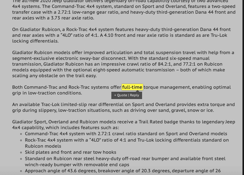

The full time/real time AWD thing was a possible feature in the Sahara JL, doesn't appear to be an option on any of the Gladiators.
I thought so to but I copied that directly from the document in the first post of this thread. Just to make sure I even looked up Jeep torque management and it is a full-time 4wd system.
so does full time torque management mean the same thing as full time/real time AWD?
In looking at this, i would assume the command trac of the gladiator would be the same. 2 speed transfer case. Also cited at the top of your screencap.

http://media.fcanorthamerica.com/newsrelease.do?id=16376&mid=
That link is from a few years ago but several times it mentions full-time torque management as a system that sends torque to either the front or rear axle without driver input. I took this to assume that a 4wd Auto will be an option on Gladiator. If I am not mistaken 4wd Auto is an option on the European Rubicon.
Jeep's name for the full-time, or all-wheel, drive system is Selec-Trac. The Command-Trac and Rock-Trac systems are manual control 4 wheel drive systems. While the wording in the press release may be confusing, if they were offering the Rubicon with the full-time AWD system (like you can get on the JL Sahara), it would be crystal clear, not buried in semantics.

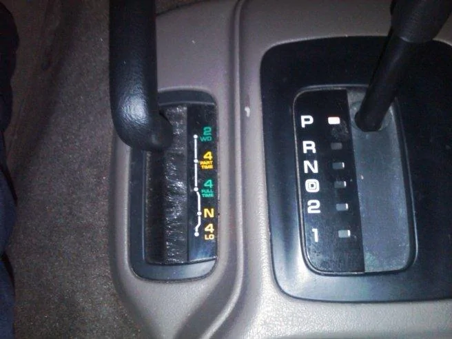

I have had Jeeps for 20 years and they have all said full time 4wd or part time. Actually I have had my 1993 ZJ for 26 years now and when I pull the transfer case the "Part Time" light illuminates. That is not my ZJ transfer case because I just have the Part Time 4wd in mine so I lifted the photo off of the internet.
I am by no means a Jeep expert and I have been wrong more than once. In your opinion what does the statement about full-time torque management in the document mean?

Rubicons do not have full time 4wd. Period. Never have, never will. It's a traditional heavy duty transfer case.
The NVG241OR Rock Trac transfer case has part time, 4wd high, and 4wd low settings. There is no full time 4wd setting on the Rock Trac.
http://www.novak-adapt.com/knowledge/transfer-cases/np241or
The "full time" torque management you are seeing as far as I know refers to the Brake Locking Differential feature as described in this video.
Unless I'm way off base, the full-time torque management refers to the vehicle's systems limiting driveshaft torque under certain conditions when wheel slip is detected. This is especially noticeable on the higher powered Grand Cherokees with the 5.7 engines, and many owners seek bypass methods. It uses the throttle response and transmission to respond "more reasonably" to driver input (like stomping on the throttle in 2WD on loose conditions) to limit slippage, drive train wear and damage(most notably to the transmission). On a lower powered vehicle like a Gladiator, especially with the low over-axle weight inherent to pick-ups, this would seem like a nice feature, as, at least on paper, maximizing grip would seem to be the objective of pressing the gas pedal in any conditions. Spinning your wheels on sand or gravel, especially with a 7600 lb trailer, could be a real problem, and that can happen when towing, even in 4WD, so TM tries to alleviate that.

I think you are mixing something up with T-case (controls front to back power distribution) with differentials (controls side to side power distribution). Lockers, limited slip, and open refer to the differentials. I think the document being discussed about torque management referers to the brake locking feature with uses a brake to slow down the low traction wheel and force power to the other side (again side to side power distribution).
The t-case (front to back) you are debating will not effect your concerns about patchy Wisco driving. Command Trac and Rock Track will be pretty similar in 2WD or 4WD High. The difference doesn’t really come until you enter 4WD Low, which in your driving situation you would only do if stuck in a snow bank, not around town or highways. That is where Rock-trac would have the advantage, getting you unstuck. Hence the claim the Rubicon is the best vehicle in snow.
For the purposes of driving in conditions I think you have in mind. 20-55 MPH where there are miles of dry salted spots and every so often there is a bridge that is really slippery or something where the plow guy missed. If that is what you have in mind, rock trac and command trac don’t help you as much as Jeep’s selec trac (not offerned on the JT). Look at NP242 or MP3022 tcases. They had a full time 4WD that split power front to back in such a way that would allow some slippage on surfaces with traction. They accomplished this in very different ways but end result was you can drive around on dry surfaces in 4WD High Full Time and not cause binding.
