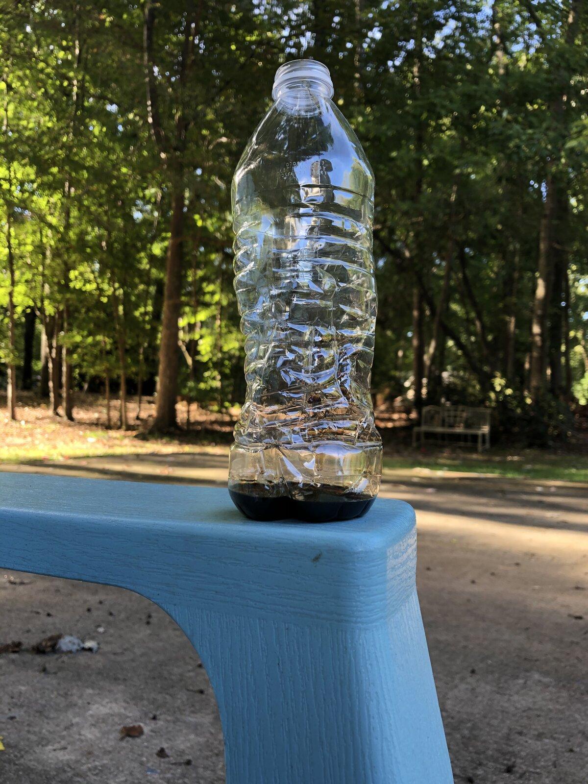

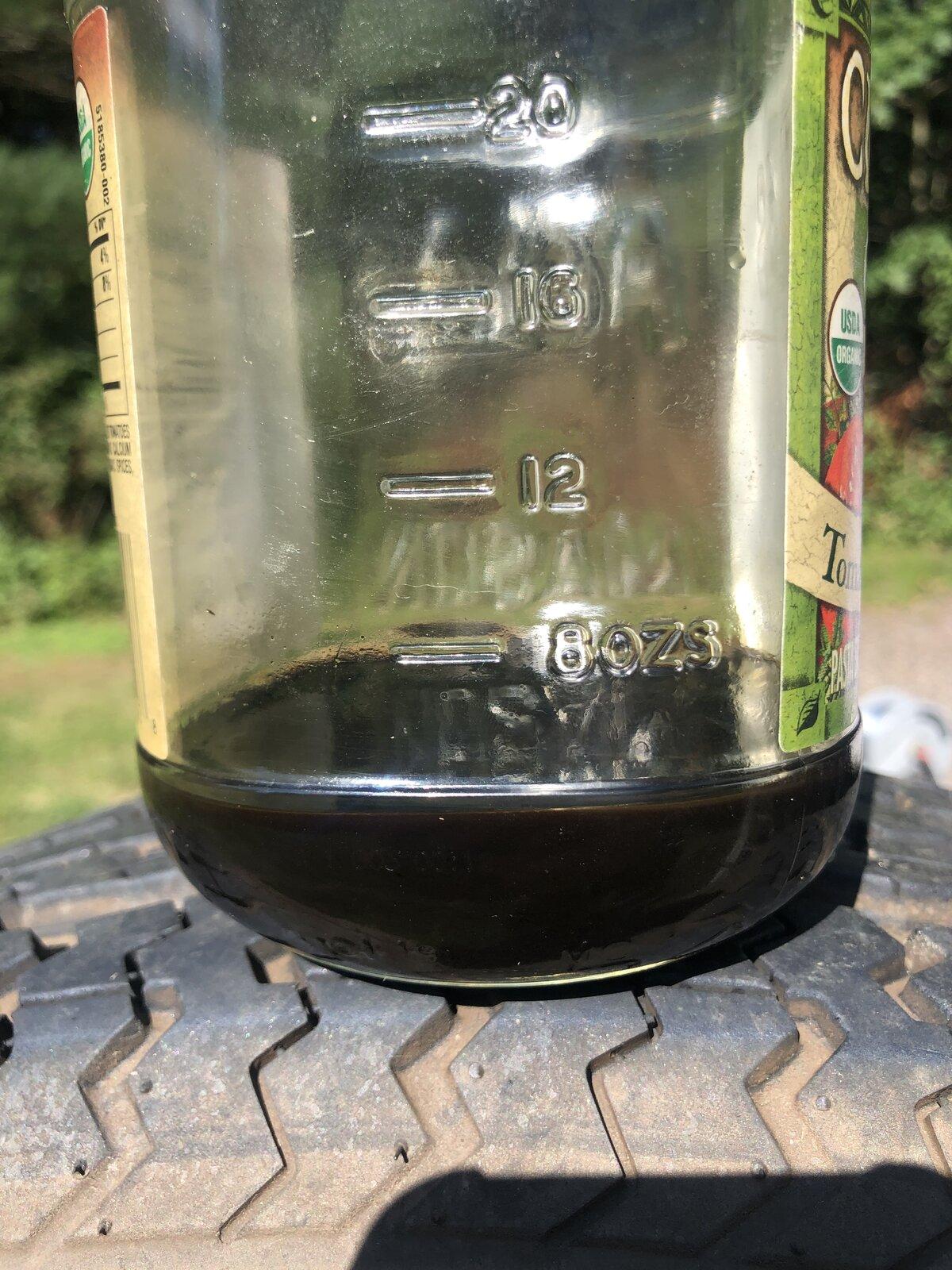

This is after 500 miles with the mishimoto catch can. Not a ton, but some for sure. Mine came out looking like regular used oil. The catch can isn't catching 100% of it though. There is some making it through, as seen in the second pic of a paper towel stuck into the intake manifold connection end of the clean side tube from the catch can. But it looks like the can sure is cutting down on how much oil the pentastar has to eat.
Now THAT is pure oil, the volume is not increased with any water. No starbucks look, pure crankcase look.
Which catch can are you using?
500 miles - highway, town, mix? Towing, not towing? On-road, off-road?
Just curious.
If that is basic on-road driving at 500 miles, take that times 6 for 3,000 miles, the oil should be low on the stick.

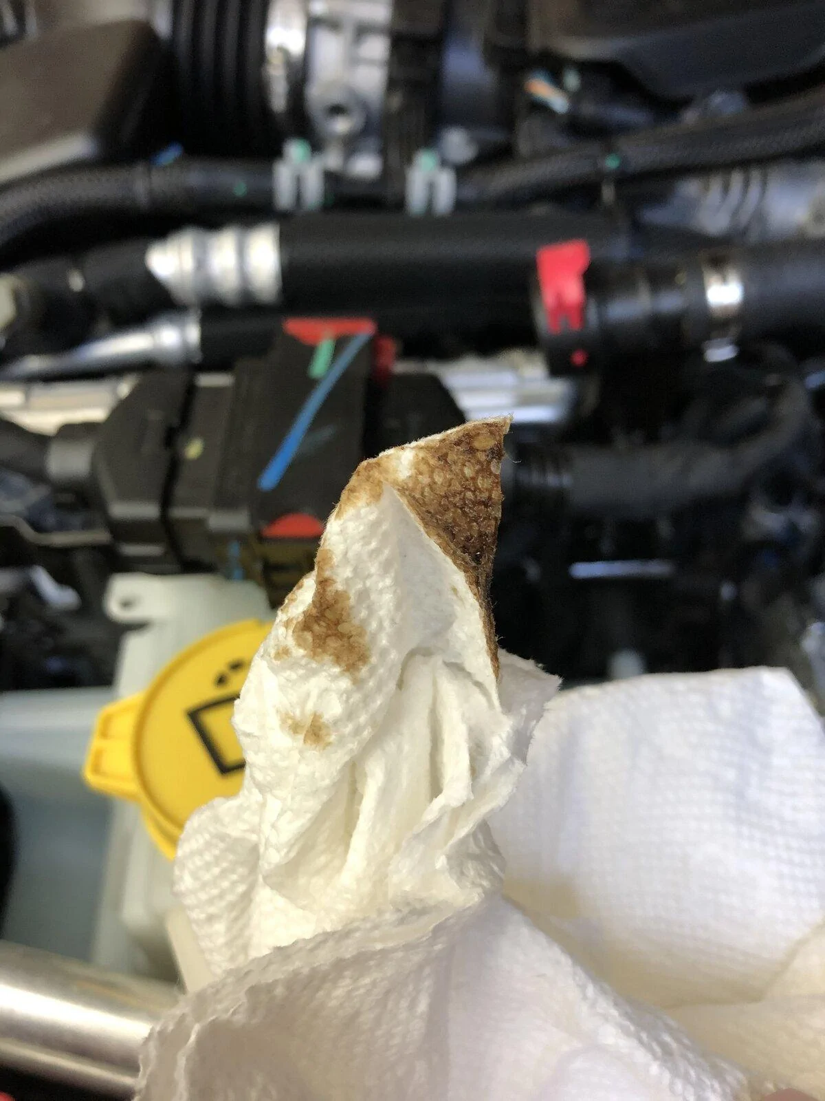

Does it still smoke?
I've seen this before and it was oil building up in the top of the cylinder head. There are holes in the head to drain back into the crankcase and at some angles a lot of oil can get caught without a way to drain out. The PCV then sucks up the oil that's trapped.
It seems like it could still pool up and get sucked in and overwhelm a small catch can.
Just curious.
I haven’t wheeled it on anything really steep since the install. I agree, it could still pool up but I will check the can every few weeks.

A little over 3k miles summer miles, about 5 ounce, stuff in the winter has lighter color probably from condensation being mixed in.
