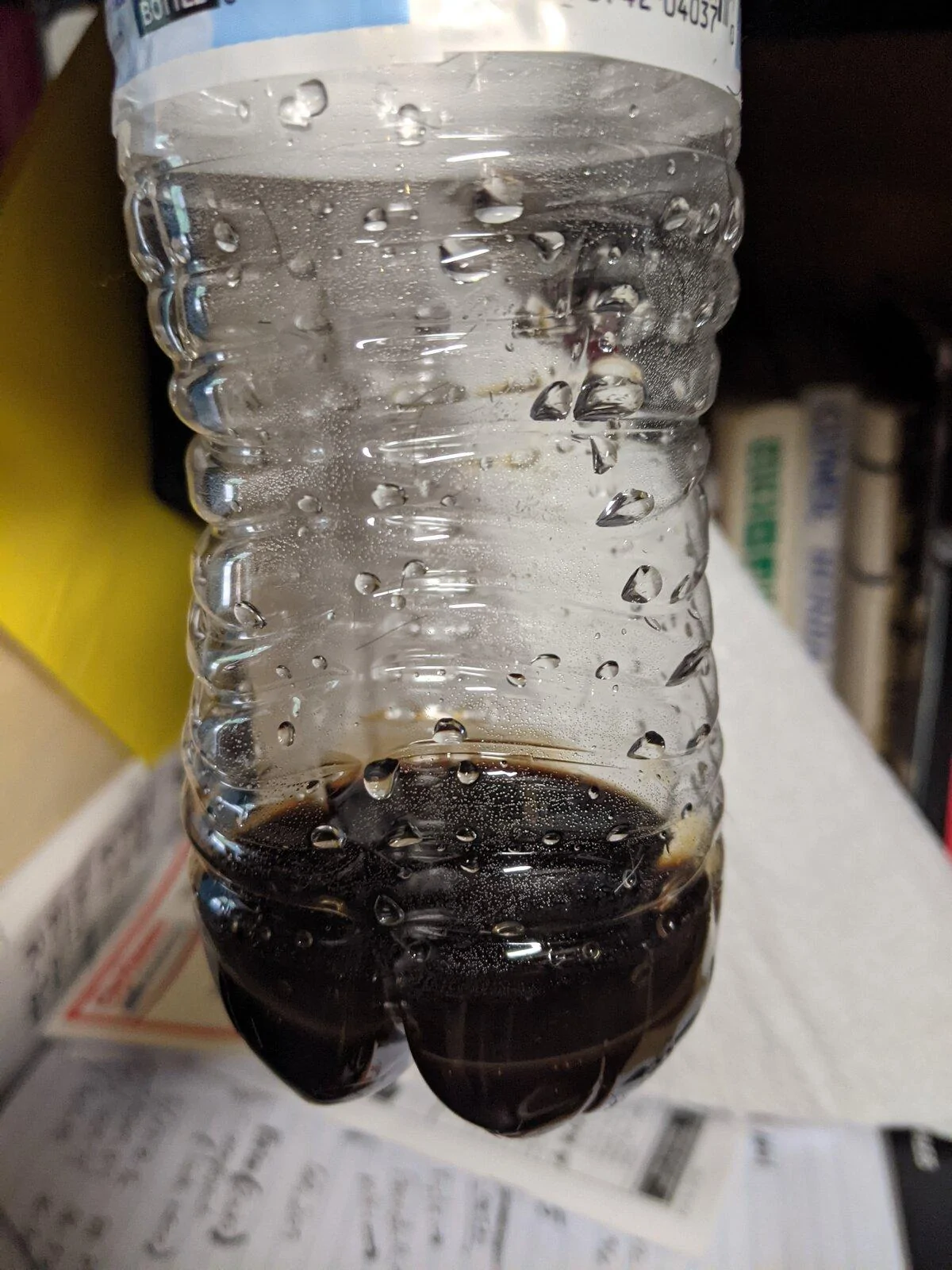

After 512 miles.
Harmless? Most likely but I choose not to have it go into my intake.
It's mostly water mixed with oil due to the consistency.

Looks like mostly oil to me, because it’s black.
Black but really runny and not thick like oil. Definetly has oil mixed for sure.
People can say what they want about these catch cans but seeing is believing.

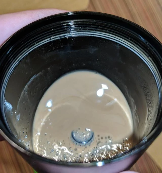

0W-20 oil is pretty runny. When oil mixes with water it will look gray, or what some call milkshake. If you let it sit for a while, the oil and water will separate, with the water sinking to the bottom. Mostly water:
Your correct. Not sure how I forget that. I will let it sit all day and report back tonight if anything separated.

2020 Jeep Gladiator
Yes, there's water inside on bottle. I grab a used empty bottle to drain this stuff in. Also Jeep had 5,400 miles on engine.
