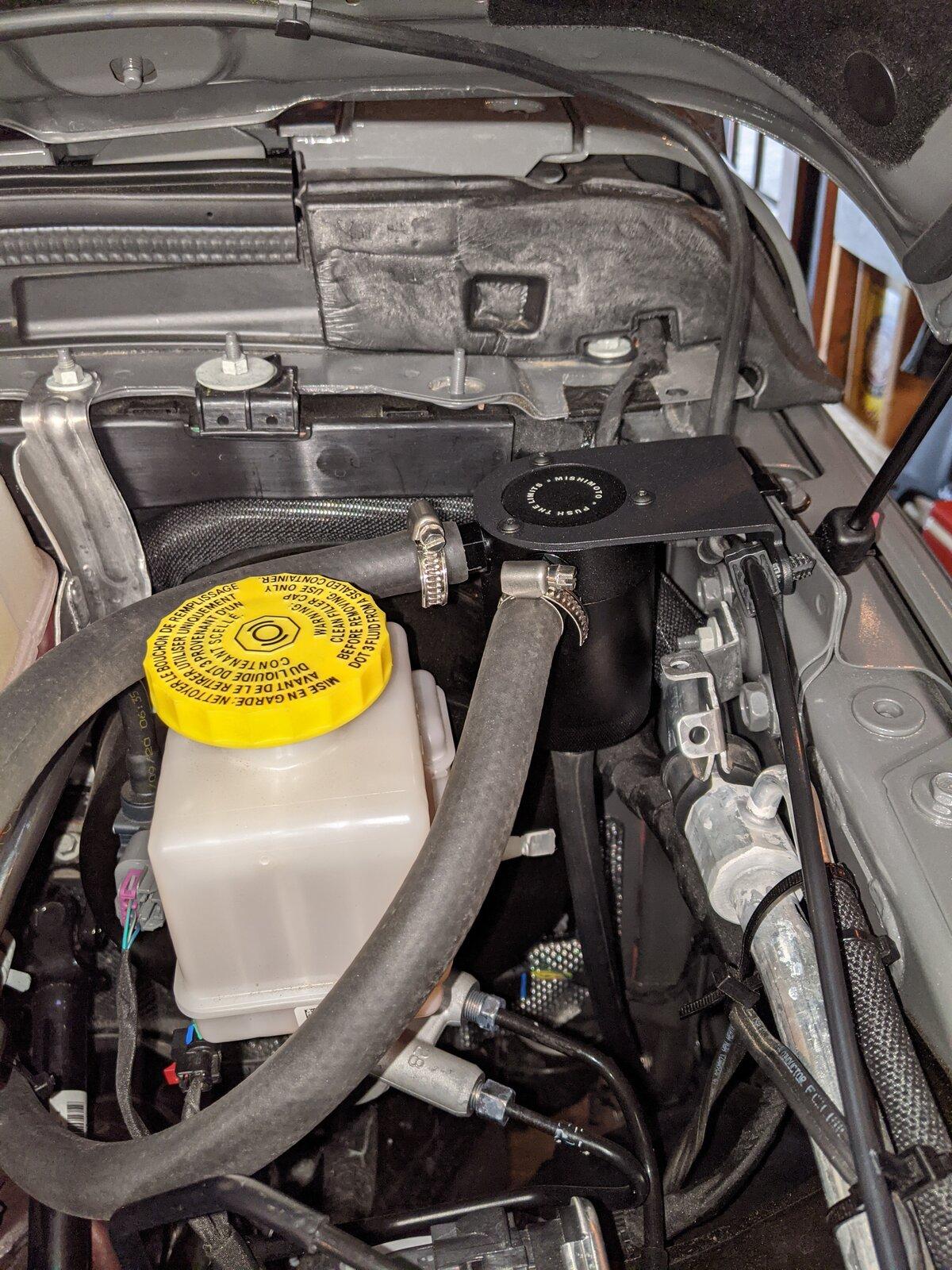

Have my Mishimoto catch can installed. Great complete kit.
Had a catch can on my 07 Dodge SRT as well and yes, if you don't want to ingest oil into your intake then it's a great addition.
Plane on keeping the rig (my last new rig) so doing everything I can to keep it as nice as possible and long lasting.
Jeep Gladiator Oil Catch Can - is it needed? PXL_20201126_211131946

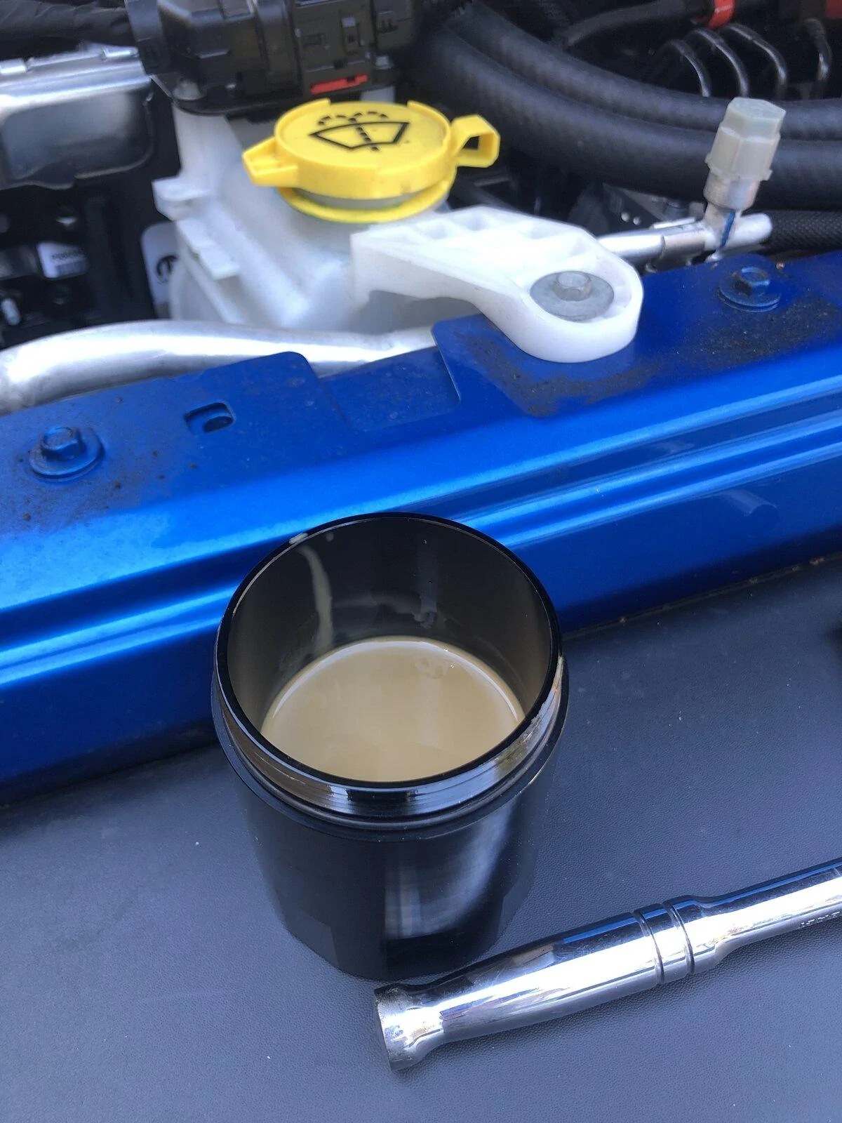

2020 JT Hydro Blue Max Tow
2k miles, half full of this junk.
