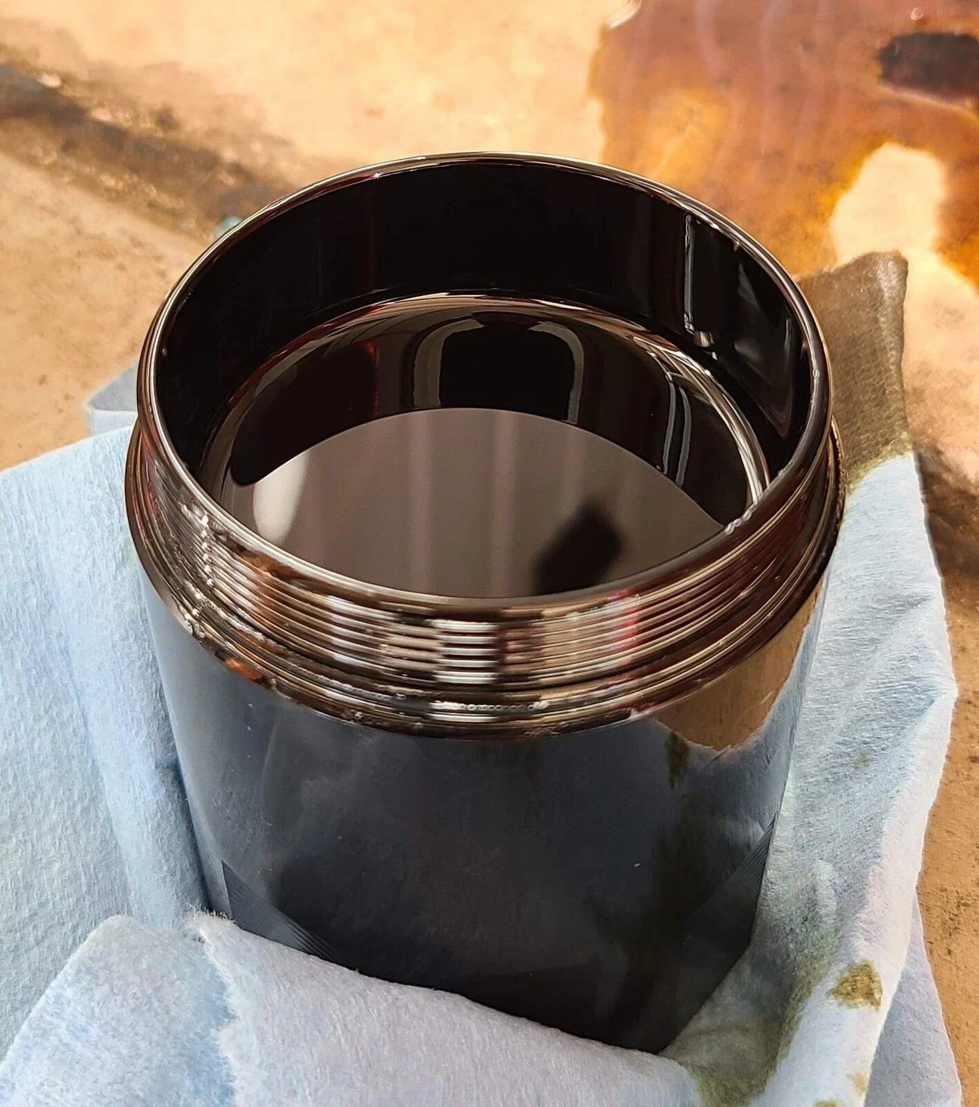

Another month down and checked the catch can again today. iv feel like I have been driving a bit more aggressive lately so the amount of oil bypass looks a bit more then previous but I am seeing a pattern here on the amount. I am going to bring this up to my dealer to see what they think.
How many miles is 1 month? Honestly that looks pretty normal for a catch can, normally you wouldn't notice it as it would just get blown by and burned or if it was a draft tube it would end up on the road haha. I really wouldn't worry about it. Just oil mixed with some moisture gives you that mocha shake look.
I run roughly 1500 miles a month. I am not overly worried about it. blow by is normal for every engine. but a catch can just helps prolong the life of the engine.

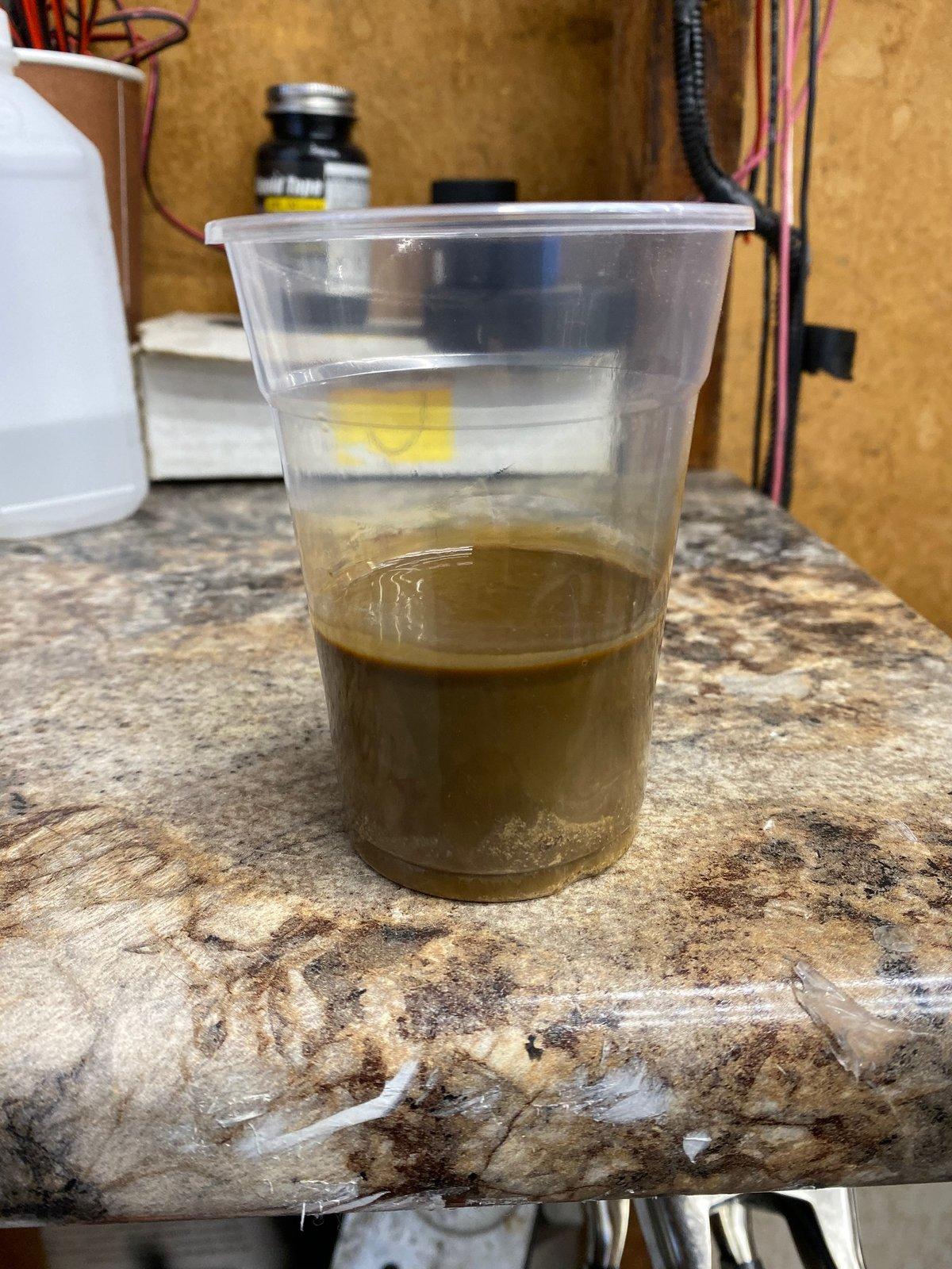

instead of starting a new thread ill add here....i installed the Ripp SC oil catch can about 4k miles ago. I liked their kit because of the dip stick. after 4k miles i filled the full 300ml can, was expecting less but oh well, guess thats why i installed it!

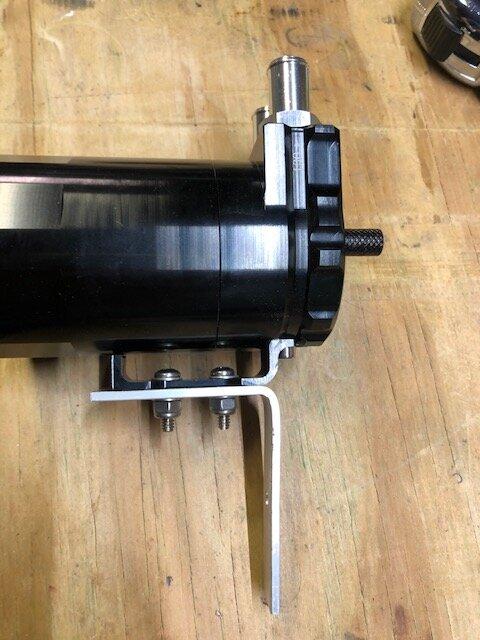

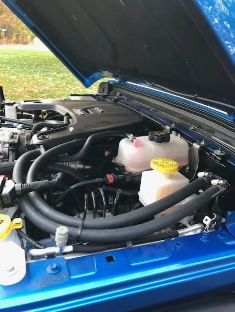

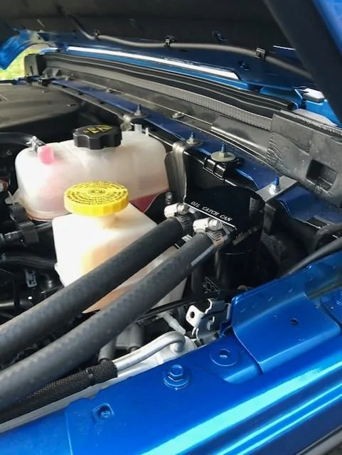

I followed the video above I posted, bought the catch can and 5/8” hose off Amazon. Made a bracket to mount it to the unused stud on the cowl near the brake booster, it take a M6-1.0mm nut, I bought a piece of aluminum stock 3/4” x 1/8” x 36” and four hose clamps. Curious to see what it catches.

I followed the video above I posted, bought the catch can and 5/8” hose off Amazon. Made a bracket to mount it to the unused stud on the cowl near the brake booster, it take a M6-1.0mm nut, I bought a piece of aluminum stock 3/4” x 1/8” x 36” and four Howe clamps. Curious to see what it catches.
You used good quality hoses, right? Cheap stuff will be swollen and will rot from the oil mist.
Clean looking install.
Will see, tough to know, I will keep an eye on it, easy enough to change if I see anything happening with the hose I don't like
