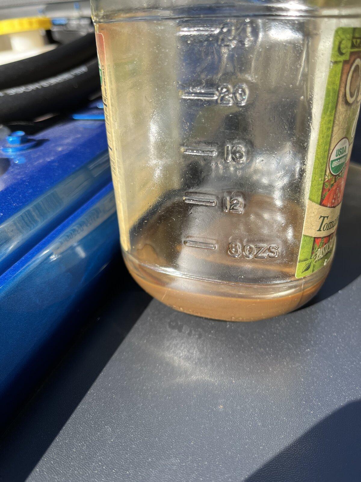

Cheap simple cans in a bad location fill with more tan starbucks crap than oil. If it is catching and holding oil it will look exactly like what comes out of the pan. Period. If it looks tan or like starbucks its mostly water emulsification.

I've read a lot of pro articles including from vendors and seen and studied the results. I do not gave one but have done weeks of research and compared photo results and looked into the various color meanings. Unless it looks exactly like the oil in your crankcase it's a lot of water not so much oil and it's condensation ofter from cheap cans that heat and cool. According to one vendor location can matter in that.

Mac
Nov 30, 2017
2,178
2,378
MA
2020 JT Hydro Blue Max Tow
Cold weather is back, more moisture content.
