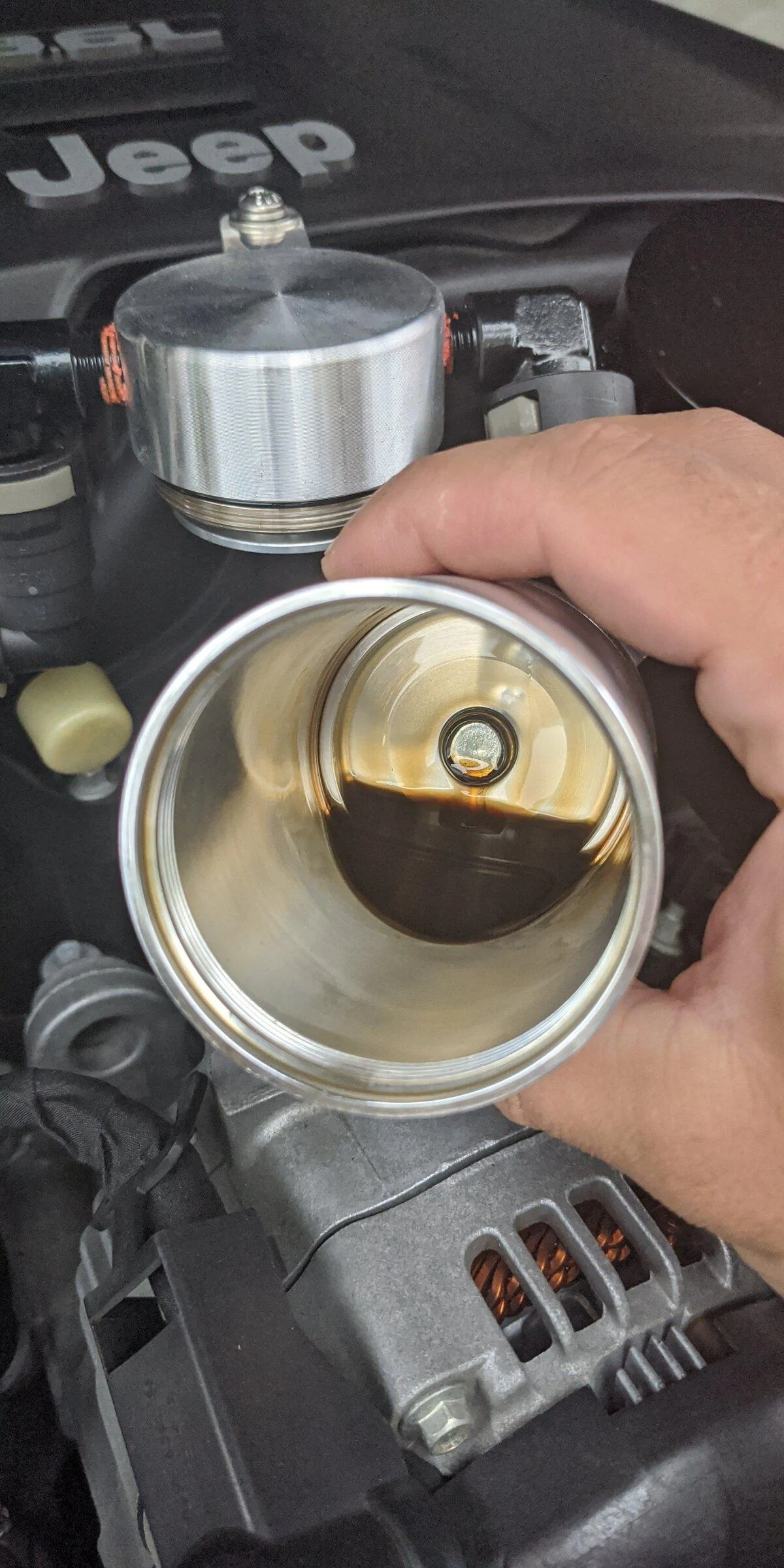

Been running this for about 5 months. I’ve emptied it 3 times and it was full every time. Looks like a chocolate milkshake. Thought they were hype, but sold in how much gunk comes out.
https://www.corsaperformance.com/co...-can-cc0002-jeep-wrangler-jl-jlu-gladiator-jt
If it doesn't look like pure oil then a lot of it was water, condensation.
The prior picture is a perfect example of one doing the job and not filling with what looks like a $5 cup from Starbucks.

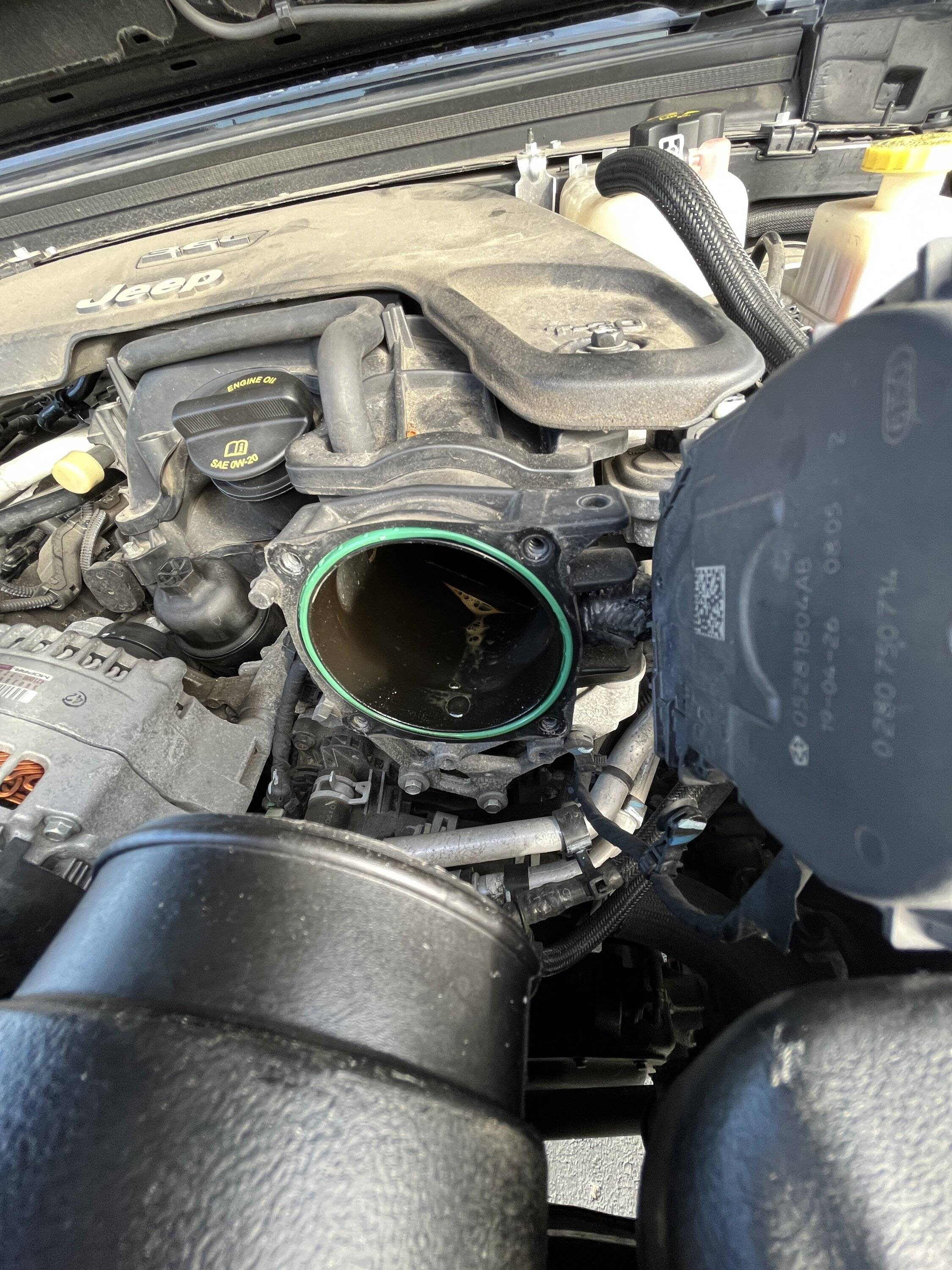

im considering the mishimoto can and wanted some thoughts.
2020 sport s with 83,000 miles. I tow pretty often through my 8-9 month camping season and drive 80ish miles for work. %90 highway driving where i always use the cruise control and (believe it or not) do 65mph the whole highway.
I recently did the math and unless I win the lottery this Jt has to last me until it’s around 160,000 miles. I keep regular maintenance intervals and follow the recommended services as they come up by miles.

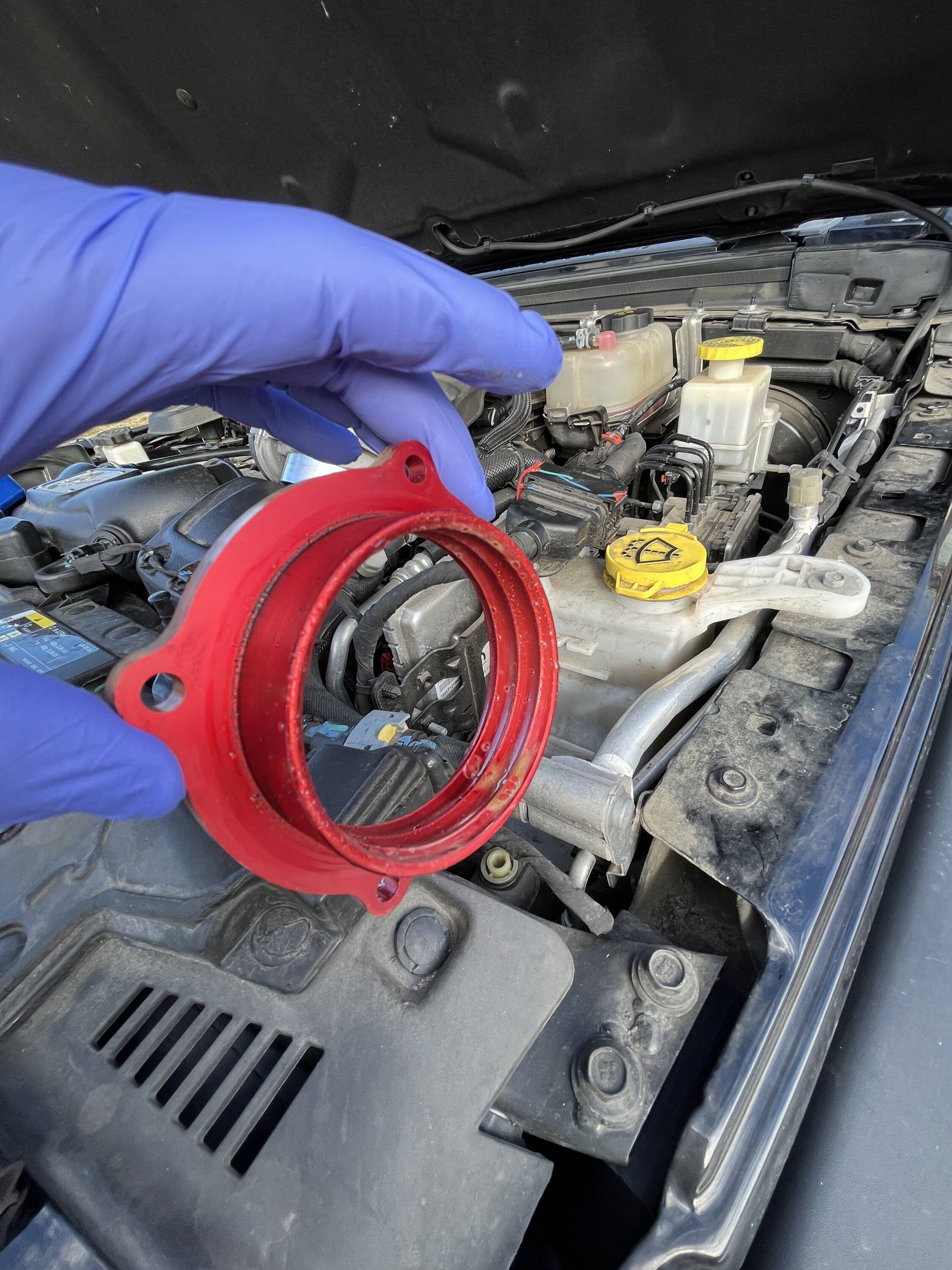

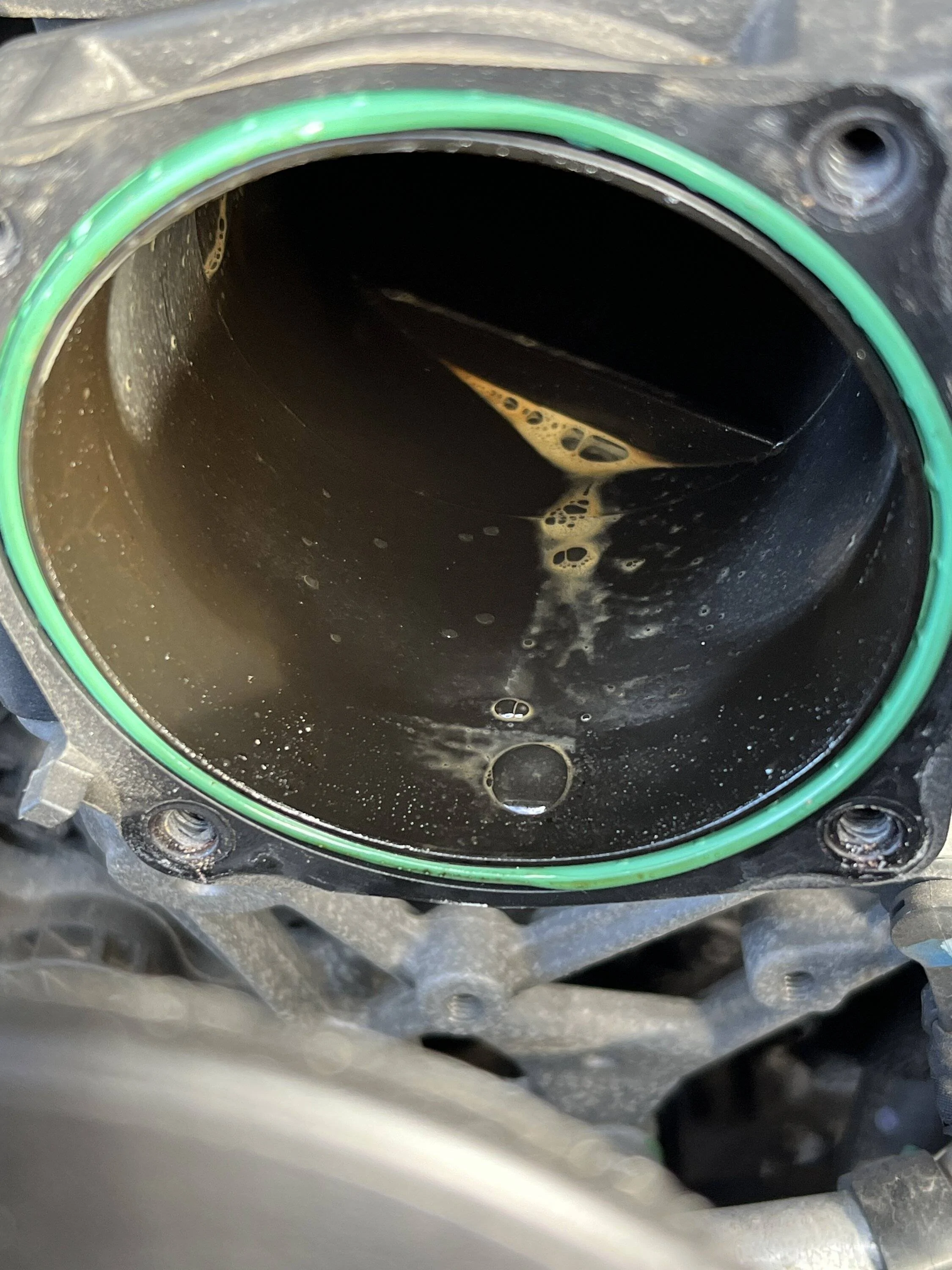

while swapping out a throttle body spacer I saw the coffee liquid pictured below. Never seen this before in my JT, but to be fair im not in the intake manifold often (really im never in there). Out of curiosity I pulled my wife’s 18’ JLU intake and hers was bone dry (what ever the opposite of gigity is).
so this got me wondering if its worth it to put in a can to pull the excess moisture out of the system before it maybe causes an issue. Or, if nothing else, have a meaningful way to measure and document it for my dealer to possibly address before my 100,000 miles warranty runs out.
i did just have my spark plugs replaced by the dealership as a scheduled maintenance, so perhaps the coffee is s remnant of something to do with that process.

That looks like water mixed with gas fumes. Condensation.
I checked the oil on mine today - gets oil change tomorrow.
6,000 miles on this oil and it still reads all but full. Can't be pulling in any oil and still reading full.
My 2020 was the same way - read fine between changes.
If it's drawing in oil via the PCV - it would out of necessity have to read lower after thousands of miles.
32 ounces in a quart.
I'm not going to spend money on one. Not when the oil level doesn't drop. If oil leaves the crank case to go anywhere at all, then the level must read lower. Mine doesn't, so it isn't.
