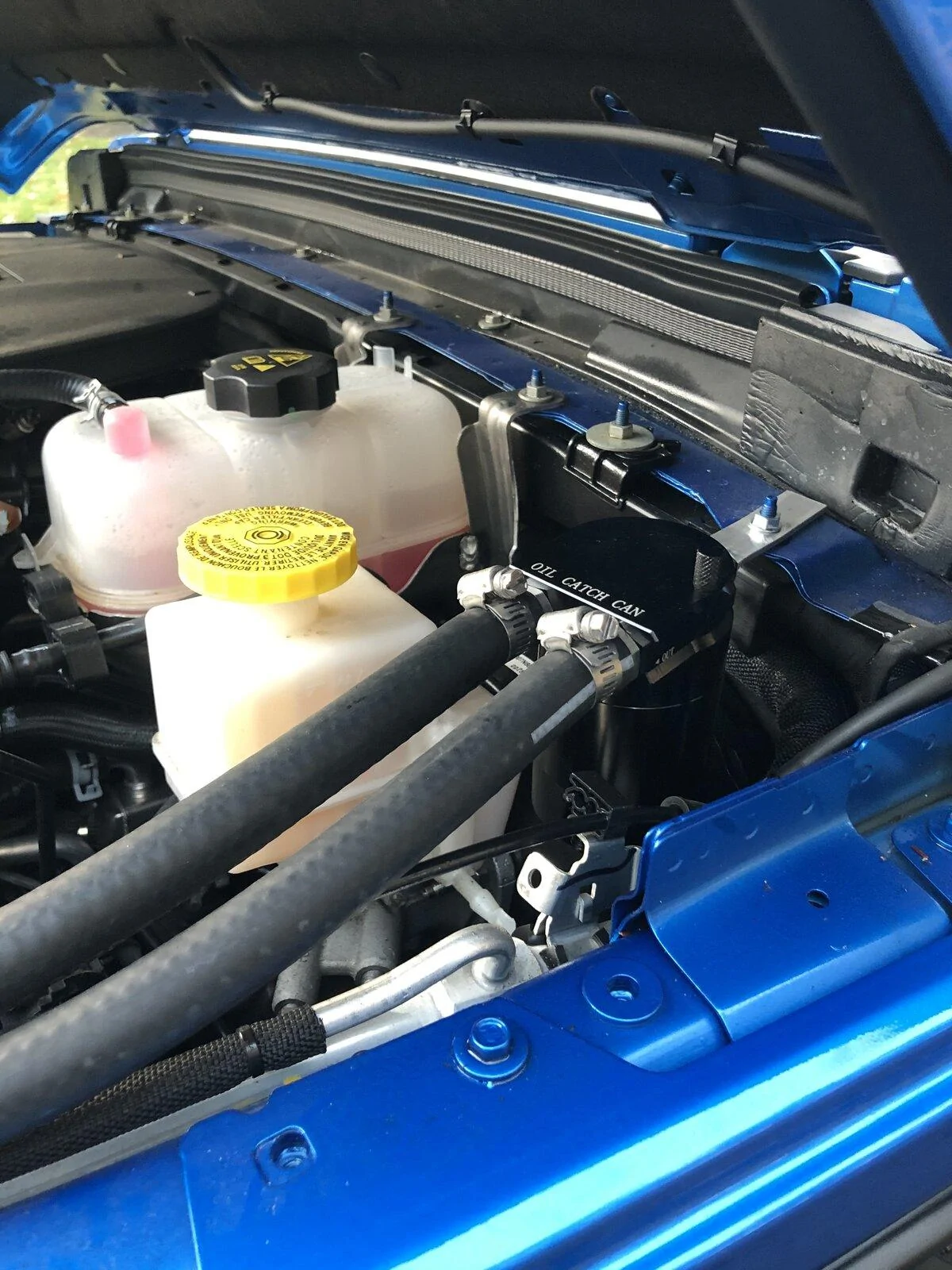

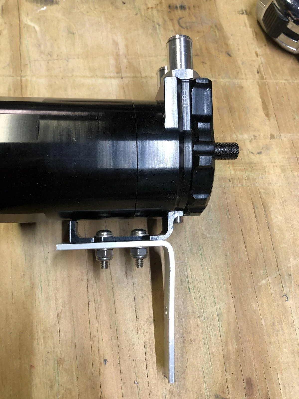

Interesting, my cheap catch can is milled from what appears to be solid aluminum, the body and lid are at least .25” thick, mine was universal so I made a mount for it, as it turns out mine is very close in location to where the JLT can mounts. Definitely something to the heat and condensation as the contents has the milkshake appearance in the colder months but not in the summer.

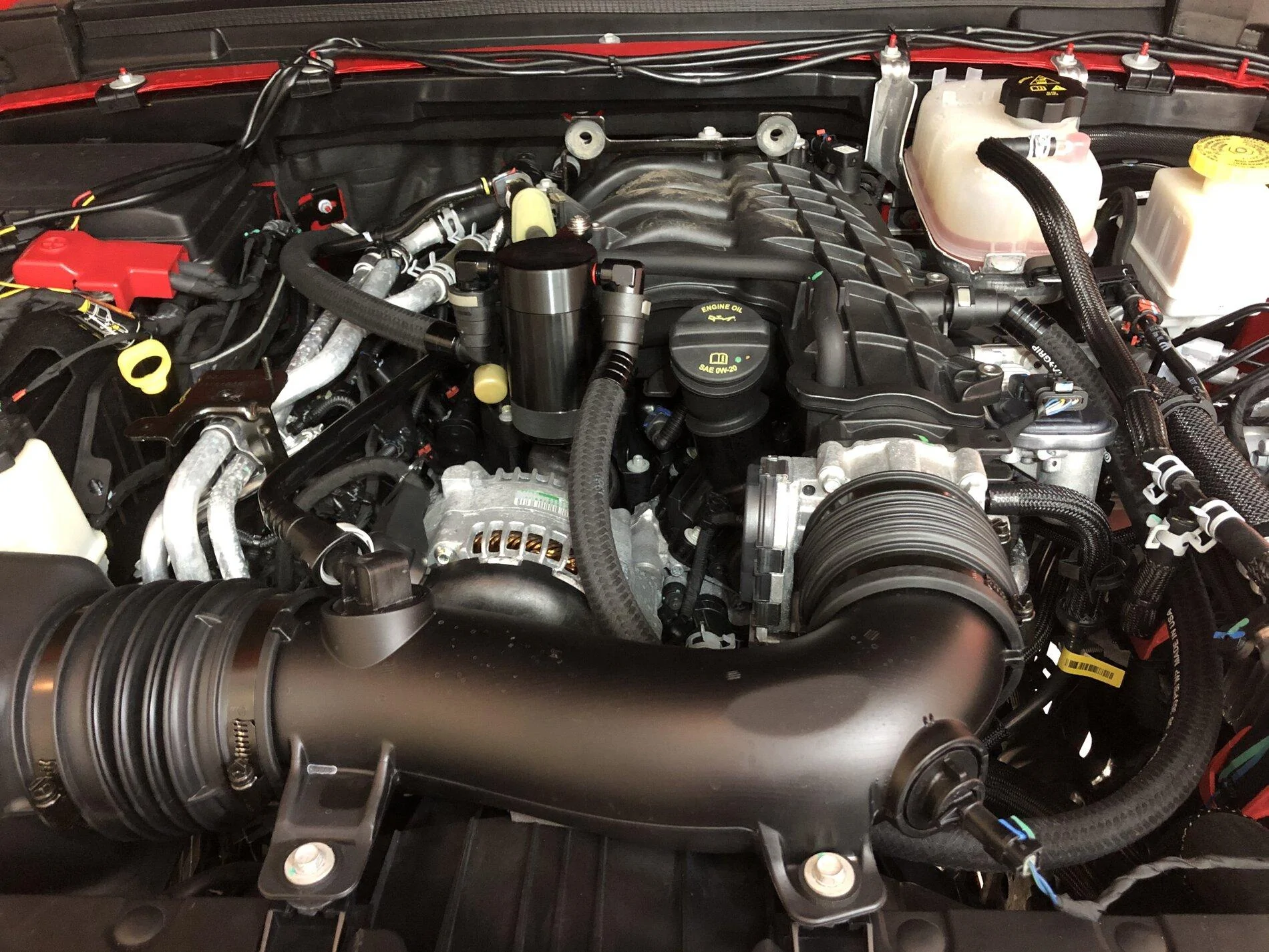

For you guys running the UPR can, do you still like it? Is much getting by it on the clean side at the intake manifold? Thinking about removing my mishimoto and installing a UPR
Jeepin' John
May 6, 2020
373
936
Raleigh, NC
'20 JT Sport S
Structural Engineer
Well, out with the mishimoto, in with the upr!
Also ordered the teraflex CVS and will connect to the upr (they're installed literally right next to each other) but awaiting delivery on that. I'll see how the upr compares to the mishimoto for a few hundred miles before teraflex cvs installation. But ultimately, the idea is to have the teraflex cvs pull more air from the oil filler neck than the back of the valve cover, reducing the amount of oil in the pcv line, and the upr cleaning up the rest. I want no oil in the intake manifold!

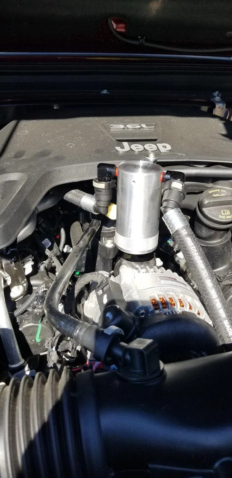

unsocbl
James
Aug 8, 2020
439
861
Charlotte TN
2021 Gladiator Willys Eco-diesel
Just installed the UPR a couple of days ago. We'll see in a few days how much oil it's catching
