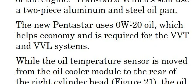

We've both been saying this in almost every oil thread, over and over, but it never takes. A Youtube comes along and "but...but...but...but.... GM, or what about this!" and facts be damned.
Ok, I've lost track, but here's just one of the snippets (of the pages of changes made to the PUG 3.6 vs. the first generation)
Jeep Gladiator Oil - going from 0w20 to 0w40 1749135645689-o
(and again, API works with manufacturers to make oil for their engines, manufacturers don't build an engine and then go to Walmart and shop for something that might work. They are engineered to work together)
