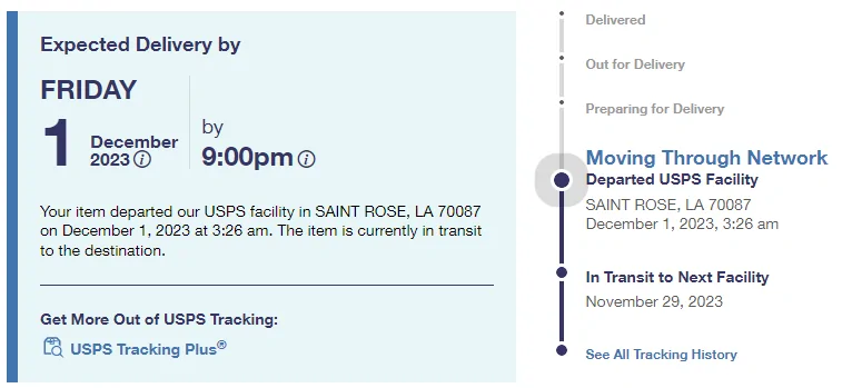

My lights were supposed to arrive today, but still shows them in the LA twilight zone

Not uncommon. Just means it's still in transit but looks like it will be late. Also, it's holiday season so things may take longer than usual.

Oh I'm sure, but why quote a date if the item hasn't shipped
