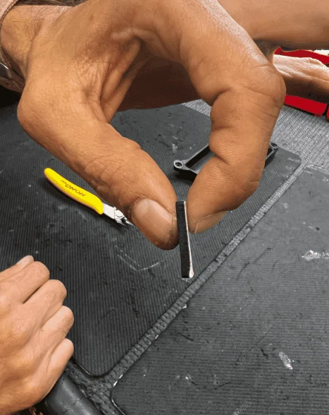

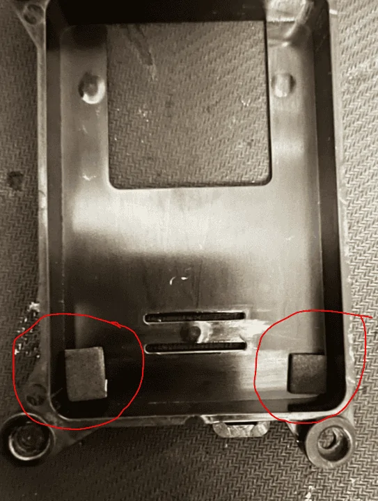

Including the complete instructions and photos here:
If your Jeep is lifted and/or has large wheels, the BSM may only be picking up tall vehicles (trucks, 18-wheelers, etc). If this is the case, some 3mm thickness foam tape may need to be added to shim inside the sensor cavity to aim the sensors further downward. Vertical adjustment would only be necessary on vehicles where the sensor is greater than 1 meter distance from the ground.
Once you've added the first set of 3M foam shims, go for a test drive. If the BSM is still not picking up properly then they need to add more 3M Foam

Hey Terry. Digging up an old post, since I am about to install the taillights I just ordered from you. In looking at the picture you provided above, you stuck the 3M foam tape on the bottom of the sensor mount. To me, it looks like this would actually angle the sensor upward and not downward. Shouldn't the sensor rake downward a bit if we are installing it on a lifted JT???
Thanks.

Contrary to how it seems, the 3M on the bottom will actually aim the sensor at a very slight angle. It pushes the sensor bottom slightly away from the sncosure with the top manning its location. This would set that "downward" angle.
