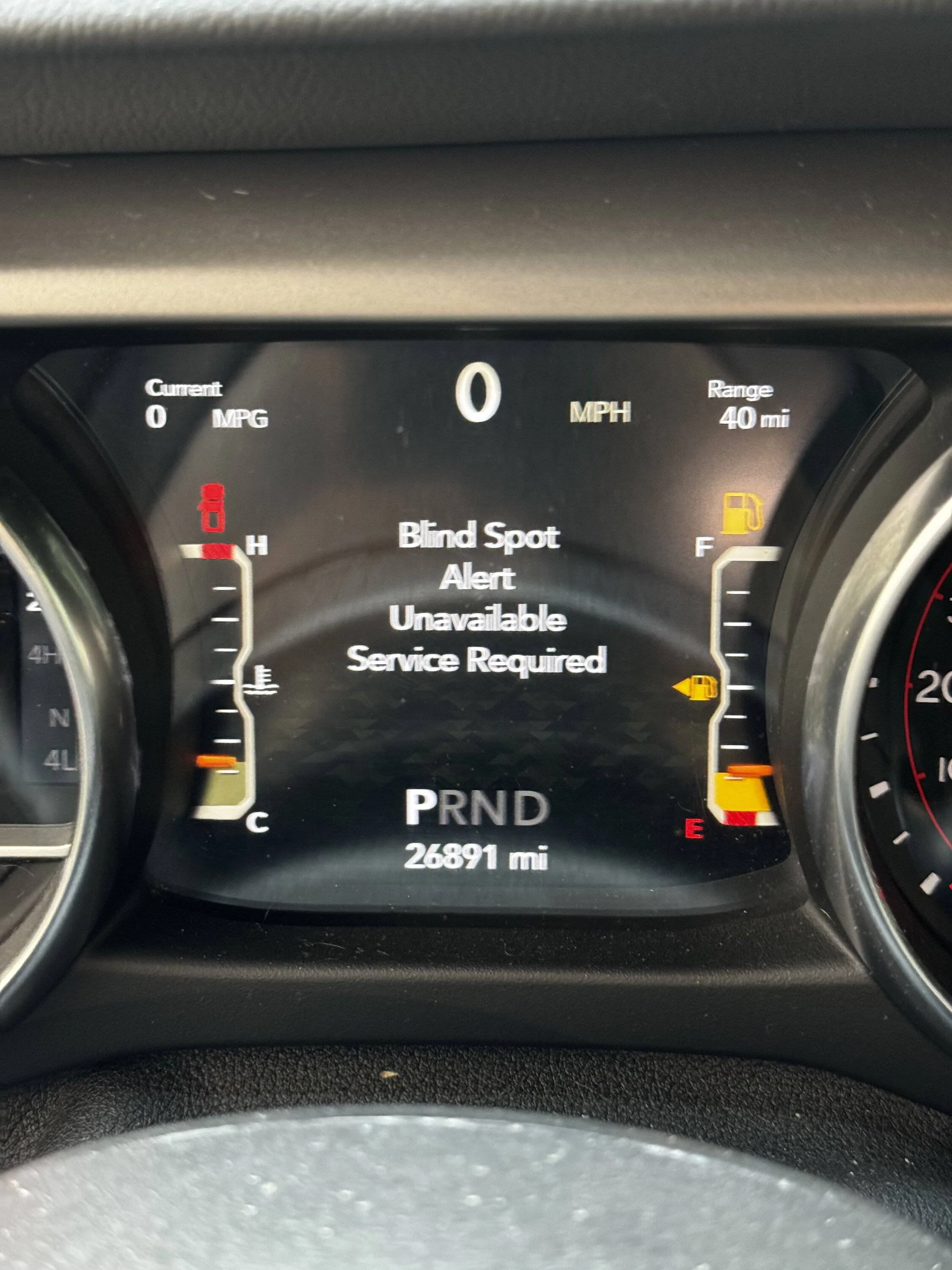

Installed the flush mount lights, and now my Blindspot system is not working. Connected and reconnected everything multiple times and no go.
Reached out to customer service and they sent me an email with links that are dead and pictures that don’t work. This was supposed to help me determine whether Oracle wired the lights correctly, and if not, instructions on how to remedy that myself. After several follow-ups to receive a new email, I haven’t heard back.
I was able to piece things together using pictures online to double check the wiring of the fourth and fifth wire on the driver side light and all is wired correctly. Still having the issue. Super frustrating.
I have two other Oracle products, and was hoping this would be a good one too.

Hi, If your Jeep is lifted and/or has large wheels, the BSM may only be picking up tall vehicles (trucks, 18-wheelers, etc). If this is the case, some 3mm thickness foam tape may need to be added to shim inside the sensor cavity to aim the sensors further downward. Vertical adjustment would only be necessary on vehicles where the sensor is greater than 1 meter distance from the ground.

Did this, did not work. Still receiving error. Very very frustrating.
Jeep Gladiator Oracle Flush Mount Tail Lights Issues IMG_1006

Does the harness connector only connect one way? Is it worth checking to see if you need to flip the oracle sensor harness to the vehicle harness?

Only connects one way. There are two harnesses - one to the car and one to the sensor. I’ve checked and rechecked. ?
