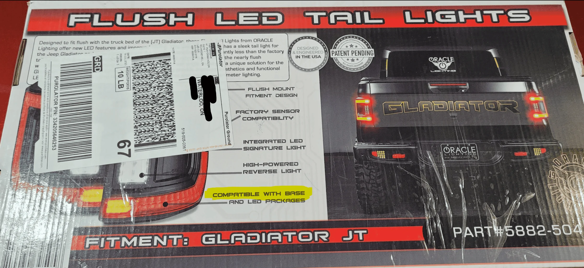

The cover of the box they come in reads, as a highlight, "compatible with base and led packages"
The box does not say you need a jscan, tazer, resistors, etc.
Why on earth would one expect to buy or do anything extra for them to function?
I filled out their service help form. We'll see what they say. If they dont work without some song and dance then they will be rturned.
Understand. I went off what their website said. I never looked at the box.
