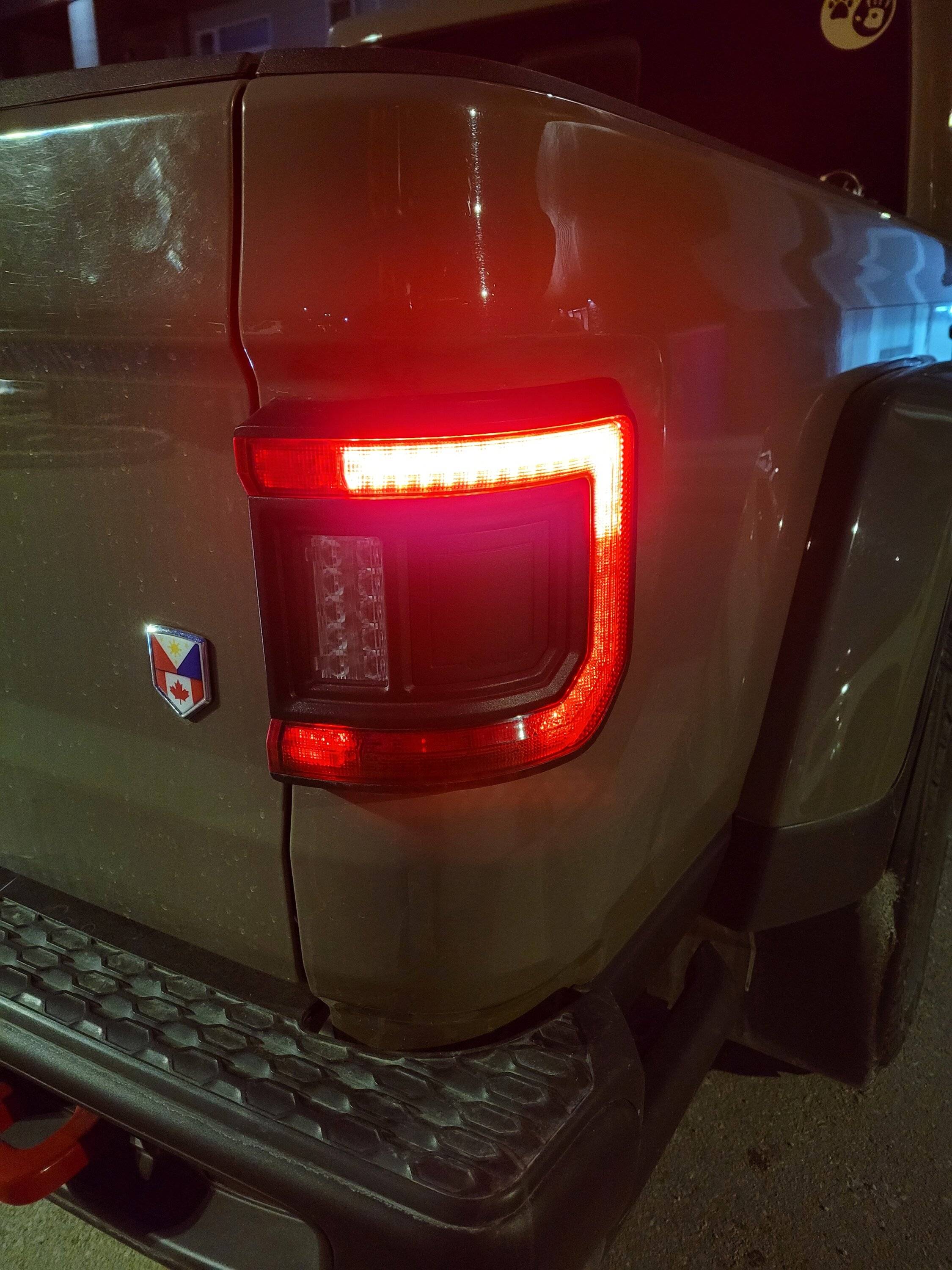

I've had the Oracle LEDs on my 2020 JTR for just over a year. Passenger side tail light flickers and some of the LED lights do not work. Is this fixable or are they just junk now?

With these lights it seems that one man’s junk is another man’s treasure… hmm, or maybe it’s the other way around.
fill out the warranty form. I got a replacement covered even though I was out of warranty.
Hello! You can start a claim here and a representative will be with you in 24-48 hours.
