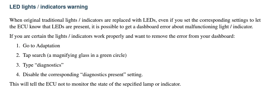

JSCAN works 100%. It's just not as straight forward as setting the rears to LED for the signal out error message. Here's the instruction from JSCAN Support on what to do:
Jeep Gladiator Oracle Flush Mount Tail Lights Issues JSCAN
To add to this instruction - We found that if you don't go in and clear all DTC beforehand, the error may still occur. So, make sure you're doing that also.
Now, with that being said, resolving any bus related issues such as reverse lamps or park lamps shutting down on Halogen equipped rigs, simply setting the rear lights to LED DOES resolve that.

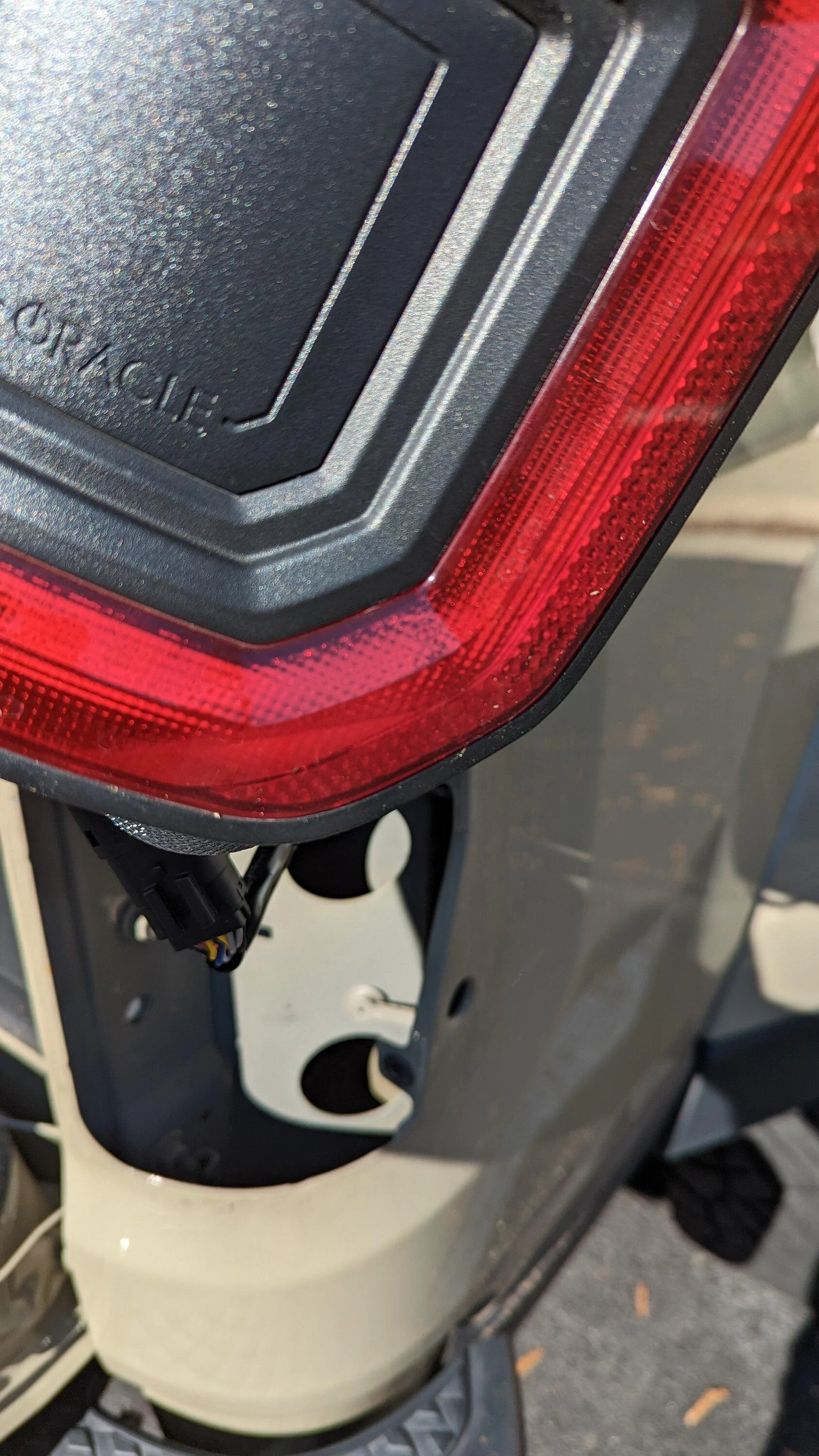

I received my lights last Christmas as a gift in January (they were late arriving). I installed them in my LED equipped Gladiator and then waited on the cable fix. The fix was working great, but now I am getting intermittent "Rear signal out" errors and I noticed this evening that the bottom lights on my right side tail light are out.
Has anyone else seen this? What is the fix this time?
I'm hoping it is a warranty issue.

This is what my lights are doing.

I was able to confirm that water was able to infiltrate the light housing. @JP_Oracle I filled out the RMA form on the Oracle Lighting website. Is there anything else that I should do at this point?
PM me your email and order details and I will make sure Customer Support gets this handled for you promptly!
