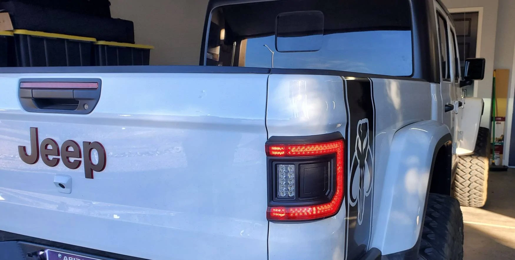

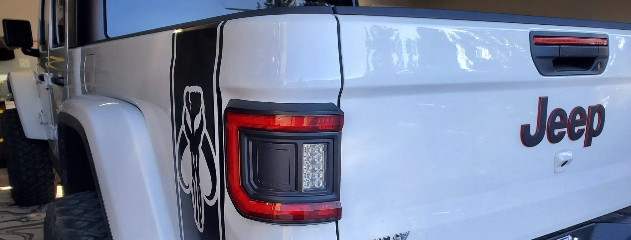

Unfortunately, I appear to have the situation others are having with one faulty taillight. My driver side taillight and brake light are out, but the reverse light appears to work fine. Factory LED package. I swapped in my factory LED taillight, and everything works fine. Reconnected the Oracle taillight and the issue persists. I've had them for about 15 months but for well under 5k miles. No extreme trails or anything that would have caused an issue. Surely, they should hold up better than this.
I sent in a tech request/warranty request and was asked for my purchase receipt. That was a couple of days ago. Nothing back yet but hoping to hear something soon.

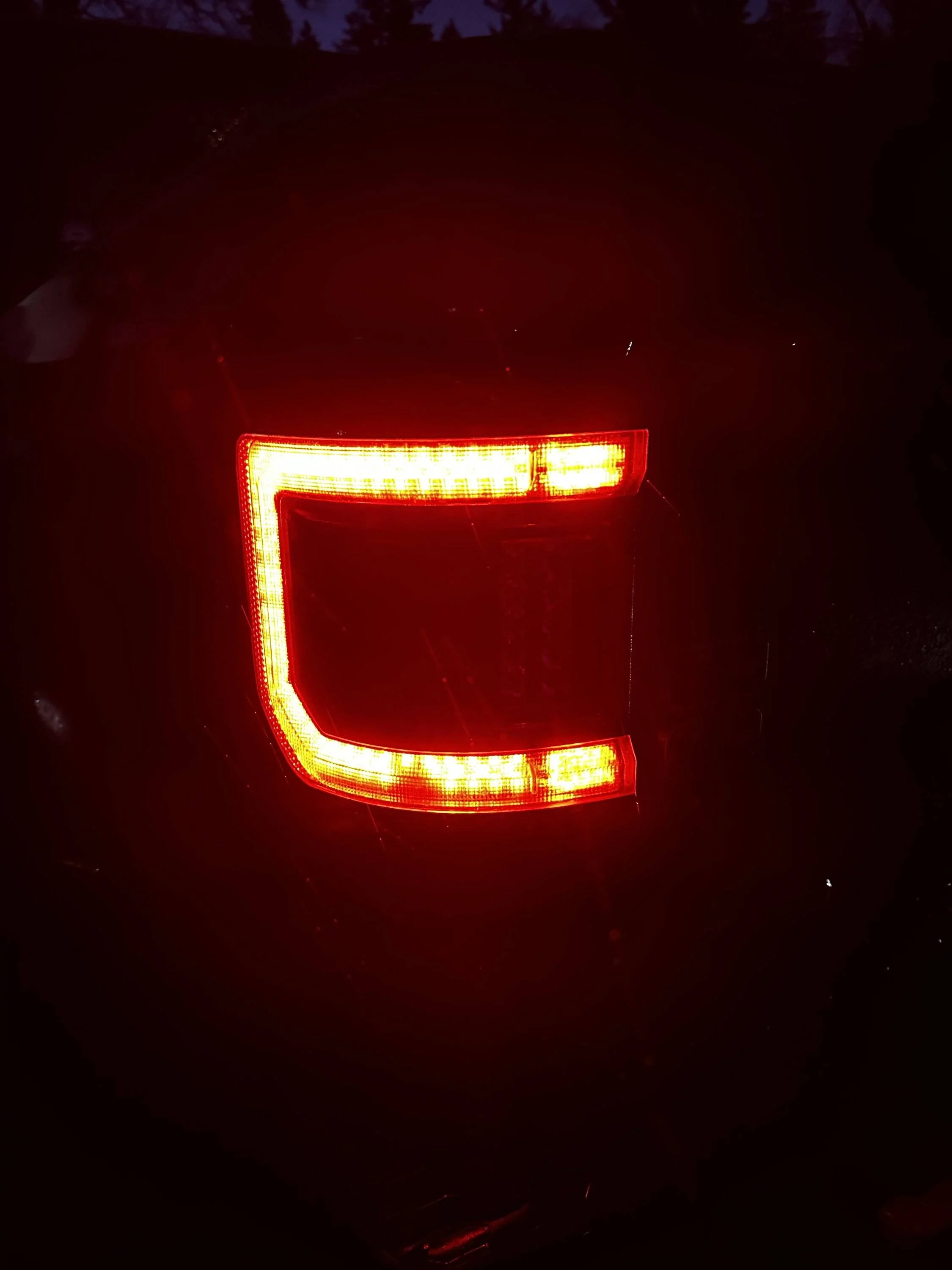

Maybe Oracle can sort mine out as well. Purchased March of last year, LED’s are dying, just like the last set. Moisture seems to be the problem once again. Can you help?

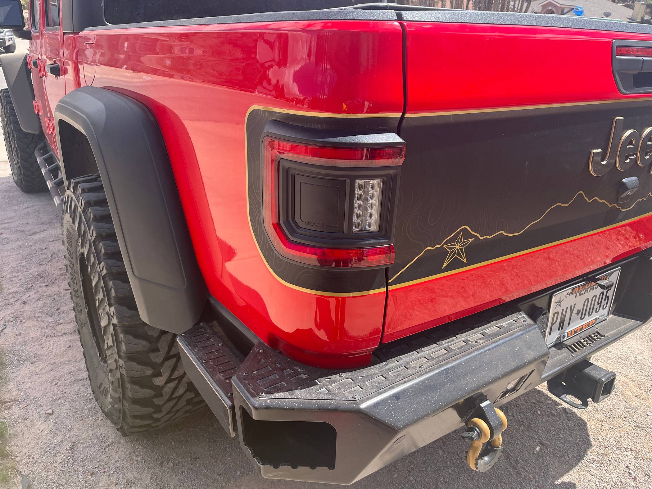

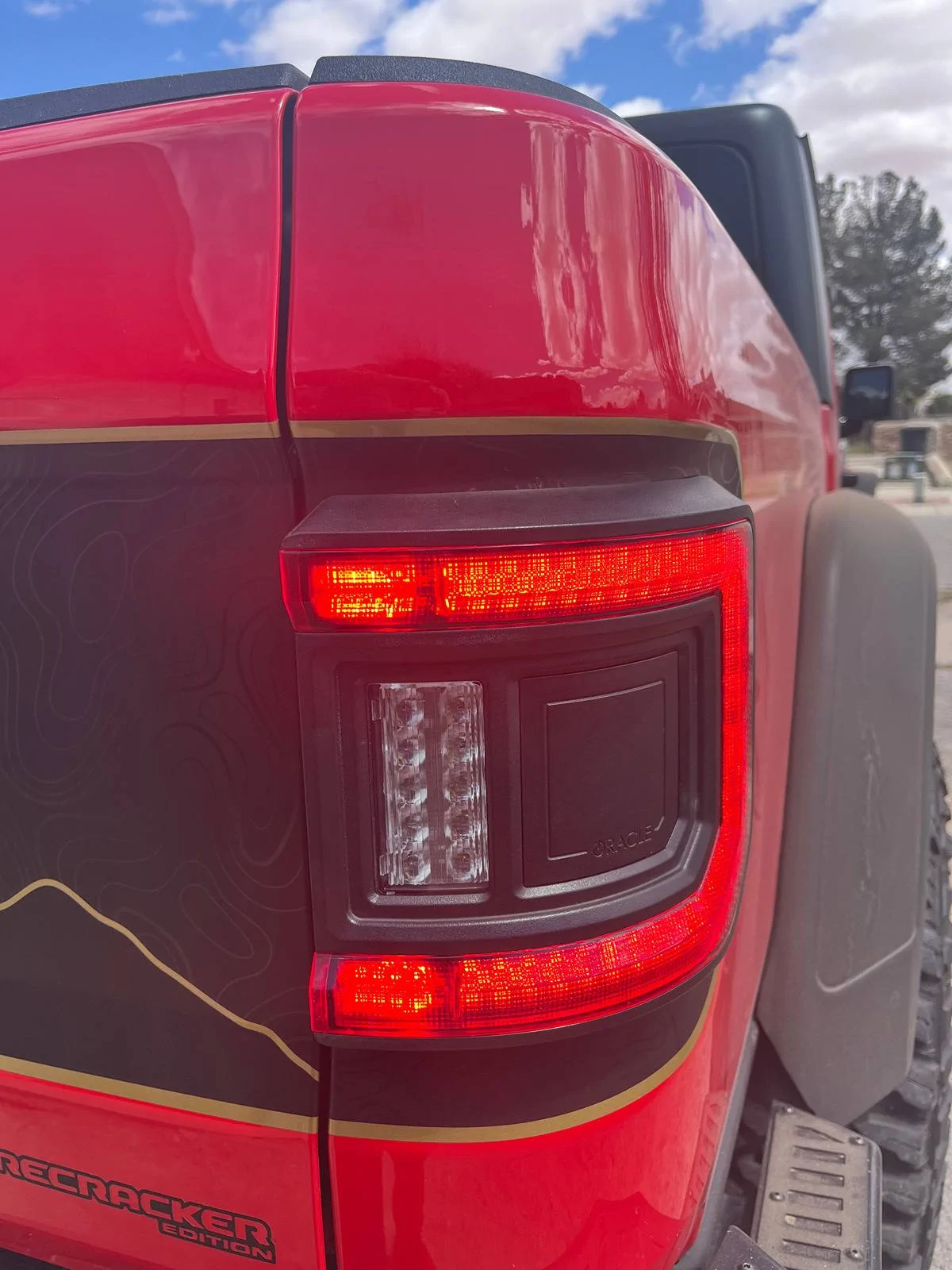

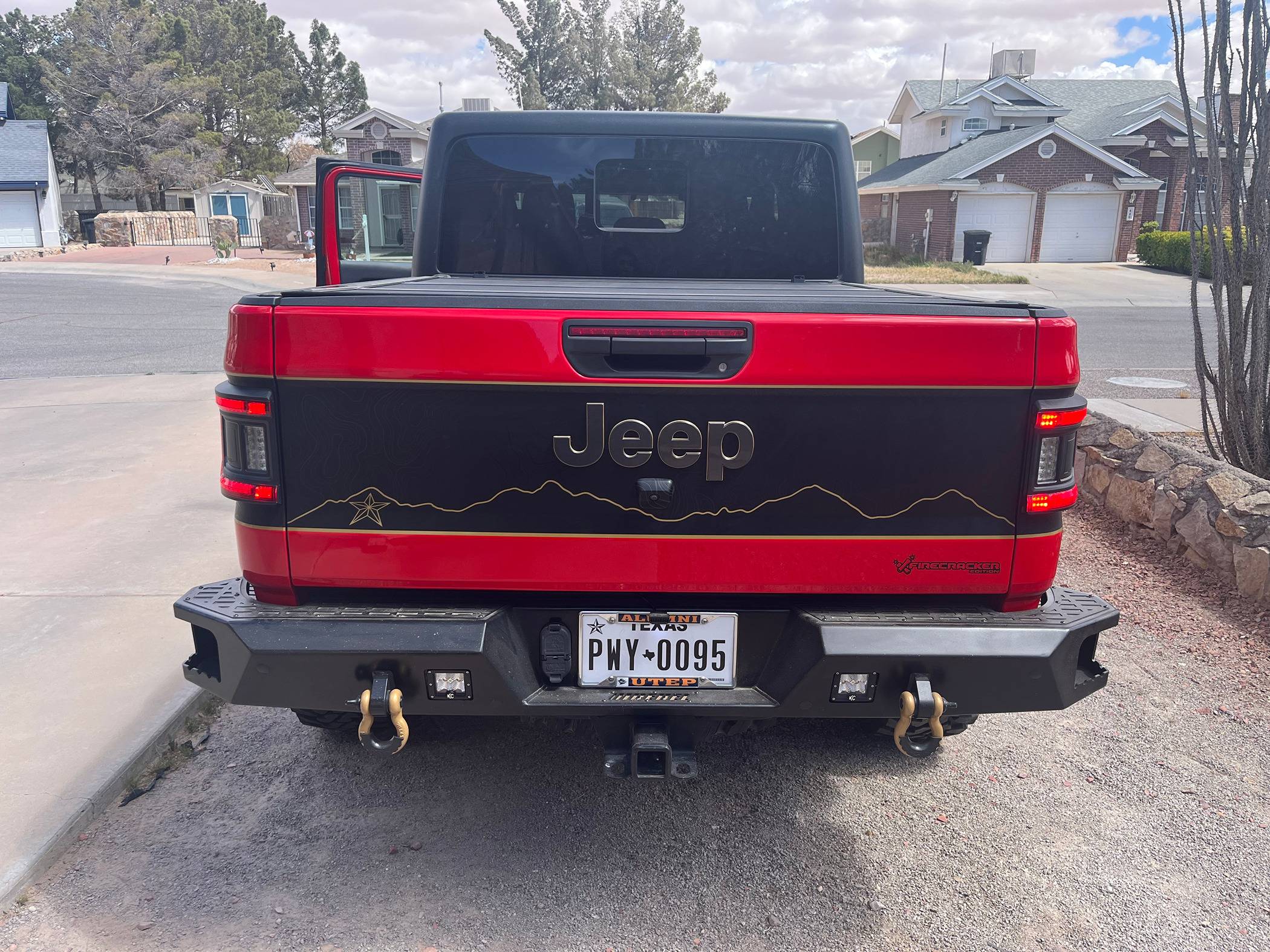

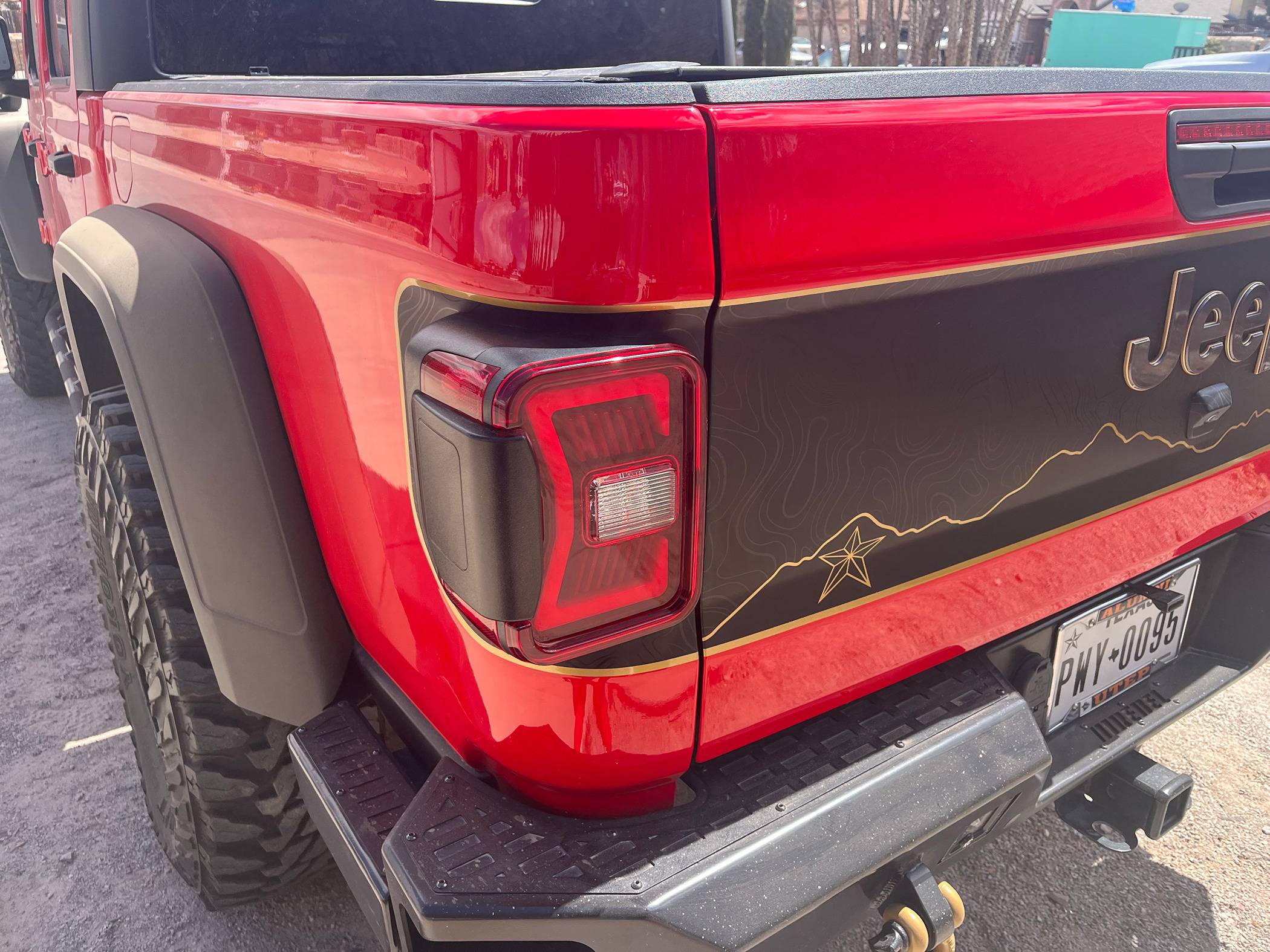

Add me to the list. (Copy pasted from another thread)
Pretty disappointed, I was hoping the teething issues had been sorted by now.
I picked up a brand new set to swap in because I kept hitting my current taillights with my knee every time I used the corner step on the bumper.
They're replacing a set of ebay special no name brand (WinJet?) LED taillights that have worked flawlessly for the last 2 years, fit perfectly, had sequential signals, and ran me $200 bucks. And they looked good!
Well, they solved my clearance issue with climbing in the bed, but they've got problems.

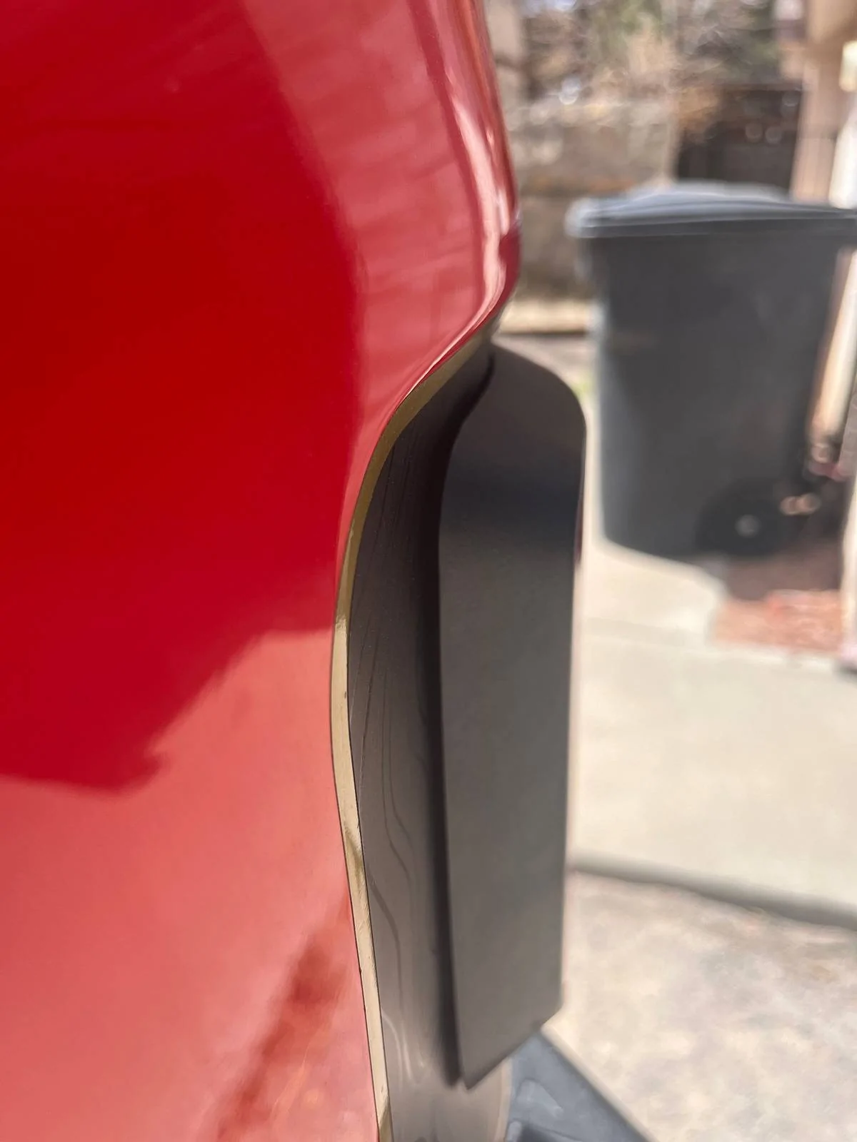

Right out of the box, the fitment is off, driver side taillight sits almost a quarter inch off the body. Tried holding the taillight with my hand, adjusting the rubber grommet, and still no luck. The only saving grace is that my tailgate wrap helps hide it. For $400 bucks, I was kind of hoping that they would fit just as well as my other aftermarket lights.
Also, it looks like they might not be lighting up properly! One side is noticeably dimmer than the other.
Ironically enough, the driver-side running dim might be safer, it's hard to tell when the passenger-side turn signal is on.
But I think my driver side light is a dud.
