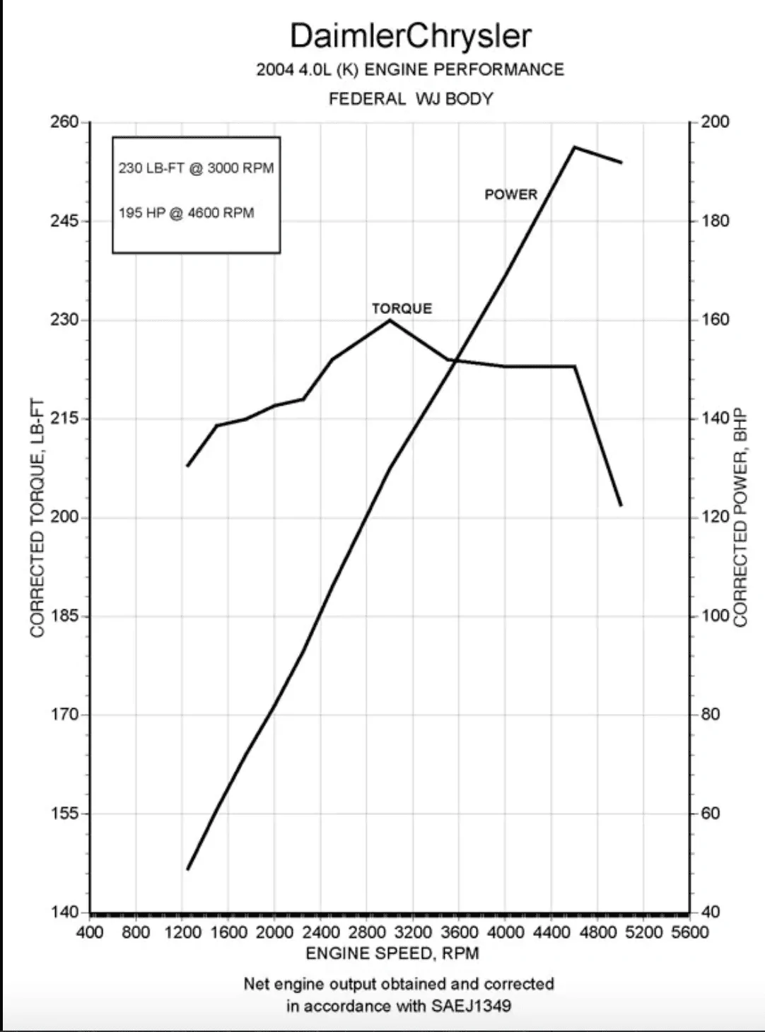

I'm afraid there's nothing easy. The Pentastar is not underpowered and already makes more HP and TQ at low RPM, than any Jeep 6-cyl before it. I love the jeep 4.0, but it was a turd --it's just that our memories are short and everything made today has so much power we've lost grip with reality.
We also have an abundance of auto-journalist and social media influencers telling us baselessly that the pentastar lacks power. Automatic Jeep Wranglers and Cherokees from the 4.0 era are dawgs. The manuals are too, but their meager torque built quickly and their affective gearing was lower so when the power did hit, it felt good.
It's a natural law, no amount of power will ever be good enough. We always find a way to want more.
Check out these dyno-graphs I quickly pilfered from an internet search --credit to the original creators. Note the Mopar example is power measured at the ENGINE not the wheels. This is a somber reality check.
Jeep Gladiator Pentastar power increase Screen Shot 2023-12-03 at 7.51.02 AM
Jeep Gladiator Pentastar power increase Screen Shot 2023-12-03 at 7.56.19 AM
